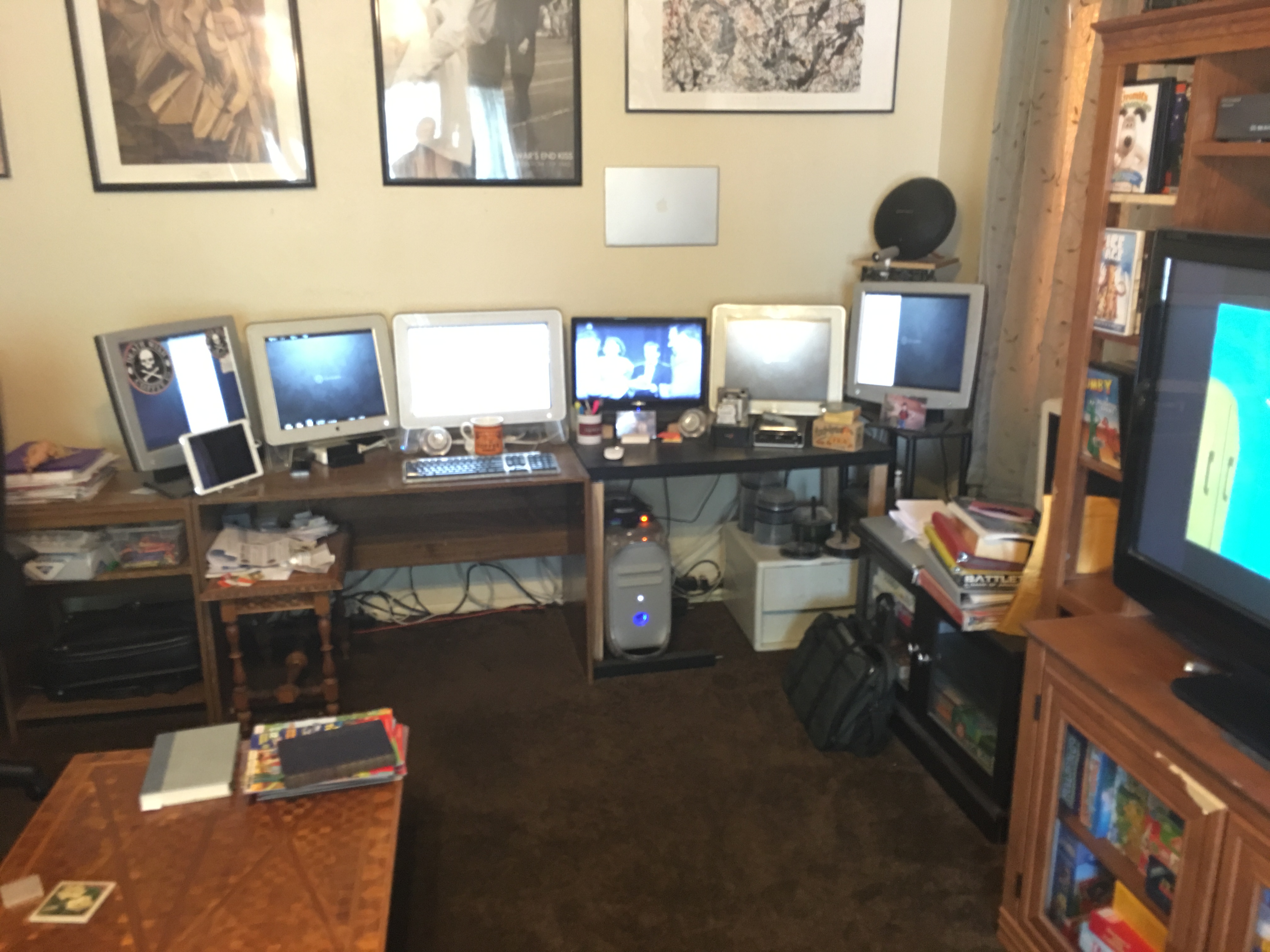

I use mine for graphic design, email, web browsing and word processing.
There are things you can do to improve performance…
You can put an airport card in it, upgrade the ram, maybe go nuts and get a CPU upgrade and GPU upgrade for it. I have a couple of motherboards for two of my PowerBooks coming in today so I can upgrade them.

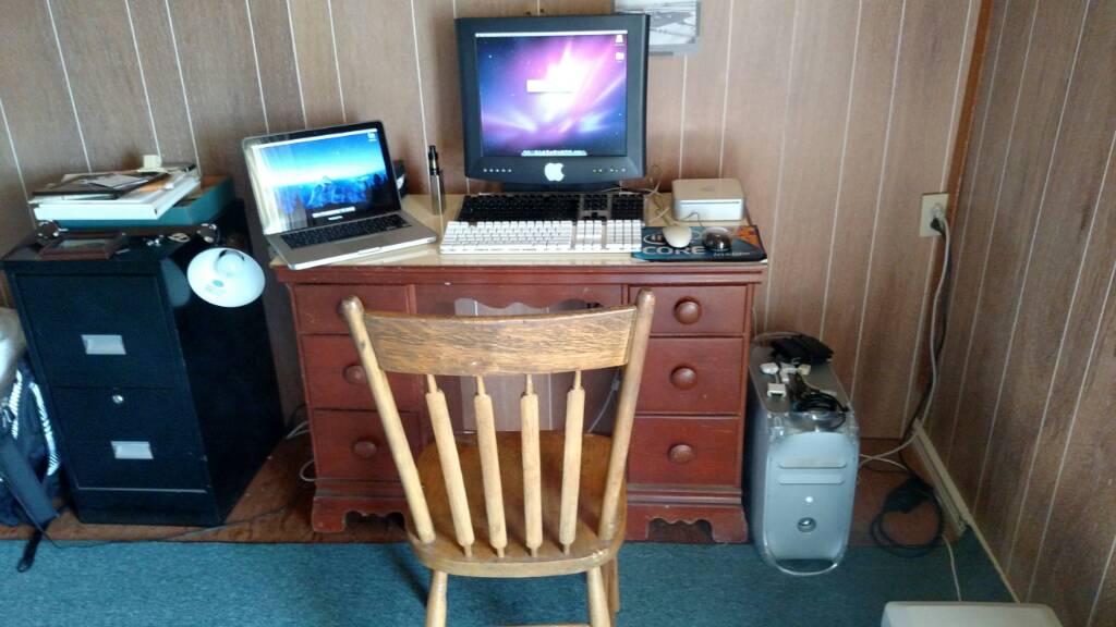

I decided to get a dual 1.25Ghz board and swap it with the 867Mhz board. I was using that machine with little to no issues from 2009-2011 as my main machine.
