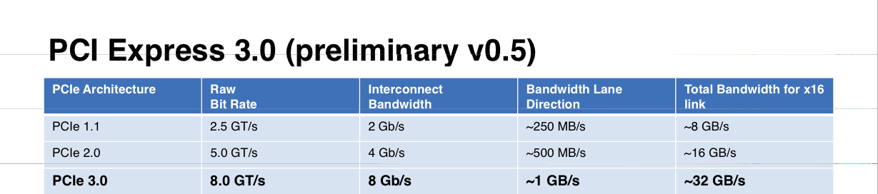

"PCI Express Base 2.0 specification doubles the interconnect bit rate from 2.5 GT/s to 5 GT/s in a seamless and compatible manner. The performance boost to 5 GT/s is by far the most important feature of the PCI Express 2.0 specifications. It effectively increases the aggregate bandwidth of a 16-lane link to approximately 16 GB/s."
PCI 2.0 Spec
PCI 3.0 Spec
TB 2.0 has 4 lanes at 10Gbits p/s, two in each direction which =20Gbits p/s in each direction. Using your math that's 40Gbits p/s.
It looks as if you are comparing multiple PCIe 3.0 slots aggregate bandwidth to TB 2.0.
I was suggesting one (1) TB 1.0 port to one (1) PCIe 2.0 slot.
When you step up to TB 2.0 and PCIe 3.0 each effectively doubles, then it is the same comparison.
You can see from the image they are quite close. Close enough, so that modules that included more PCIe 3.0 slots would have no performance degradation.
BTW AGP 8x is about 1Gbit p/s. Not even close to PCIe 1.0 spec. Not to mention it was quad pumped (every 4 cycles) and not double pumped (every two cycles)
Not necessarily. The increased Thunderbolt traffic is far closer to to making TB a "fat tree" kind of network where the box-to-box interconnect is faster than what the local on-ramp / off-ramp traffic is. Similar to how the Internet backbone is 10+ GbE and what goes into the average home is far closer to 10 MbE. The backbone is much faster because it aggregates traffic into larger workloads.
Not going to be anywhere near close. Largely because TB 2.0 isn't really moving forward. What they are doing is taking was was already there and multiplexing the traffic more. It is increased multiplexing, not increased throughput. PCI-e v3.0 is double speed of v2.0 ; a true increase on throughput.
