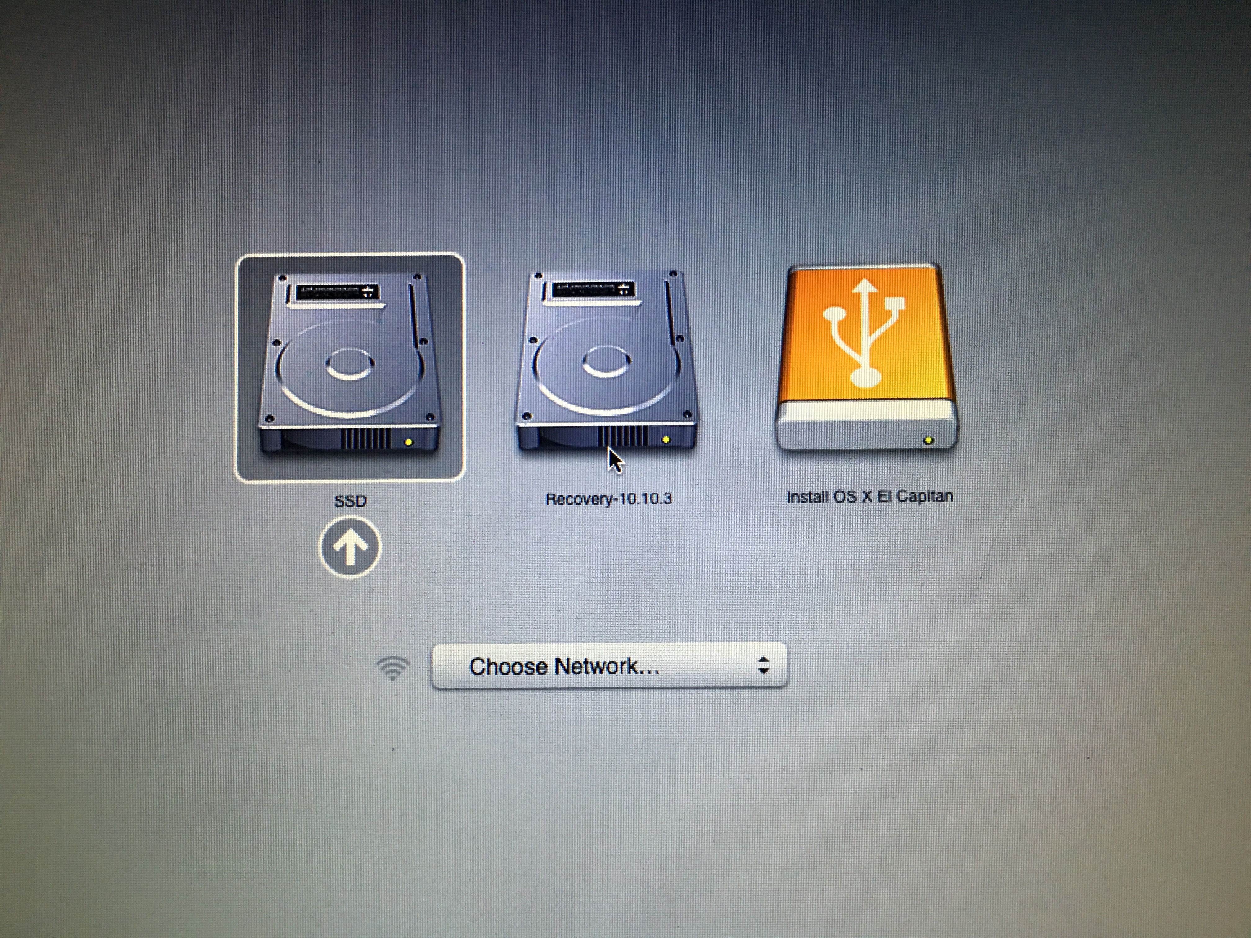

Didn't have a chance to work on this until last night. I downloaded the El Capitan installer and then created the Diskmaker boot USB. When the MacBook boots off of the USB, the following menu appears.
This is with the SSD still installed. Since I used Carbon Copy Cloner to copy the data to the SSD, the HDD presumably has this item, too.
Does the presence of the "Recovery-10.10.3" indicate that (after re-inserting the HDD) I could boot off of the recovery item ... and use that to wipe the other part of the drive and then to install the OS?
Yes but it would have to download the OS again - the Recovery Partition doesn't contain an installer file.
