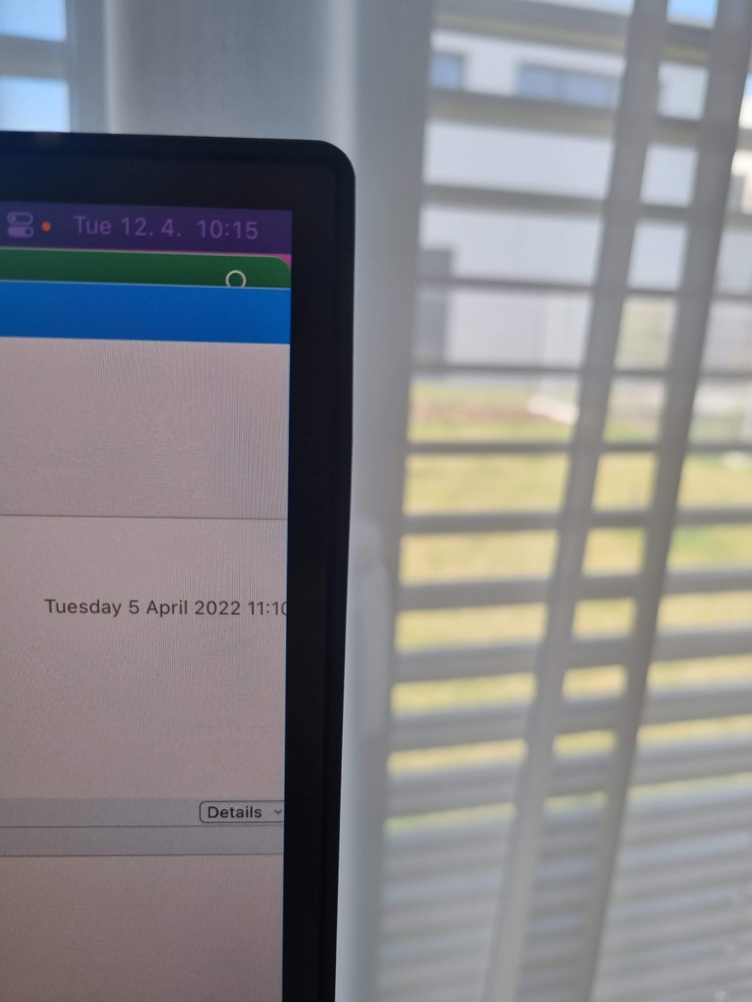

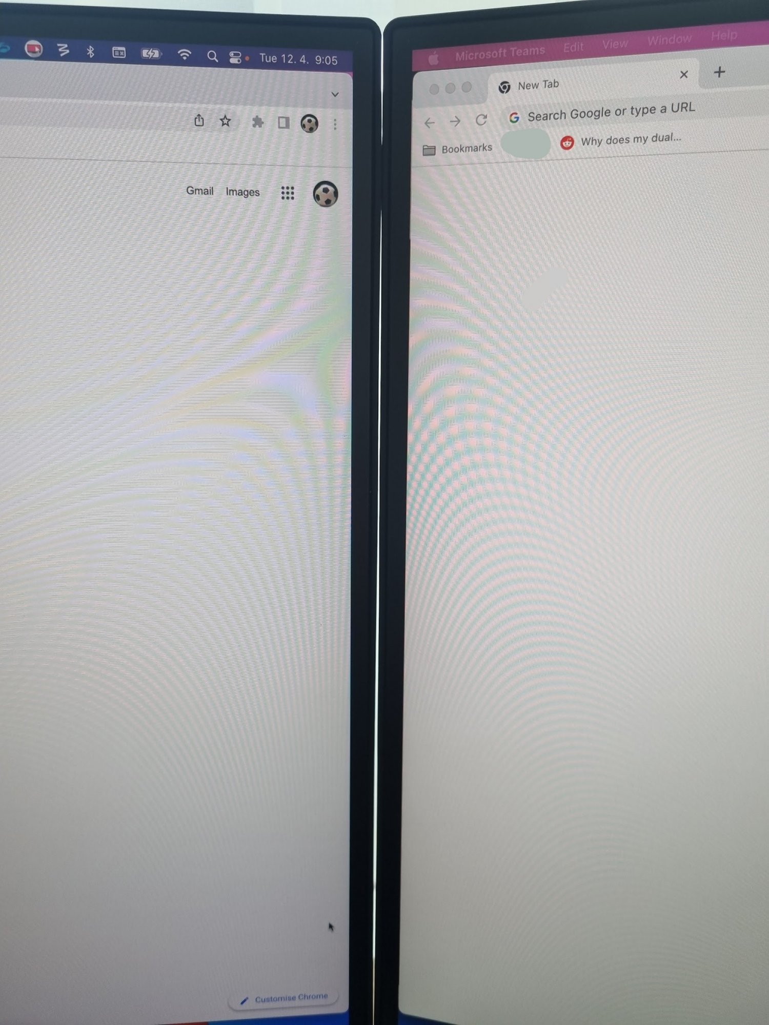

Well currently I'm trying to address another stupid thing with this monitor. Got 3 monitors for my home office and all of them on the top right corner (an inch or 2 below the corner actually) have in the same place a bigger gap between the plastic housing and screen. So when I put these monitors beside each other, there is always a gap, looks pretty ugly. Weird that all of them have the same gap in the same place. Have you noticed this?

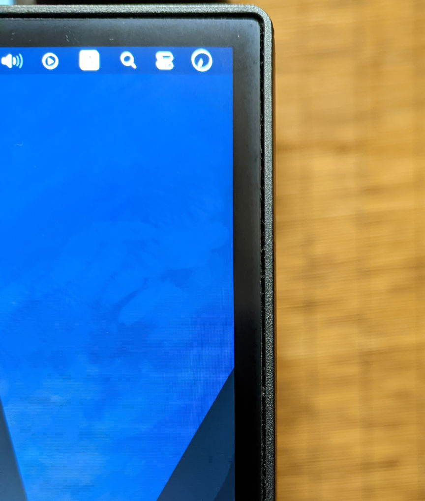

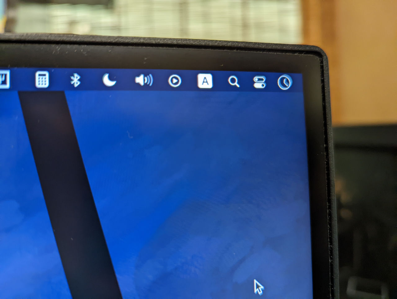

Sorry for dusty pic but mine is looks okay to me.
thx, your's seems ok eventhough mine on the photo doesn't look that bad either, I would be fine with it if I didn't have multiple monitors beside each other

I have 3 monitors and checked another 2 in LG store, same story, all of them made in China with different dates. I have even one ordered from Amazon from another country and it has the same issue. I guess I'll try to find an alternative, a pitty as I really like the monitor a lot but looks like they droped the ball on QC.
