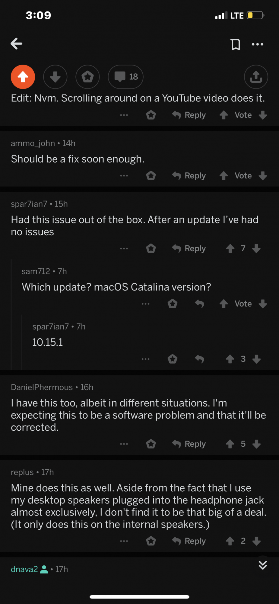

This user says an update resolved the issue for them
Reactions: Sanpete
