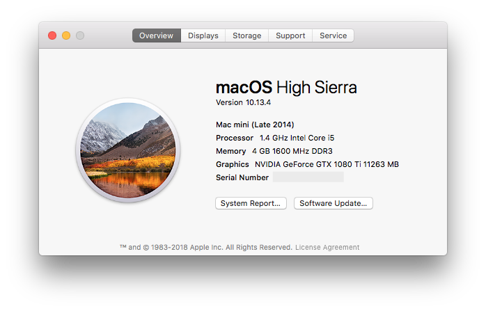

I started with an Akitio Thunder2, external Power Supply and a GTX980Ti in conjunction with a 2015 5K iMac with dedicated M395x internal gpu.
I used it for home and work and was a nice setup but I was wanting a more compact design.

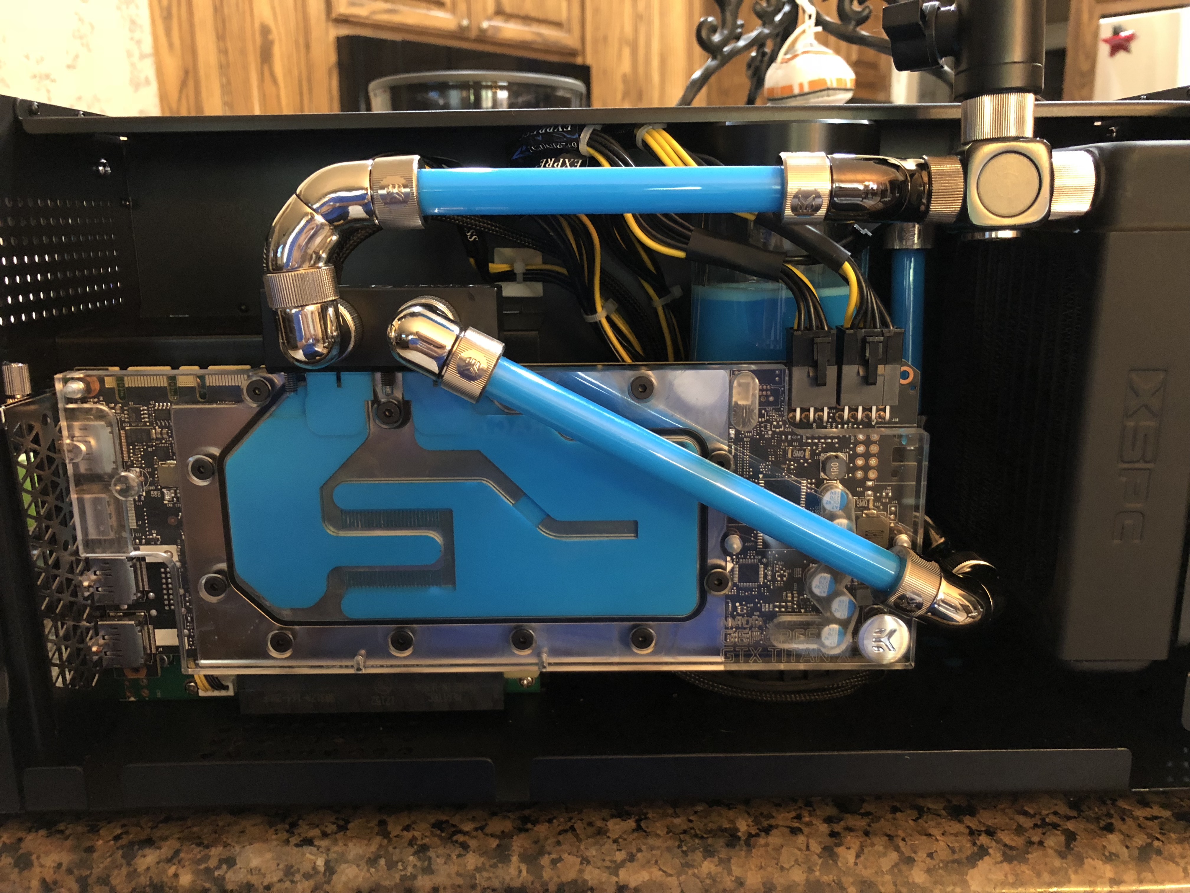

I am now on an Akitio Node with a custom hardline watercooled GTX1080Ti.
I have used this on a 2013 Mac Pro, repurposed that machine and now have it connected to a 2014 Mac Mini base model.

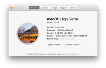

Currently pushing 2 - LG 34" UltraWide 3440x1440 Monitors
