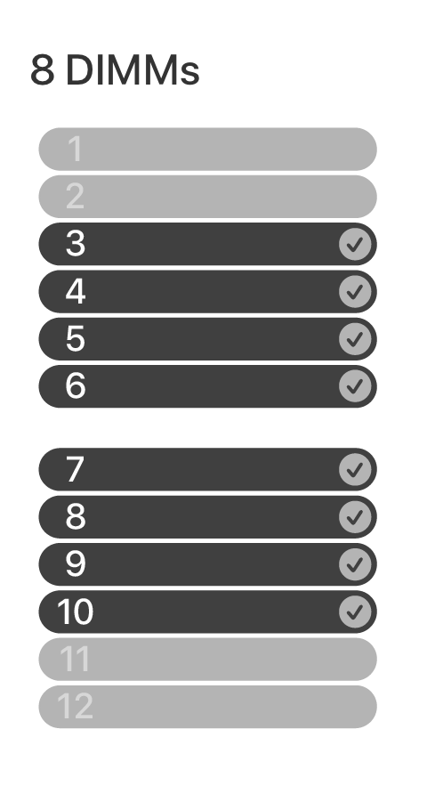

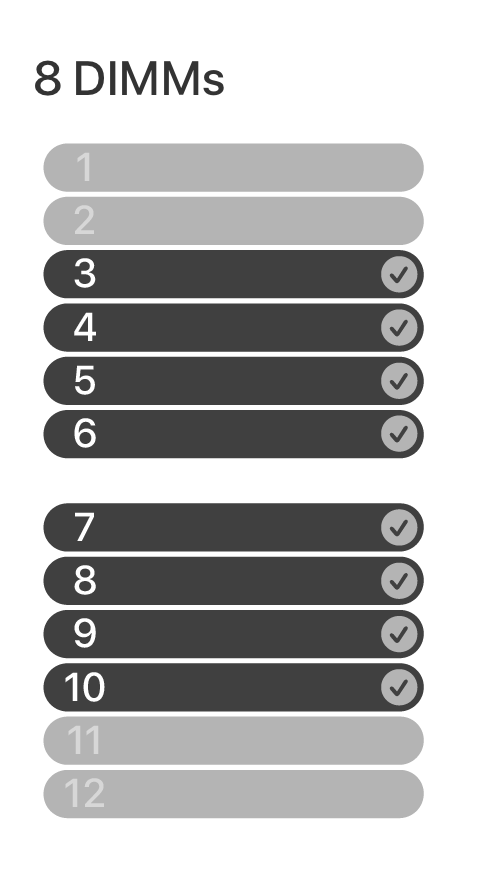

Please read the post I linked above. You should run six or twelve of the same size and type of Ram Modules. or six of one type and six of another. to get to close to 128GB - run six 8GB and six of 16GB = 144GB.
You could run eight DIMMS - four 8GB and four 16GB = 96GB - For a performance hit. Configure like this:

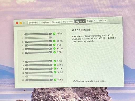

Err it’s a supported configuration. Confirmed by Apple Support... please take back your ‘hodgepodge’ comment... Just became the chips are of different from sizes.. it runs well..

with respect you are misunderstanding how ram in the new Pro works... It’s a new machines so understandable, but the highest capacity chip needs to go in certain slots then smaller chips can fill out the remaining slots in a specific order without performance penality
I'm not misunderstanding at all. You can do it, but it does have a performance impact. This isn't a special "Mac Pro" feature, it's the same for all Xeon based systems including Lenovo workstations etc. where you can download a spec sheet on RAM configurations that give you a bit more technical detail.
well ok then... your welcome to your reality. Apple’s Ram advisor App in the Pro 7.1 says different and I’ll follow that over internet advice. Have a nice day.
