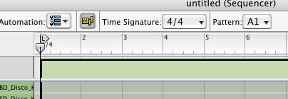

EDIT: With the Redrum unit you need to use the little button between the Automation and Time sig controls to add the pattern selector:
