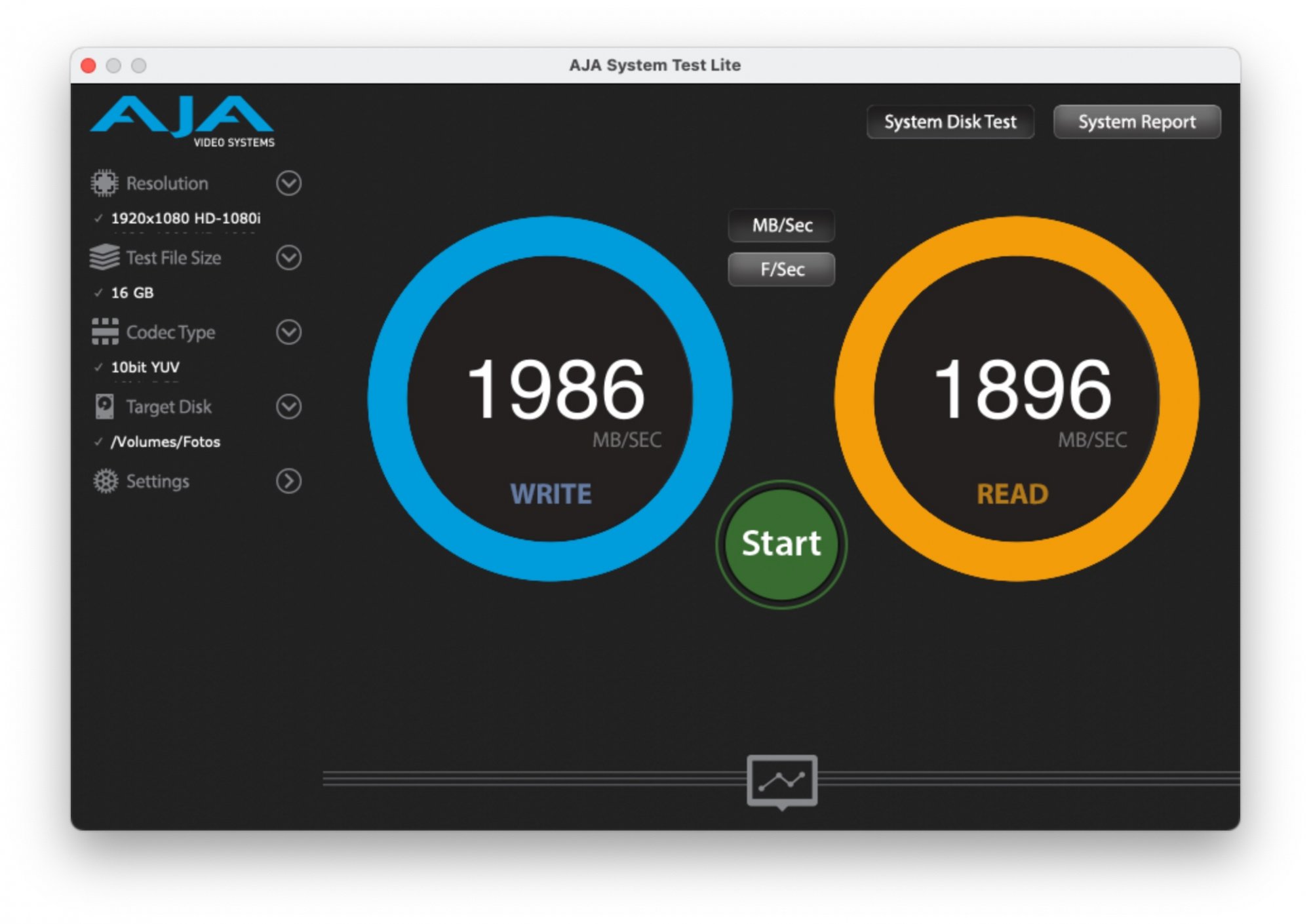

I've been curious about this also. A TB3 external NVMe SSD maxes out around 900 mb/s attached to a TB3 dock or Mac mini in Target Disk mode using the TB2 to TB3 adapter. I'm not sure if you can get faster.
i definitely have had faster thunderbolt 3 ssdd hooked up to my m1max laptop and my 2019 16” intel MacBook Pro. 40mbs mean you could in there get 5GB/sec throughput. I’ve gotten 2GB/sec on those laptops.

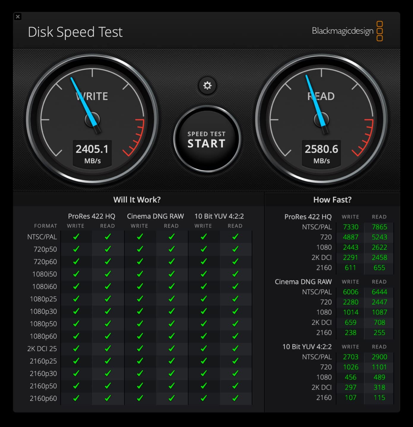

It's rated to do 2700MB/sec but real world I get around 2GB/sec on my 16" laptops.
A 16" laptop is not a 6,1. Did you get 2 GB/sec on the 6,1?
