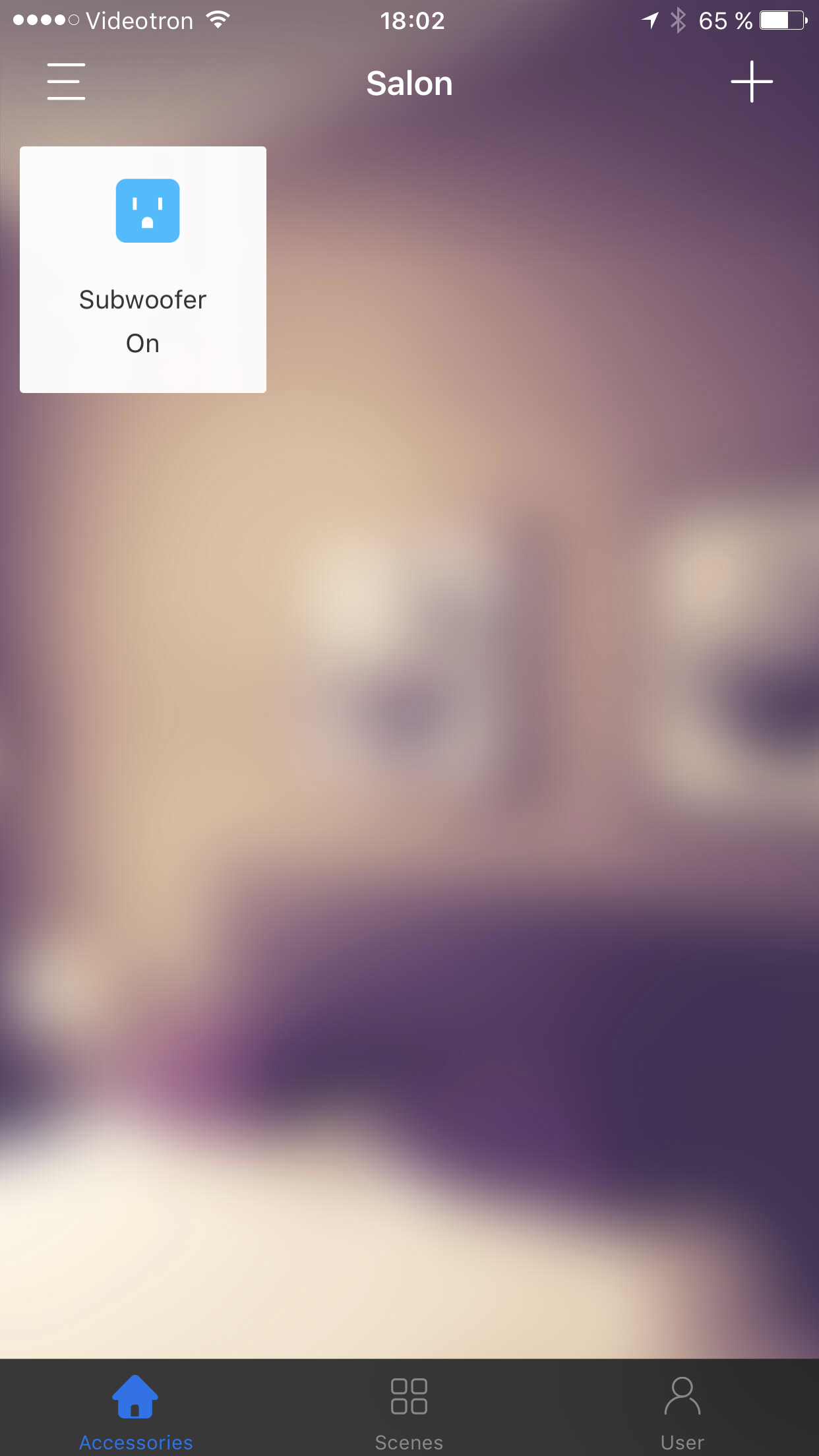

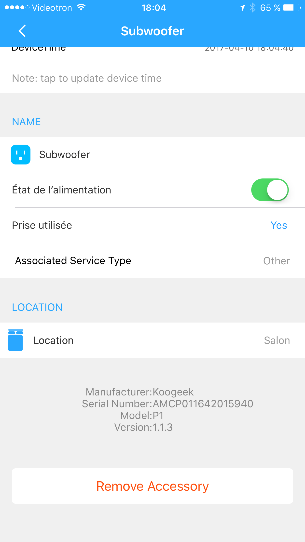

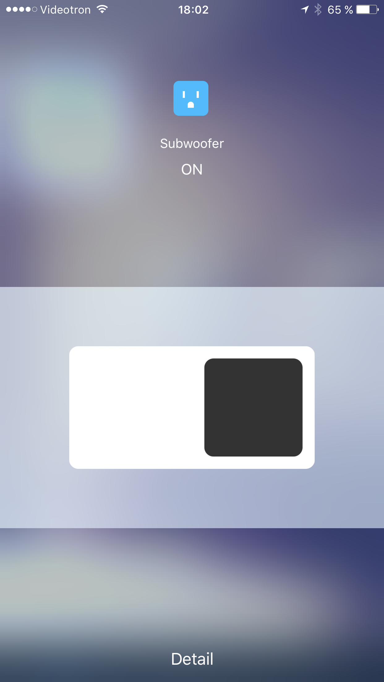

Make sure to update it! In the koogeek app you have to long press or 3d touch the plug itself and clic "detail" (or the option at the bottom of the screen depending on language) and then you'll be offered a firmware update for it.
From what I figured, it's the only way to update it and it's not super easy to find 🙂
For my hue bridge and light the update was offered automaticaly, but it seem to be manual only for koogeek.
1.1.3 seem to be the latest version for now.
