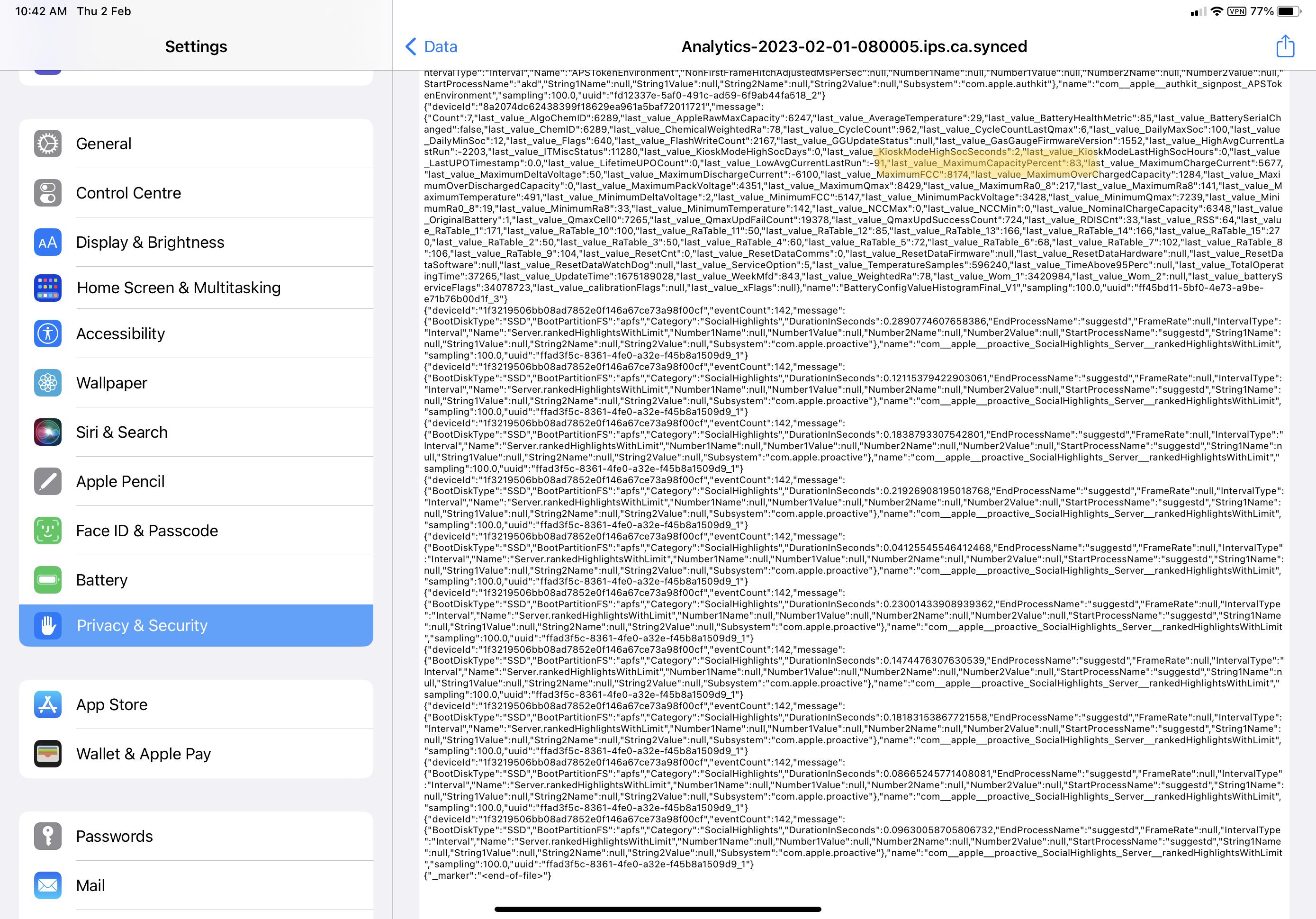

It’s apparently possible to read your battery health from the analytics page in settings. I hope there’s no sensitive information I am leaking this way.
Mine’s at 83%, though it sometimes feels worse than that. Oh well.
