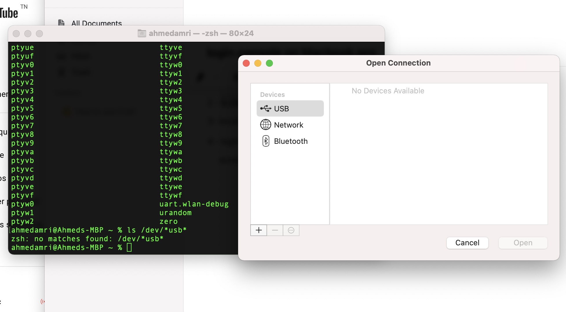

for mac bigsur i haven't installed any driver seems driver was preinstalled, i also tried download the driver for usb to serial cable for macbig and i am getting error version of driver not compatible with operating system.
i have tried even the Serial 2 program from decisivetactics and there is no usb connection to ope see the screenshot

that is strange. Serial.app works with almost anything. list of supported devices:
maybe get a new USB-to-serial converter, try another one?

just tried two different converters in Monterey 12.0.1 and they both showed up in Serial.app.
Use Homebrew lsusb to see if the system sees the USB serial dongle:
https://formulae.brew.sh/formula/lsusb

Then, see if a tty has been established usually using the serial number as name:
Code:
ls /dev/tty.usb*
/dev/tty.usbserial-ftDI
Then, test connection:
Code:
screen /dev/tty.usbserial-ftDI 9600
