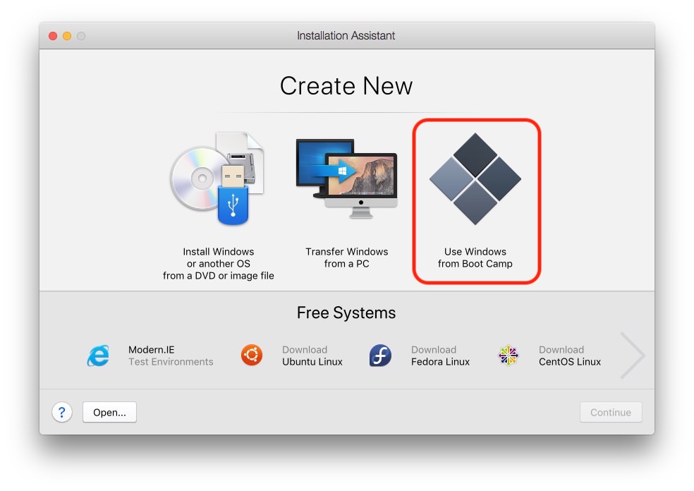

Yes, it's one of the selling point of Parallel Desktop. It can "share use" your Bootcamp partition inside MacOS. However, it also increase the chance that to screw up your Bootcamp partition.

Just tried Parallels, and it says I don't have disk permissions for my [separate] Bootcamp drive. I tried Paragon, which is supposed to give custom access to NTFS drives, under OSX, but it still doesn't work.
