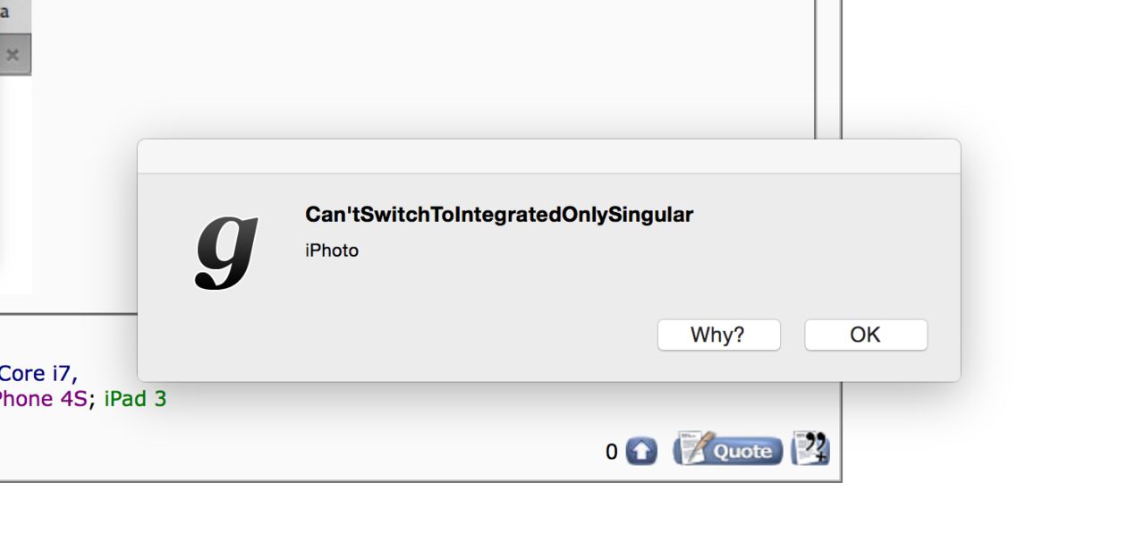

I do but sometimes it uses ded GPU despite GfxCardStatus. If I am wrong, please explain me what I am doing wrong.
If you select it to show what can seen in the attached image, then it cannot switch GPU.

As I said before, some apps prevent integrated GPU and force dedicated GPU. It is even written on gfx website.

It can be a little buggy, so sometimes you have to hit it a couple times. It has to be launched before any of these apps, meaning that if an app is dependent on that and you don't have it disabled prior to launching the app, you won't be able to disable it. The point here is that you can't disable hardware in use. If these applications were truly dependent on it, they wouldn't be able to run on a number of machines. I don't think you'll be affected much by disabling it either. Matlab supports CUDA libraries, but you're unlikely to ever use them. Parallels is the only one that might have an issue. I am curious why your brother persuaded you to pay for one with a second gpu. Apple's markups don't really justify it unless you're also paying for the additional storage. Prior to the current cycle, a ram upgrade on its own was also $200, so it could have made sense for more people.
I launch these apps after clicking "i" on gfx (I know that sometimes I need to click it more than once) but it forces ded GPU anyway.
