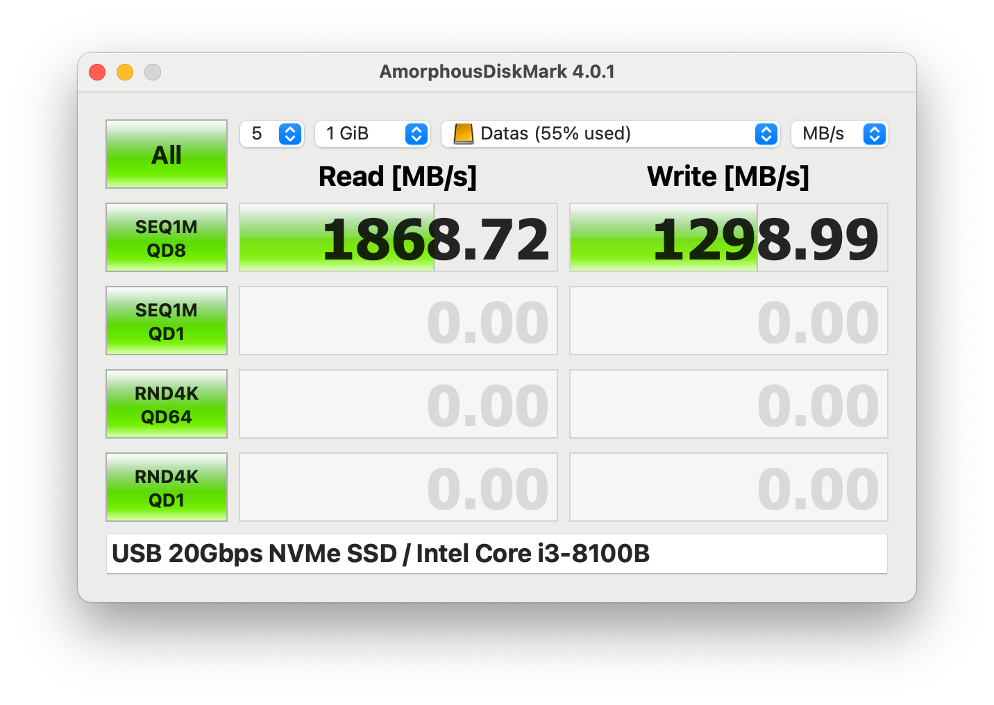

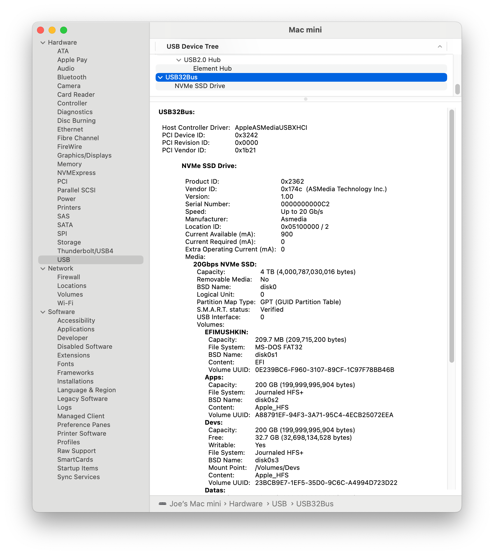

Tried it now with a Mac mini 2018 and Sequoia 15.0. It seems to work fine.
I'm using an ASMedia ASM3242 from StarTech. https://www.startech.com/en-ca/cards-adapters/pexusb321c
I have it installed in a Sonnet Echo Express III-D (Thunderbolt 3 Edition). A single PCIe slot enclosure would be less expensive. The half height Sonnet Echo Express SEL is sufficient since the StarTech includes a half height back plate.
The Sonnet is connected to a CalDigit Thunderbolt 4 Hub since the Sonnet is far away from my Mac mini. The benchmark shows numbers greater than USB 3.2 gen 2x1.
I suppose the benchmark would be slightly faster if the Sonnet were connected directly to the Mac mini.
USB 3.2 gen 2x2 20 Gbps.pngMushkin 4TB in SIIG USB 3.2 Gen 2x2 enclosure.png
Reactions: EugW
