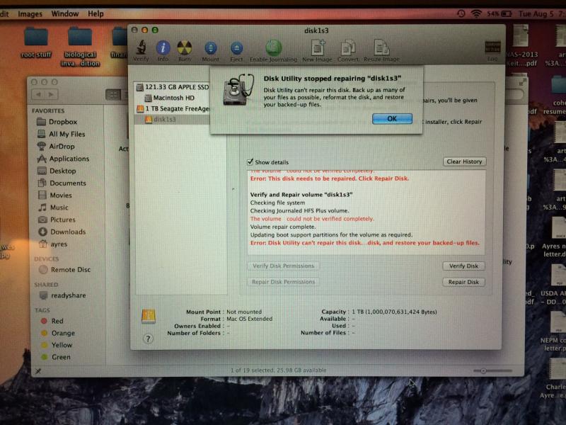

hi all, plugged in my external to my mba a few days ago... it mounted but then i couldn't access it. with each successive try, it didn't appear in finder/desktop. but it appears in disk utility. here's what i got:
while i have most of the content saved elsewhere, i'd still like to get into it one more time. would software like diskwarrior or a trip to the apple store be of any use? cheers
You can certainly try DiskWarrior, I've had it work some miracles and also not be able to help too much, so keep your expectations in check.
My general rule of thumb is to totally discard a disk once it has run into a problem like this one. They're cheap these days... After running DW, take your frustrations out on it with a hammer.
Apple store will likely not be able to help much.

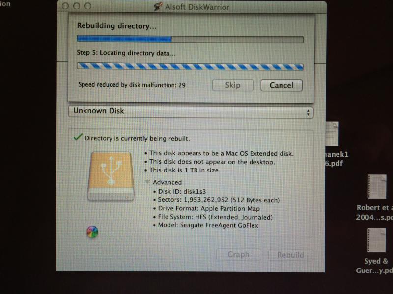

thanks all, i started diskwarrior this morning in an attempt to salvage any data possible.
i started the rebuilding process and have left my computer alone. but in the past four hours, it's been stuck at step 5 (locating directory data) and beachballing.
so to anyone with diskwarrior experience, after this long, shouldn't the rebuilding be completed?

I've had a Disk Utility error that couldn't be repaired that DiskWarrior had no problem in repairing. It didn't take very long to rebuild the directory that time. I would let DW keep running and contact DW support to see what they'd have to say about this.

K, thanks... I'll give it another try
