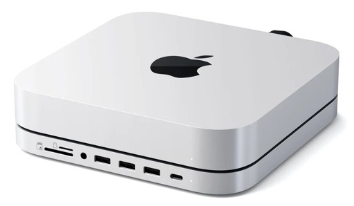

Can you post a picture showing how your mini is placed on the wall? Is there a rack to hold the mini in the vertical position on desk? The ports need to be easily accessible, and the air inlet must be free of any obstruction.I forget where the BT transmissions originate on the Mini, but I THINK I recall they are from the bottom. I have Studio and it also broadcasts from the bottom too. So I mounted it on a wall, top side against the wall. It is behind my monitor so it is invisible without moving the monitor, but the bluetooth tech is facing out and not against any surface (like a desk). I've had no bluetooth issues for nearly a year now.
Anyone interested in Mini with a setup where you are facing a wall might consider doing the same or similar to get around the design flaw (if it persists in this version). If your Mac won't be able to be nearly invisible in such a spot, a nice shelf might be a prettier option than that velcro holder I'm using.
