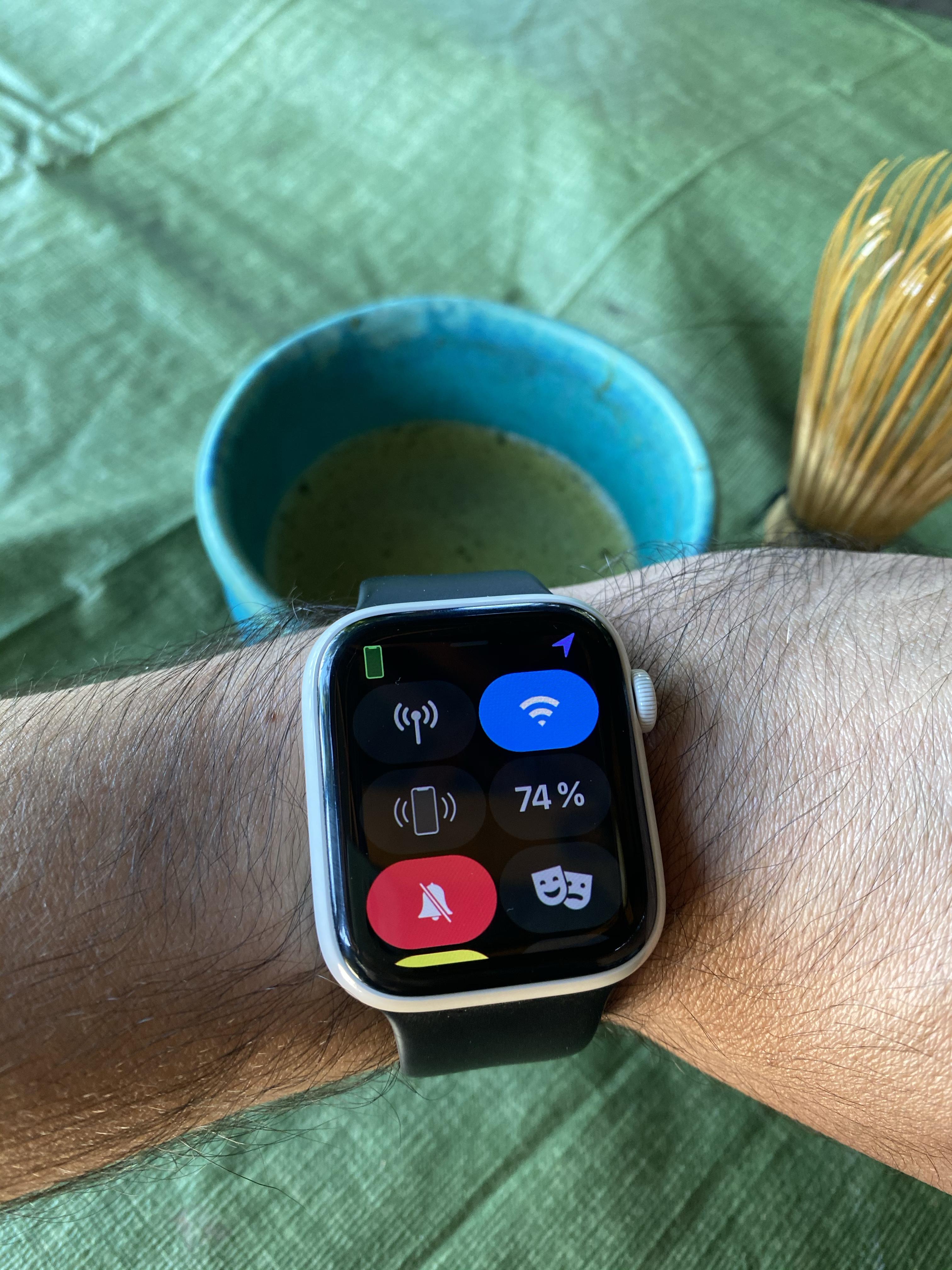

I unpaired and set up as new last night and there’s a night and day difference, I’ve been wearing it since 6:30 today and it’s currently 14:03 and it’s at 74% so you might want to give that at try it worked brilliantly on my S5 cellular model
When you do that does the carrier have to be setup again or does it remember?

It’s the only thing that worked on mine, I tried everything yesterday. As a bonus the hand washing timer and raise to speak is also working way better.
