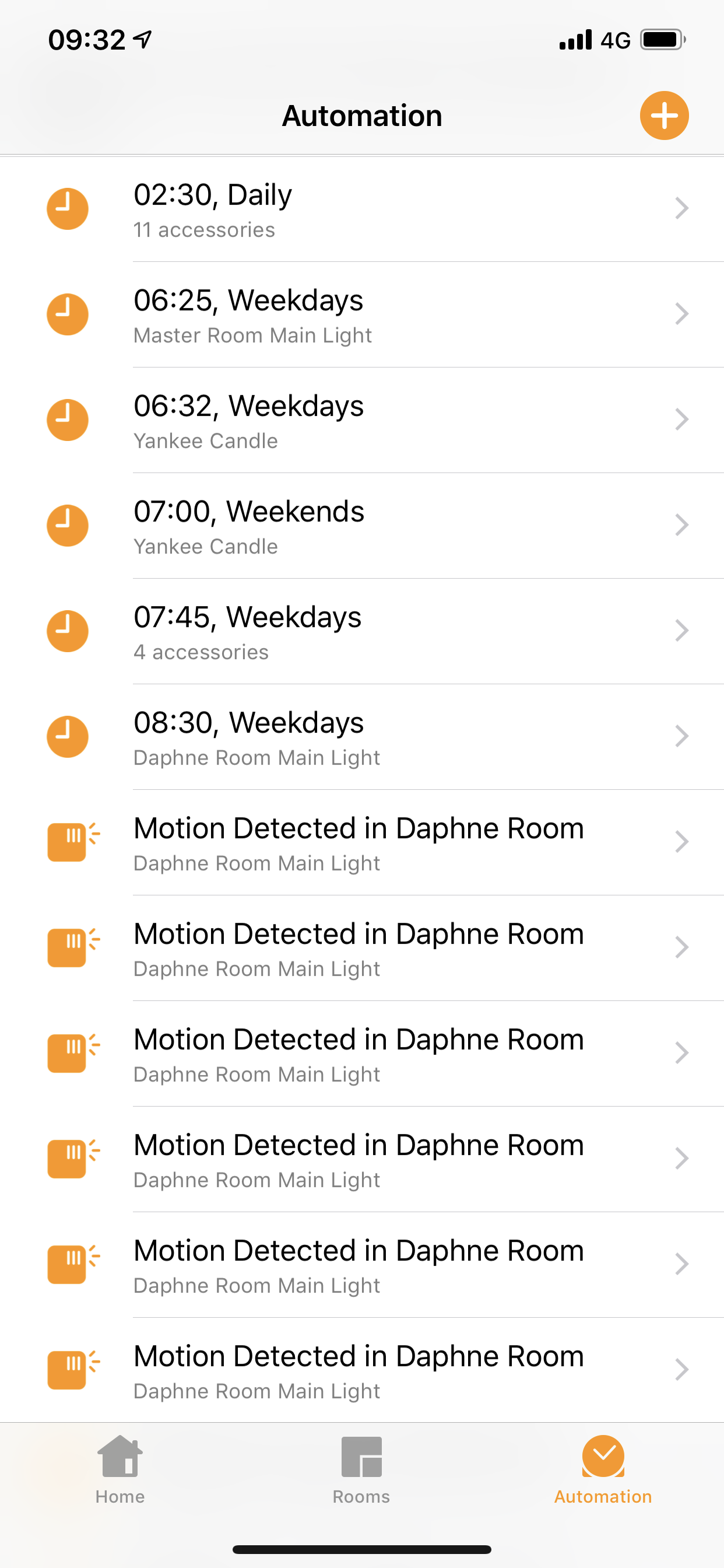

i have over 10+ hues light, 9hues motion sensor, eve switch, 2 august smart lock pro.
with over 50+ automations created.
as of now i am super happy that it works 99.9% of the time. automation create scene when i home, off the scene after 20mins, wake up, go to slp scene. motion sensor triggered and off after X mins.
I am on Ios 12.1.1, apple TV 4k as main hub, ipad pro 1st gen as standby hub.

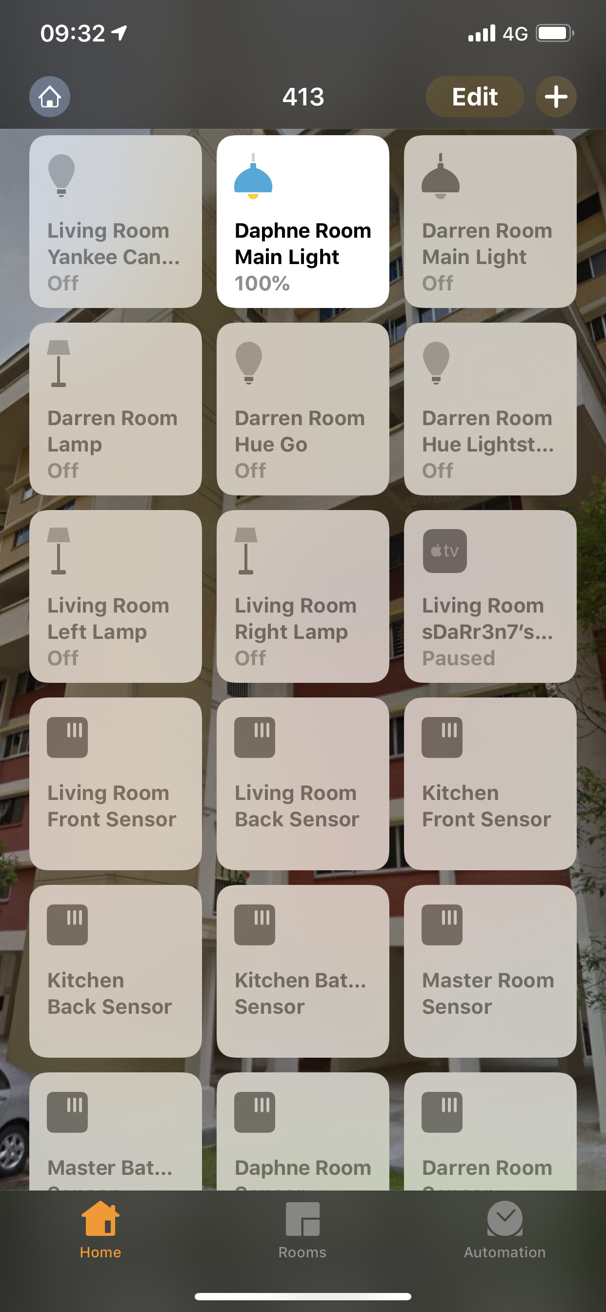

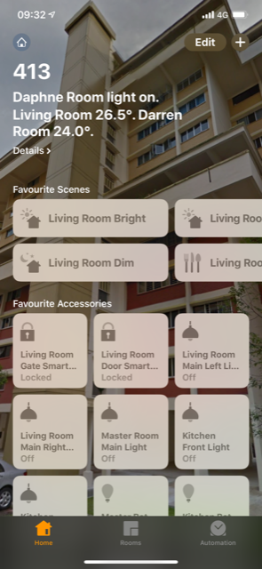

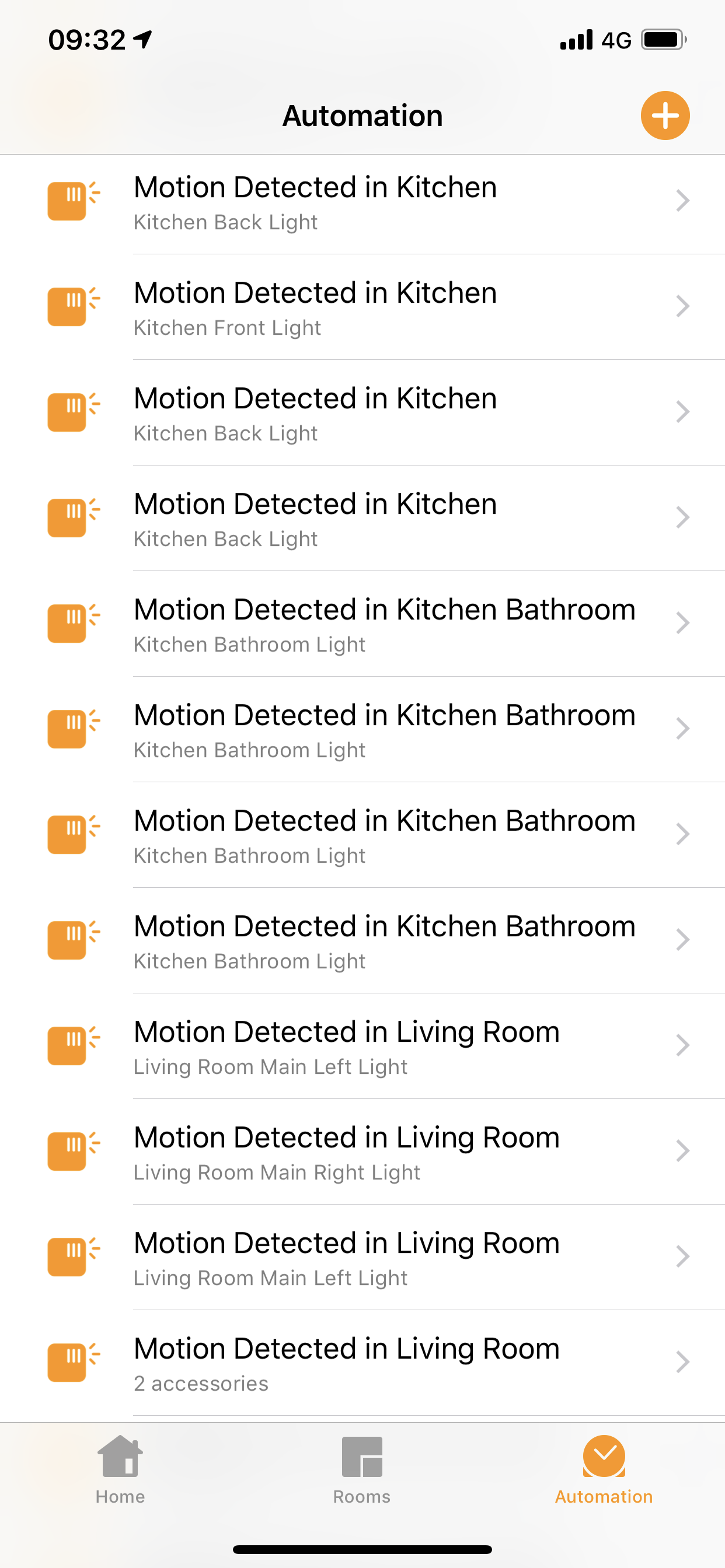

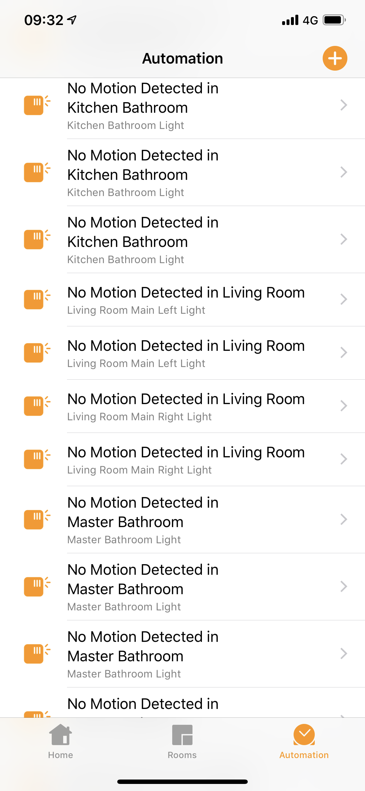

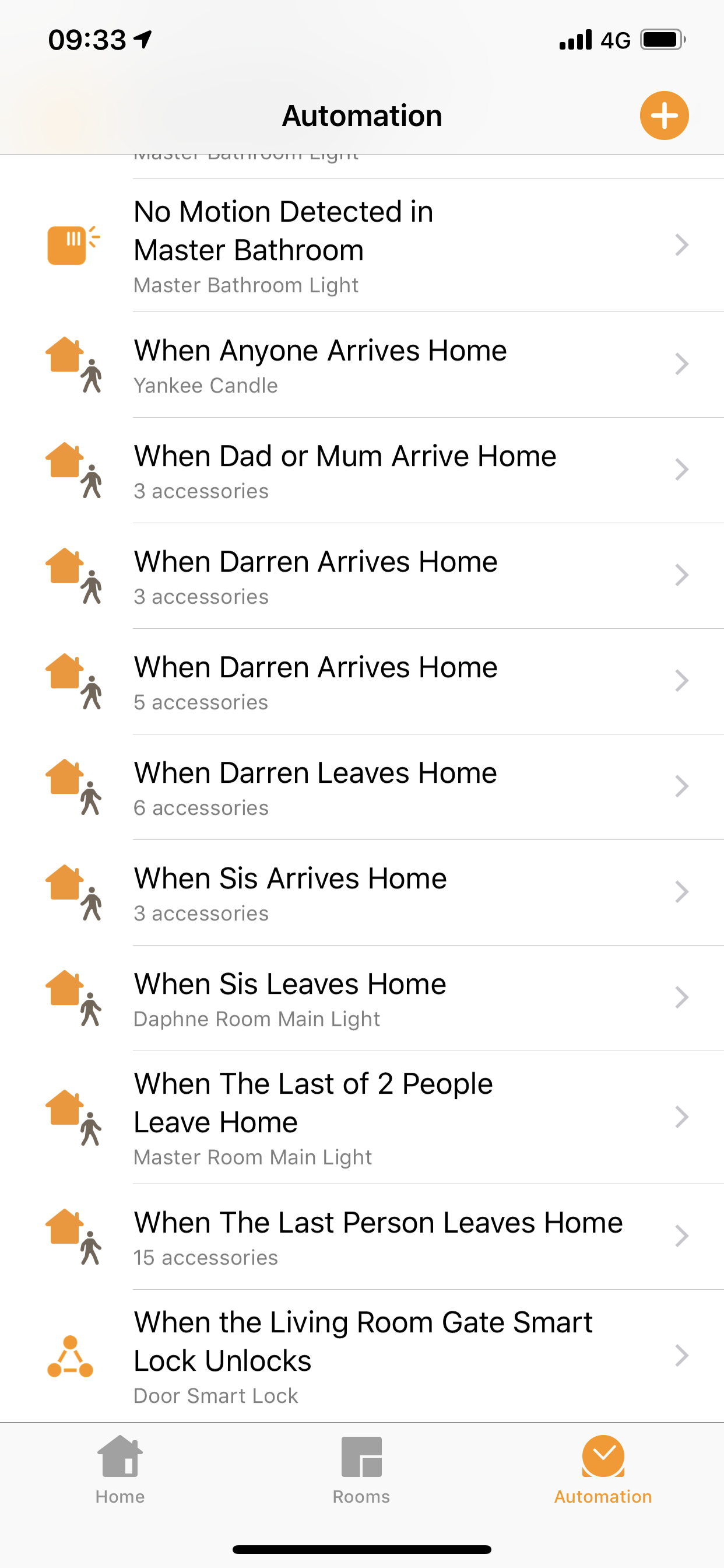

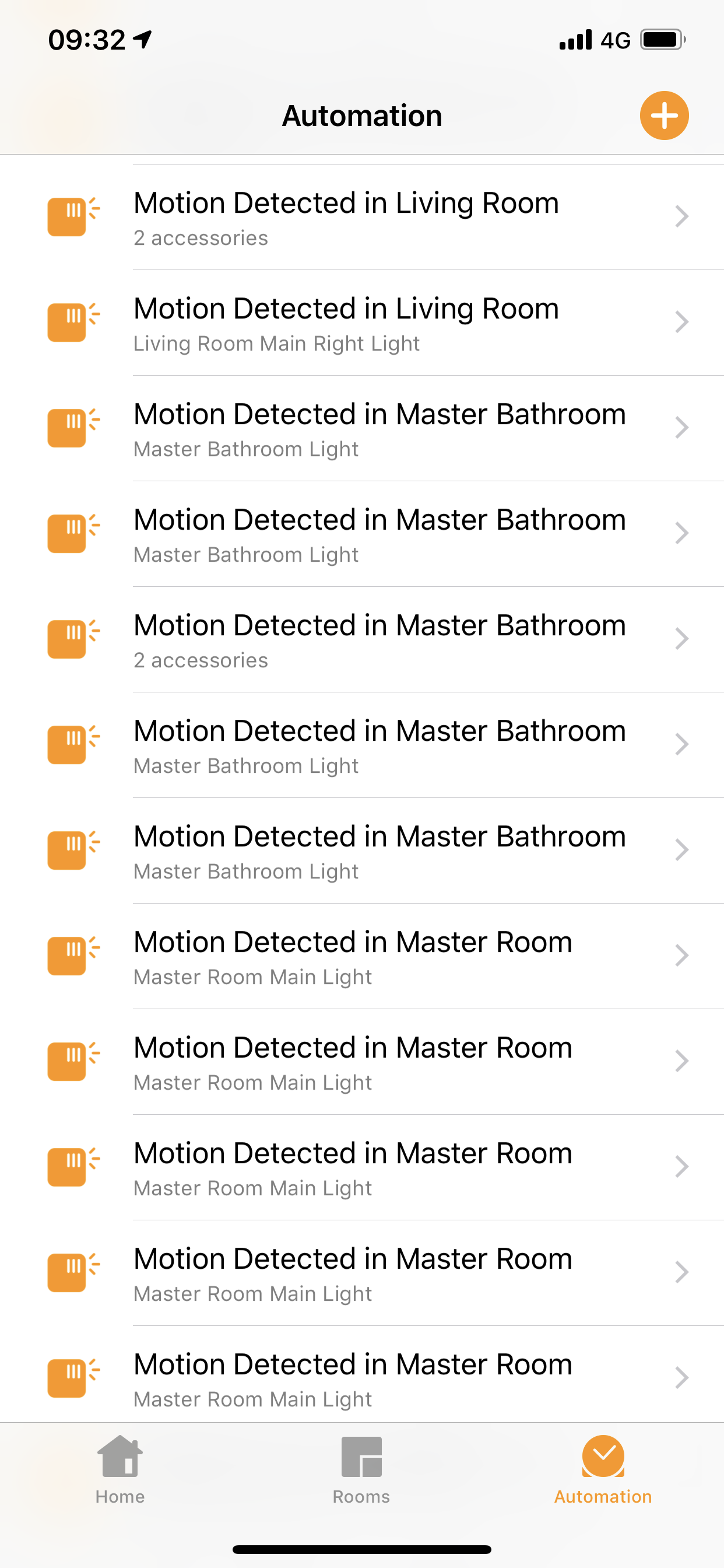

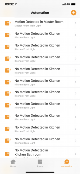

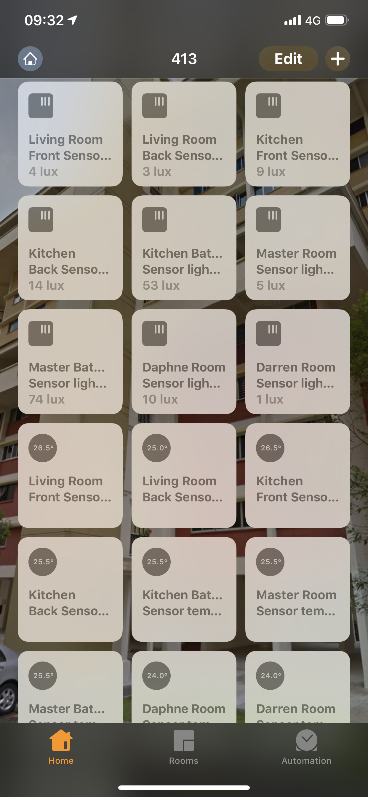

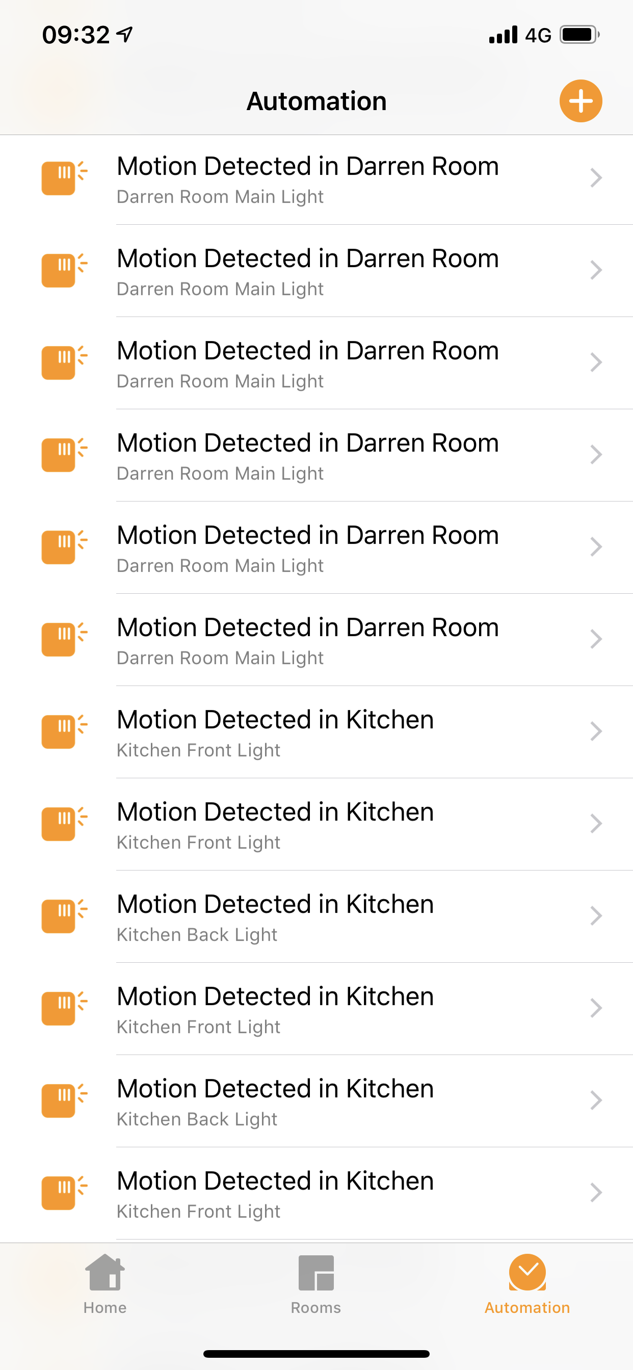

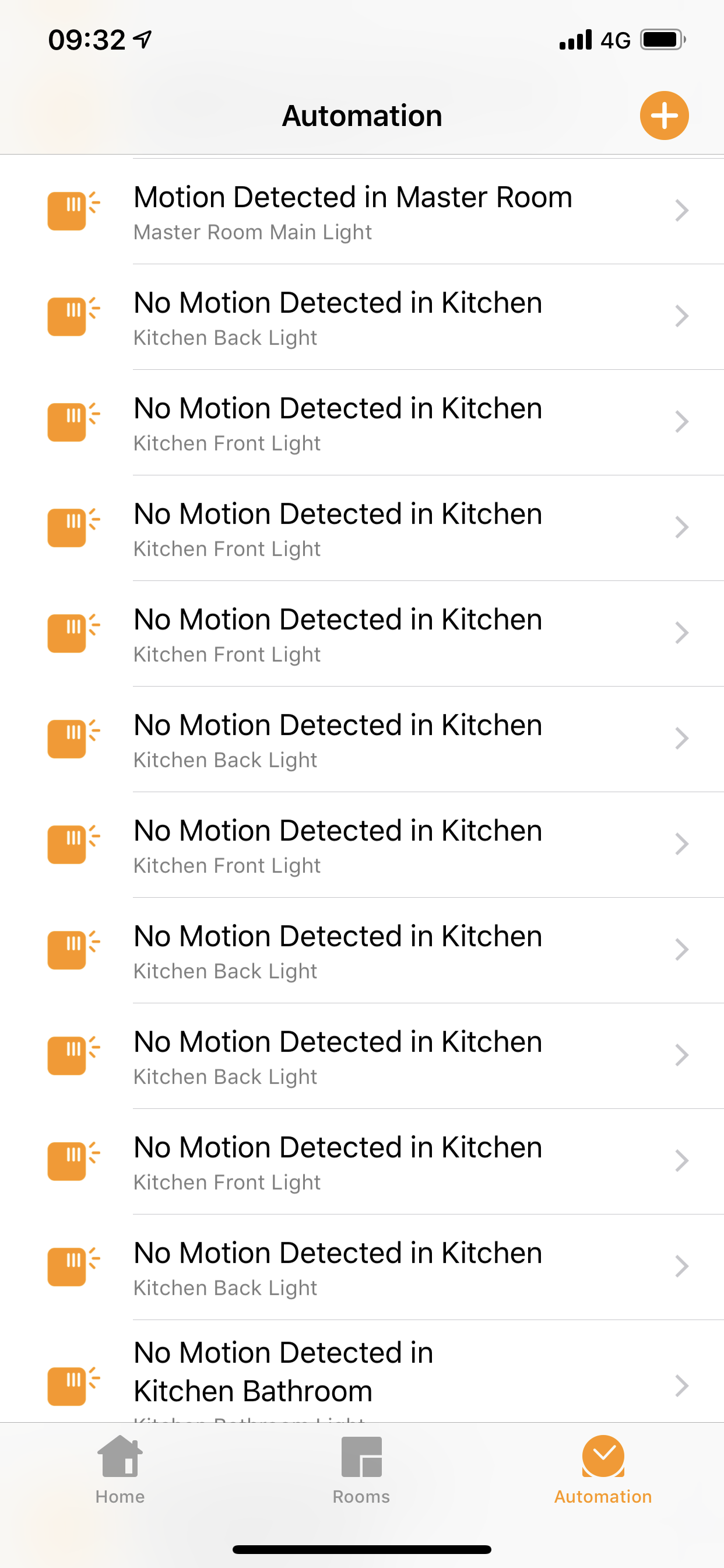

below is my automation and homekit.
first.PNG IMG_2021.PNG IMG_2022.PNG IMG_2023.PNG IMG_2024.PNG IMG_2025.PNG IMG_2026.PNG IMG_2027.PNG IMG_2028.PNG IMG_2029.PNG
