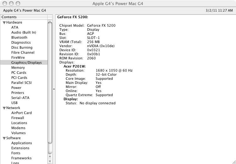

I hooked the VGA cable up to it, and it's working!!!
And zen, this is an AGP card.
Now I have a 256MB FX5500! What a change from the 64mb Radeon 9000 Pro.
EDIT - Interesting, comes up as a 5200. Oh well, it works and that's all I care about!
