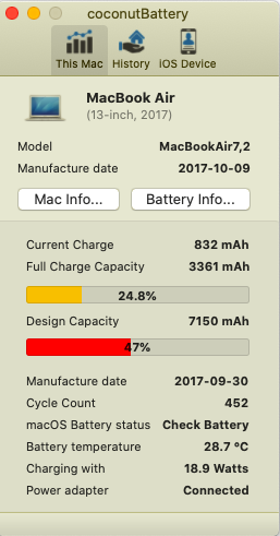

I have a Late 2017 Macbook Air, which I bought direct from Apple in April 2018. My battery seems to have failed - I'm getting a 'Service Recommended' message, and after resetting the PRAM and SMC, and doing a full discharge recharge, I'm still getting the warning. Coconut battery tells me the full capacity is 3361 mAh and the cycle count is 452 (full details attached). I'm disapointed that the battery has failed after less than 3 years of less than intensive use - apple says it should last about 1000 cycles and I would expect longer than this at least. There don't seem to be any recalls on this model, and I don't have apple care so I've got no other coverage. Before I go ahead with replacing the battery myself, I'm wondering if anyone in the UK has had any success claiming for battery under UK consumer law - it seems that I'm covered for 6 years this way? Thanks

Coconut Battery is an estimate. Apple uses their own software to determine the health of any battery. And even though it is showing 80% health with less than 1000 cycles, that doesn't necessarily mean the battery is defective. A lot of different factors affect the chemical makes up of the battery.
But mine is showing that the battery needs servicing both on coconut battery and on apple battery, and has only done 452 cycles. It's not on 80% health.
My apology. I missed the part about the Apple service message. My point still stands, though. Although not probable, your battery may be prematurely worn due to several different factors, instead of defective. If you send to Apple for repair, I doubt they will rule defective given the time frame. I would not raise the legal aspect unless you have a way of proving it, which you don't.
