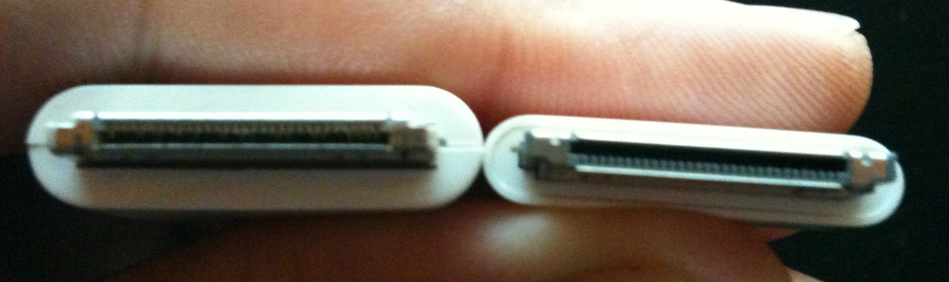

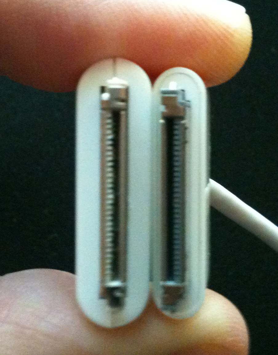

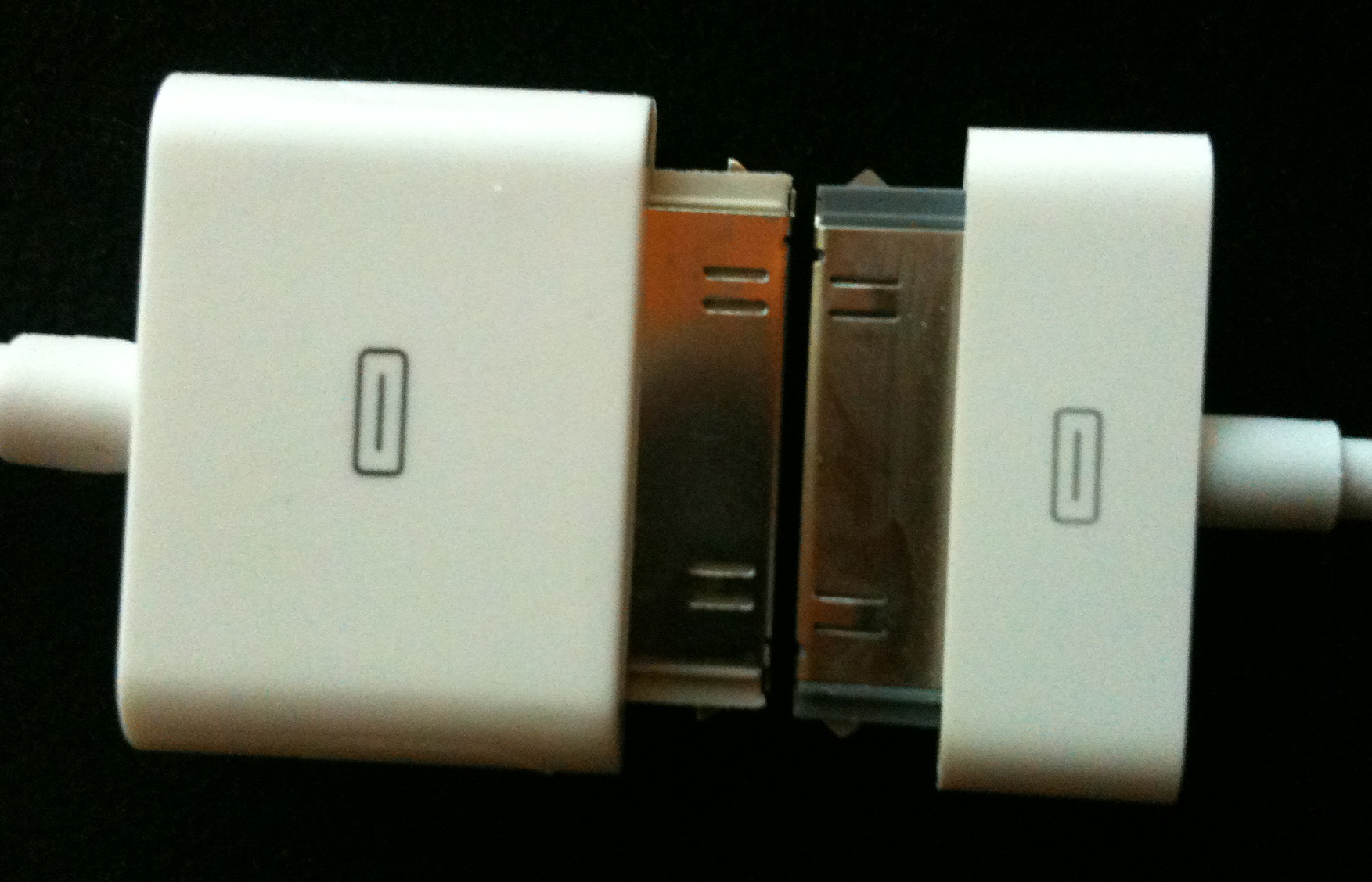

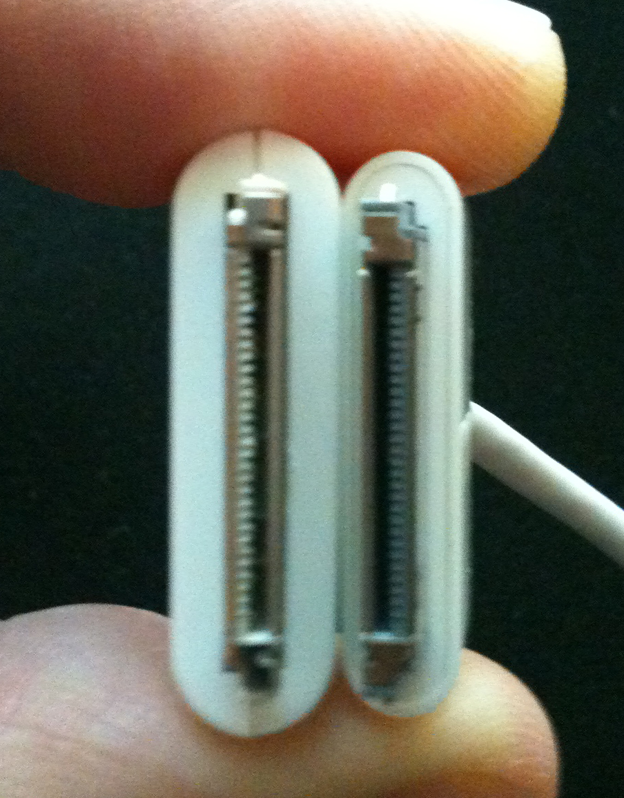

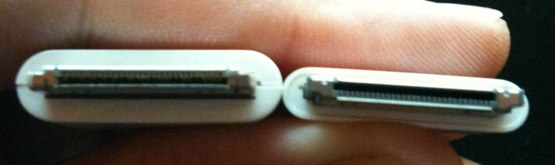

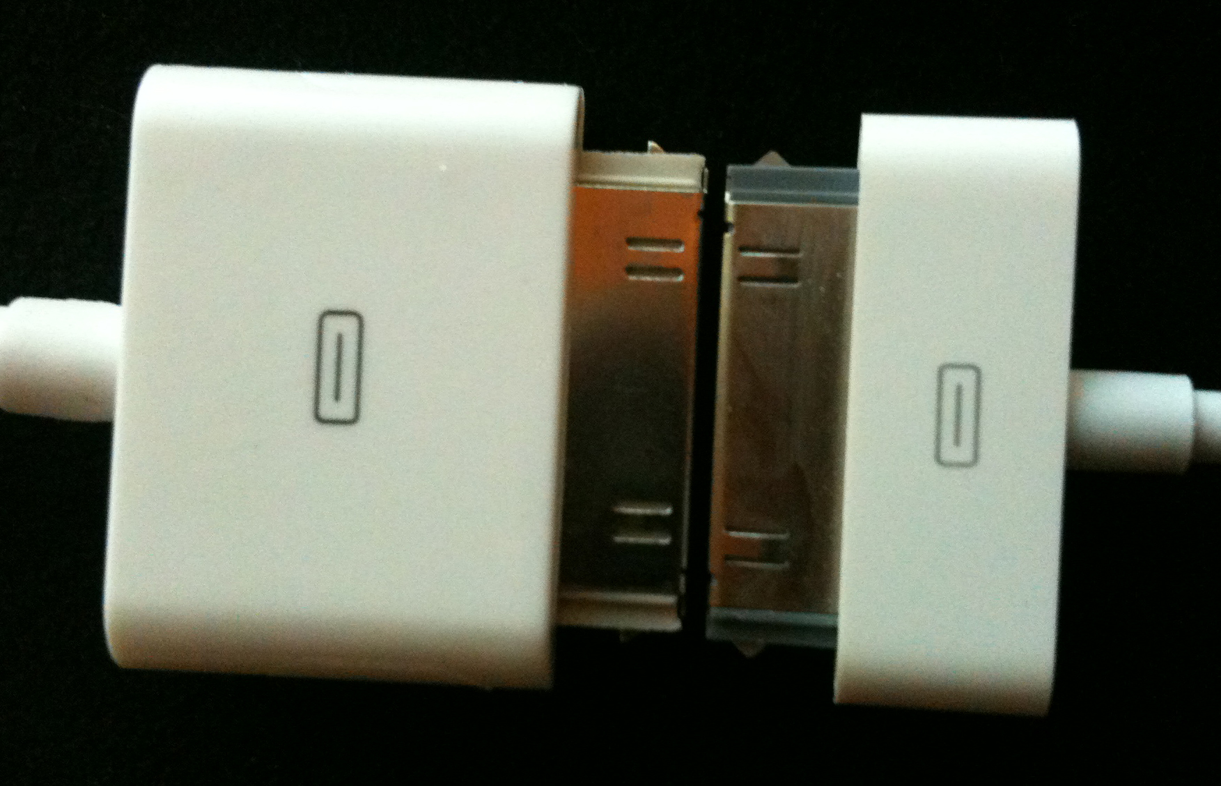

I don't have the OtterBox, to be able to say 100%, but I do have the dock extender cable, so I took some side by side photos next to the iPhone dock cable that comes with the phone.
The Dock Extender is on the left, and Apple cable on the right. The width is identical, but the dock extender cable is a bit thicker.

But it doesn't look longer than the stock connector, will it go deep enough to make a good connection through a defender case?
Oh, OK. I didn't know it was a length issue. I thought it had to do with the plug size itself.

Daremo, I think he was talking about the depth of the metallic part of the plug connector.
Megalobyte, I do think that the plug on the Radtech Dockextender has sufficient depth when compared to the stock connector to make a good connection.
Daremo, if you can perhaps do a measured scale comparison of the depths between the plug-ins of both cables, it will help address OP's concern.

Hmm, that might be a bit too thick to fit into the Otterbox dock port—there's barely enough room for even the stock cable. Thanks for the picture, though—that's possibly the most helpful answer you could have given 🙂

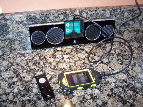

I use the sendstation extender with a logitech dock radio. My case is the isolo and it works well. It is no bigger than the cord itself, so I would think it works in any case that allows insertion of the apple sync cable.

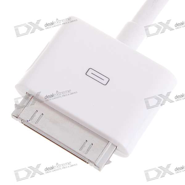

I recently ordered one of these so i could try to use the battery in my incase power slider if im camping or something without having to take my phone out of the defender case. I'm just waiting on shipping and I will let you know if it works or not. Even if the plastic housing is too big to plug into the iPhone, those cables are so cheap I'm not opposed to modifying it.
NICE FIND! and they look to have longer data/charging cables as well that will work with the defender...... super cheap... i hope they work, i'll try em out......

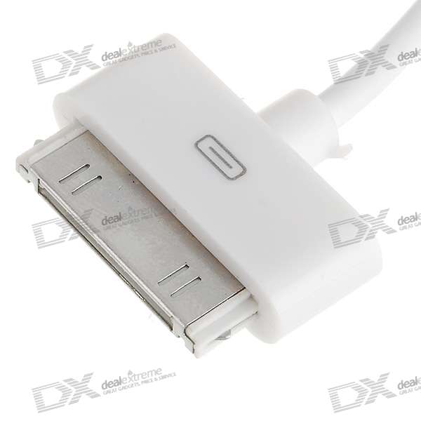

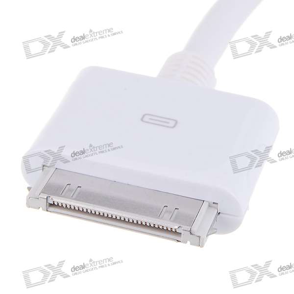

Any comment on the cable from dealextreme linked above? Just to add a bit of information from my own searches, I have seen are several options for cable extenders (male to female) from dealextreme. I've linked them all below with corresponding photos of the male-end. There is also this extender from 3GJuice, called the “Finally There” Cable – With Otterbox Support" but it is just as much as the one from Sendstation (~$30). Here it is on Amazon (currently unavailable): http://www.amazon.com/3Gjuices-Finally-There-Cable-Extension/dp/B0032I7PUK
http://www.dealextreme.com/details.dx/sku.30393
http://www.dealextreme.com/details.dx/sku.20628
http://www.dealextreme.com/details.dx/sku.21892

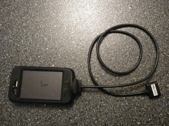

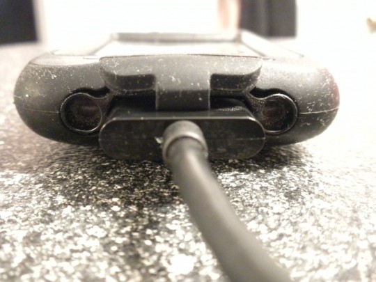

“Finally There” Cable from 3GJuice:
http://funroe.net/2010/01/29/iphone-otterbox-3gjuice-cable-or-thats-a-darn-expensive-annoying-case/

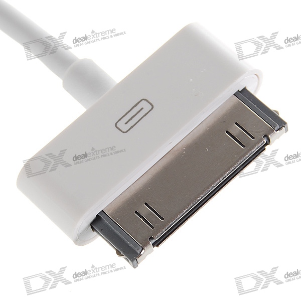

I'll also add some information on standard USB to 30pin connection cables (NOT extenders). This cable appears to have the same dimensions as the stock Apple version and would probably fit through the Otterbox case:
http://www.dealextreme.com/details.dx/sku.21882

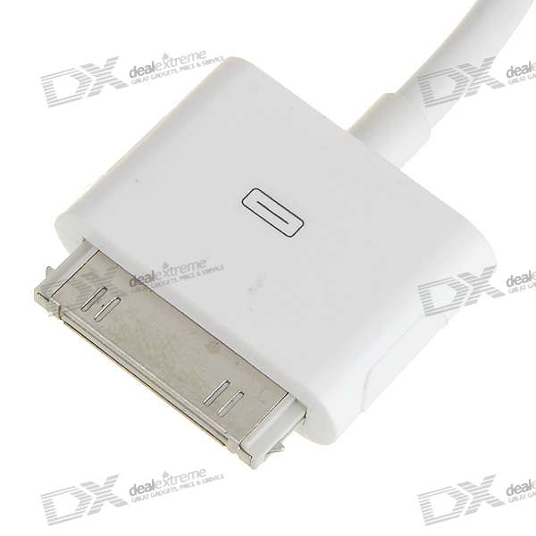

I have the following cable and it does NOT fit through the case, most likely because of the extra plastic "sheath" seen below:
http://www.dealextreme.com/details.dx/sku.23525

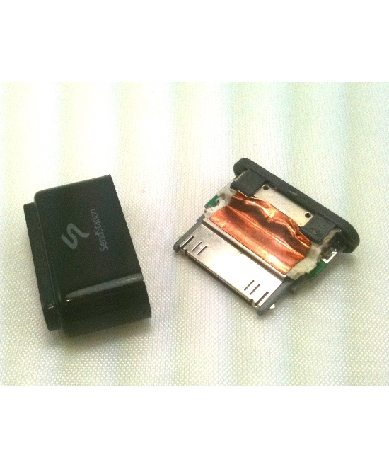

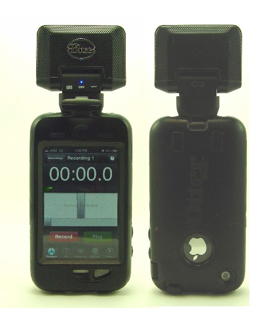

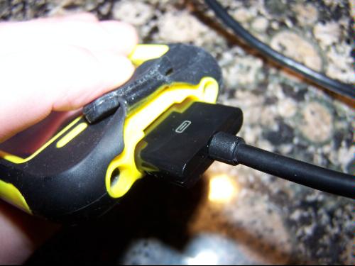

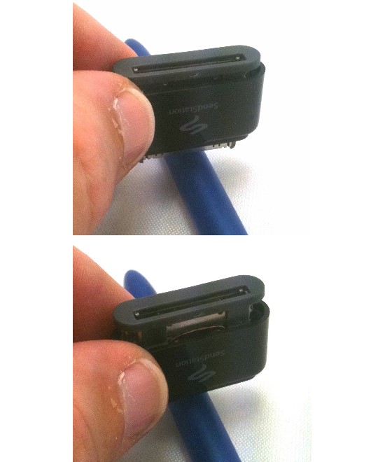

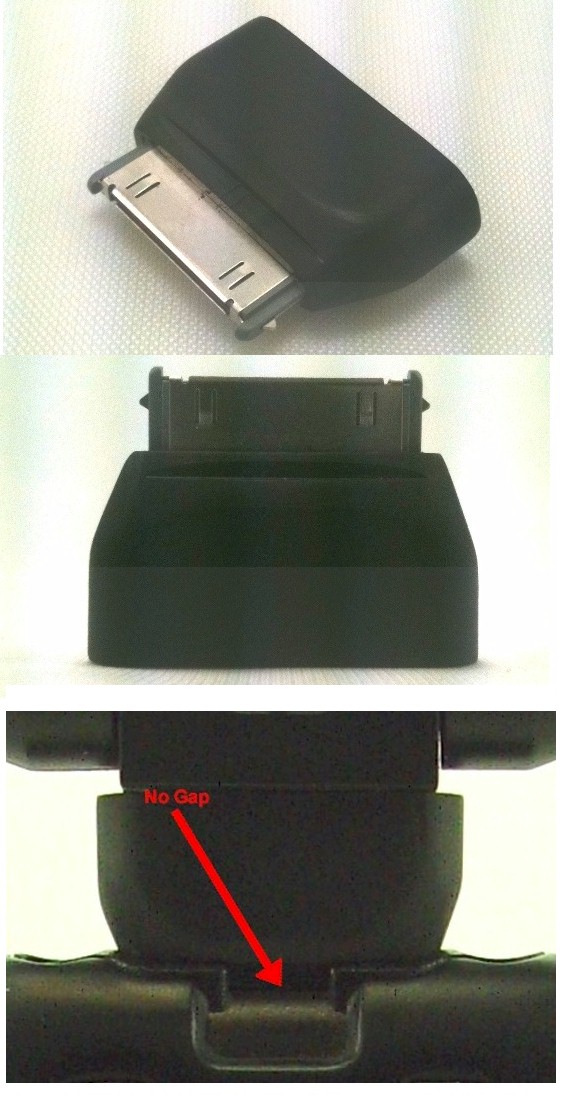

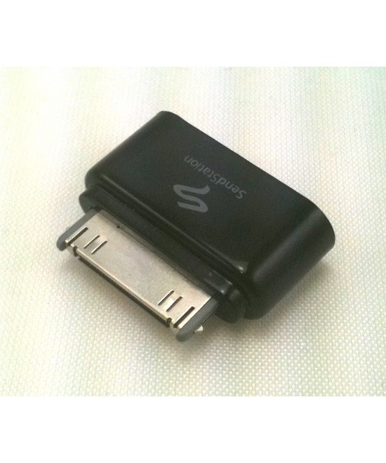

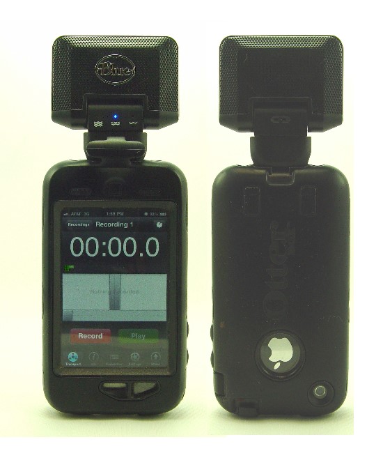

Modified Dock Extender for use with an OtterBox Defender Series Case
First off I must say that the OtterBox Defender Case has got to be the best case for an iPhone. I purchase mine with the iPhone and within two days it had paid for itself. I dropped my iPhone about three feet onto concrete steps and it bounced down two more steps. I thought I would be making another trip to the Apple Store but no, the iPhone survived and the only damage to the OtterBox’s case was a tiny nick to the plastic around the bottom speaker port. And when I found that the belt-clip was too lose to hold the iPhone, OtterBox sent me the update belt-clip at no charge.
The only problem with the OtterBox Defender Case is that the iPhone has to be removed from it if you intend to attach the data-port to any type of dock. Oh it works fine with the data cable but docks need to be at least another 1/8 inch longer and most docks are designed to cradle the iPhone when docked, which can not be done when the iPhone is in the OtterBox Defender Case.
Enter the Dock Extender by SendStation Systems. As it comes from SendStation, the Dock Extender almost does the job, getting an additional 1/16 inch into the Defender Case, but not enough to lock it in place. But with the help of a simple modeler’s file and about fifteen minutes of work, the Dock Extender fits perfectly.
Step 1. Remove the case from the Dock Extender (Note that this, and the remaining steps, will void your warranty on the Dock Extender). The simplest way to do this is to carefully put the Dock Extender across a pen and rock the Dock Extender side to side until the case and the circuit board begin to separate. There is a small amount of goo (like the stuff that holds new credit cards to the paper, what I call credit card bogers) which I assume helps to hold the case and the circuit board together. Keep this as you should not use your own (bogers) when reassembling later. The reason you need to remove the case is that you don’t want to fowl the inners with the plastic filings.
Step 2. Remove the iPhone from the Defender Case. This is to also keep the iPhone’s data port clear of plastic filings.
Step 3. Take the Dock Extender’s case and with a modeler’s file, begin to remove the hips. File off enough material so that, when inserted into the data port opening of the Defender Case, you can not see a gap between the Defender’s case and the Dock Extender’s case.
Step 4. Clean off any plastic filings from the two cases, if you have a can of air, this will work great. Put the iPhone back in the Defender’s case (might as well clear the screen’s protective membrane while you are at it) and reassemble the Dock Extender. When reassembling the Dock Extender, you will notice that one side of the circuit board has two tabs and the other side has one. Make sure that you are putting the case on properly by matching-up these tabs to the notches on the inside of the case.
Step 5. With everything back together, it time to test. Insert the Dock Extender into the data port. You should hear a click as the Dock Extender locks into the data port and it should take a bit of force to remove it from the port. If not, return to Step 1 and file off a bit more.
The main reason I needed the Dock Extender was that I wanted to be able to use a Blue Mikey on my iPhone without having to remove the iPhone from the protection of the Defender Case. The combination of the three looks great and works perfectly. But remember, the Dock Extender comes equipped with a matching Universal Dock insert with a removable support and three interchangeable bumper caps. So, even with this mod, you can now attach your Defender Case into almost any dock that a naked iPhone can use.
