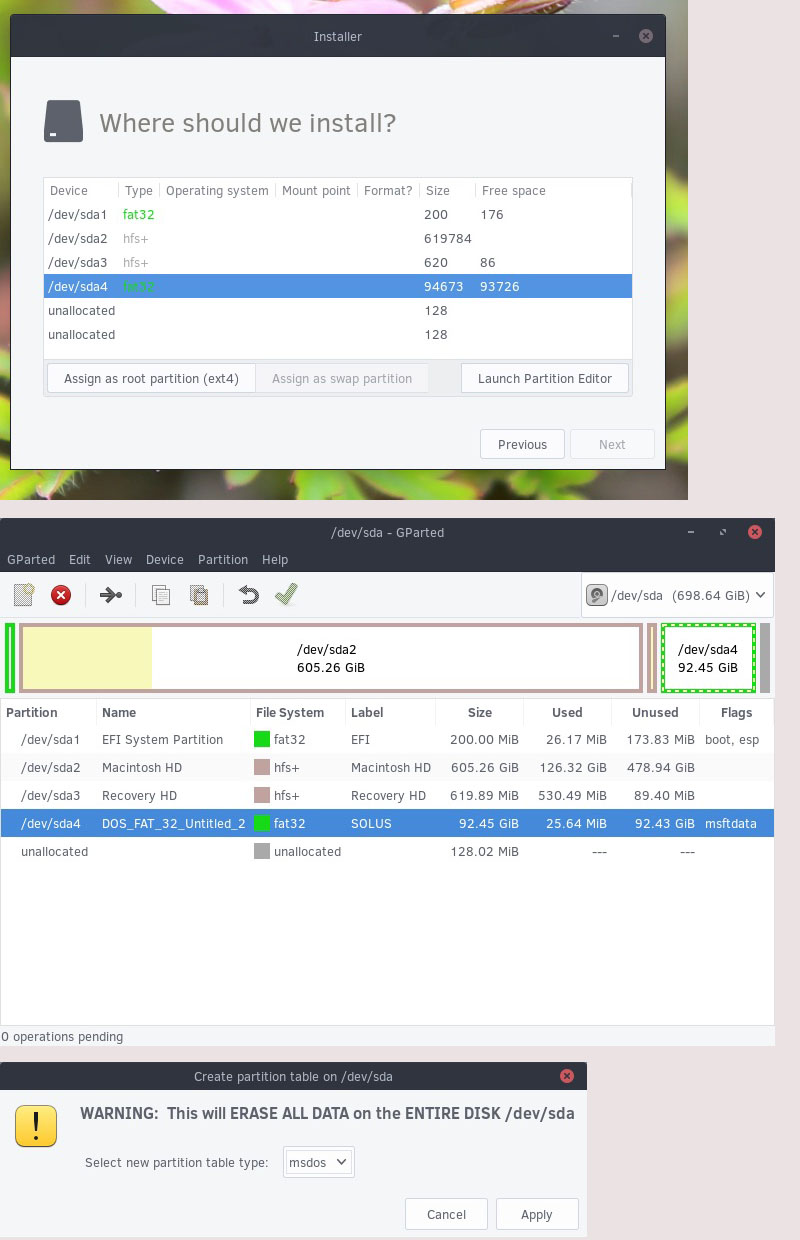

@Fancuku, thank you very much for such a detailed reply. Following your wisely advice, I nuked the Boot Camp partition and set a new 100 GB FAT32 partition where to install Solus OS.
Now, I have stumbled upon this dialog where I refuse to go forward for I understand it would delete the 'whole' disk, Mac partition included which, obviously, I won't like to. Or am I mistaken here? -hopefully so-
Thanks once again for your time and attention.
In the first screenshot, you have highlighted the correct partition sda4, next just click where it says 'Assign as root partition (ext4). That's all you need to do I believe.
Let me know if you still get the warning message about erasing data on the entire disk.
Reactions: Dorothy Gale
And that worked! Now, there is only one option listed where it should install the boot loader, /dev/sda1, a.k.a. the EFI System Partition. I understand the Installer is smart enough to get it right... correct?
