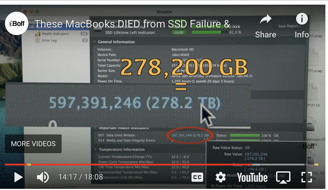

Seems like a lot of FUD. For instance, here he's trying to shock us that the SSD has had 278 TBW, yet if you look at the DriveDx Lifetime Left Indicator, it says 81%. Further, he doesn't say how old this Mac is. It could be a 4 y.o. machine, and 79% SSD usage left after 4 years seems pretty good.
Further, he shows no evidence those Macs with dead SSDs died from overuse. SSDs can fail for a variety of reasons.
I suspect the real problem isn't SSD failure from overuse, it's that in the (I assume uncommon) cases in which the SSD does fail, it's an expensive repair b/c you need to replace the whole board. I.e., the fundamental issue isn't reliability, it's repairability. Which is why having extended AC+ may be a good idea.

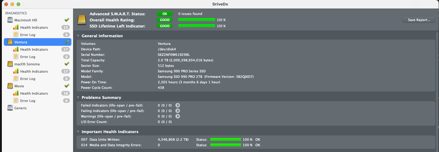

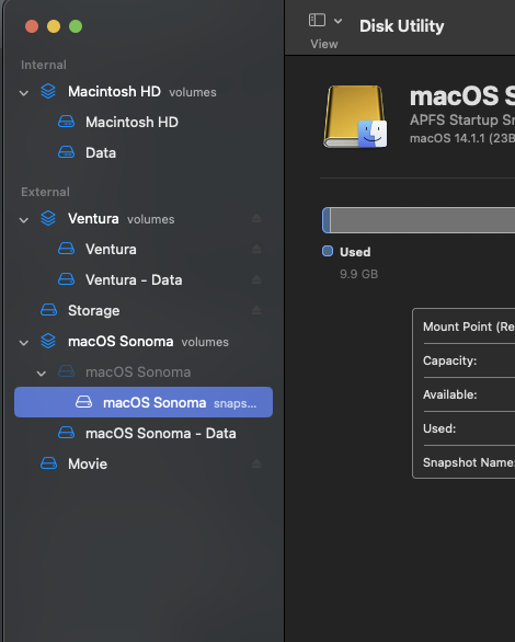

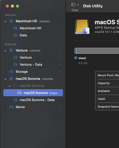

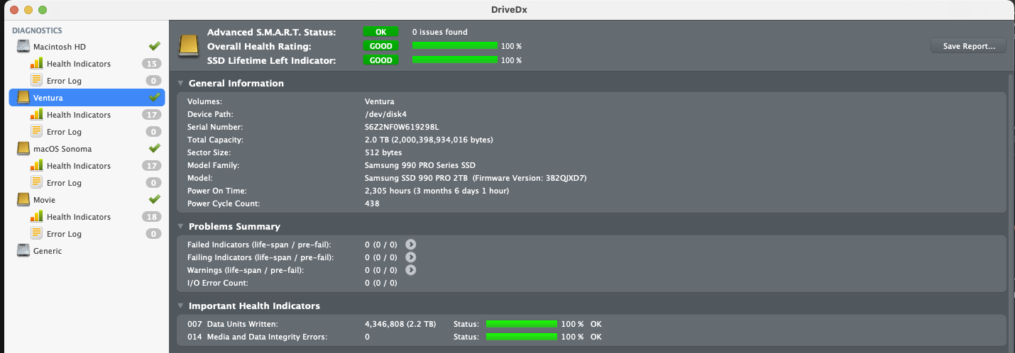

I boot my Mac Studio M2 externally for Ventura and Sonoma on 2 x Samsung 990 Pro with Acacias TB4 enclosures with no issues. Sleep/Wake, video editing, etc all works with no issues.
