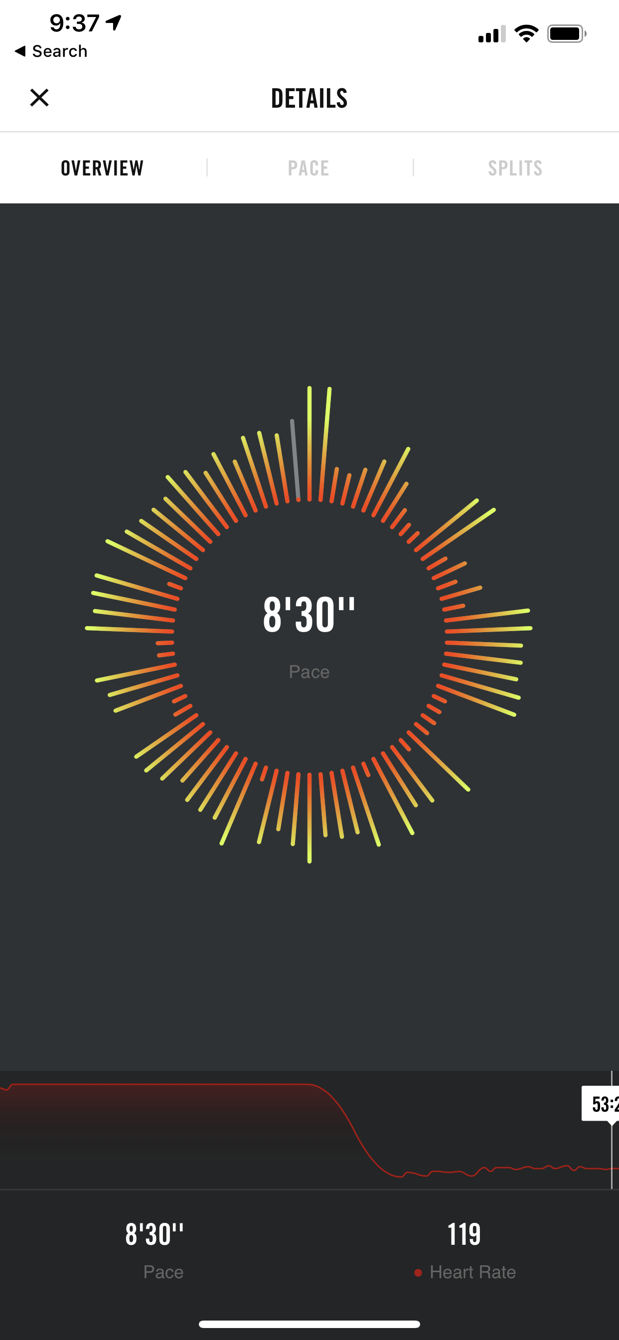

This happens to me at least a couple times a week. I’ll start a workout and the optical heart rate sensor reports a heart rate of 210, sometimes for an extended period. It was just an easy slow workout (run), the second half is accurate. This happen to anyone else?

I know the readings I’m seeing are wrong (and presumably yours to). I just wonder if that’s a general bug in the watch, or I might have a defective one.
Often when I start a workout it takes a few minutes for the heart rate to get an accurate lock on me, but I’ve seen the 210 thing more than a couple times and funny enough it’s usually on my slower runs. I’ve been wondering if it might be picking up my cadence or something. I also know that some skin types etc don’t work as well with optical hr devices. Sometimes my garmin can be flaky to. Maybe it’s just the nature of the technology.

I also have a garmin fenix, if I wear that at the same time it shows a normal HR for the exercise, not 210.
I suggest the watch is too lose, so light peeps in between the watch and your skin. This always leads to very high rates, especially on the treadmill when you move you arm - wrist - quite forcefull and the space between watch and skin varies.
