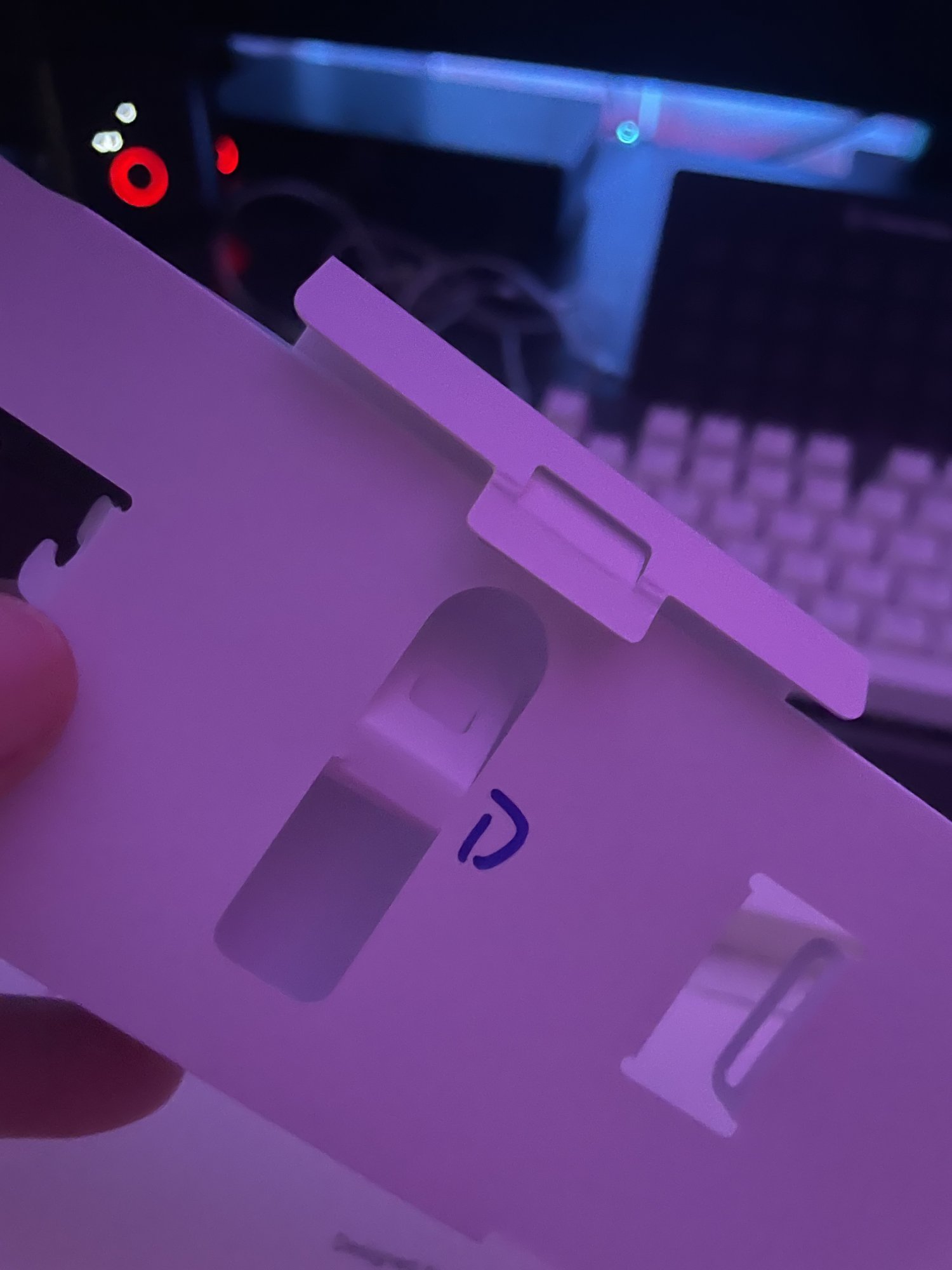

Same issue over here.
- no LED on magsafe cable
- doesn't charge via magsafe (USB-C is good)
Apple is going to send me a replacement cable.
While unboxing there was something odd. A handwritten "D" on the Paper magsafe case. See Screenshot:
Does seem like D for Defective, and it may have just went out of Quality Control somehow. Other poster should report if they have a similar alphabet on their MagSafe cable package.
