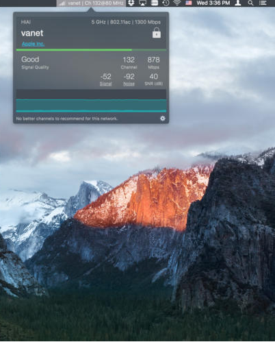

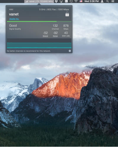

You might also try manually setting the router's radio channel number manually instead of having it autoselect. Not sure why, but everything on my 5-GHz band is trouble free when set to 161. A nifty little Mac app called WiFi Signal will suggest the channel number with the clearest signal after running in the background for a couple days.
