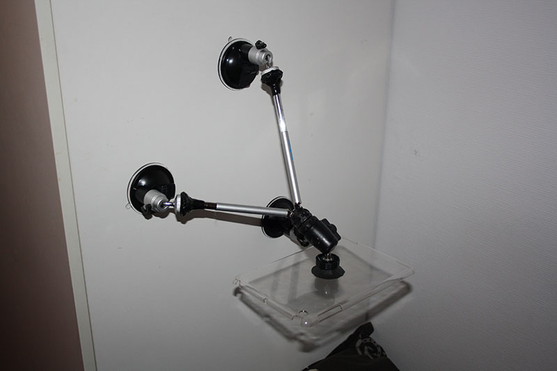

On top of that, I have an entire accessory system based around tripod screws and nuts. I essentially slap tripod nuts and screws onto everything, and then get a modular system. For instance, I have a cheap car holder with a tripod screw glued to the underside of my desk. At the end of this is (currently) a very ugly (but functional) holder for the iPad mini + case combo I have on it. I can unscrew that holder and use it for other things, or I can screw on a holder for my phone instead.
I have more that works on the same system, but I'm going to redo part of it, so I'm holding off on it so far. In the meanwhile, this is an older, failed prototype of what I'm making now:

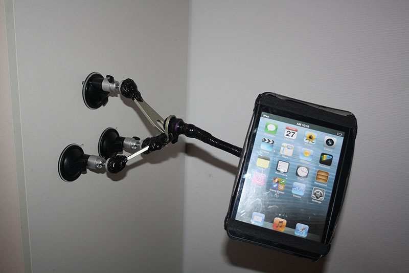

This is from stress testing the new version of my ultra suction mount. In the pic it holds the dummy ipad mini I got off eBay to stand in for the real one for DIY projects like this.

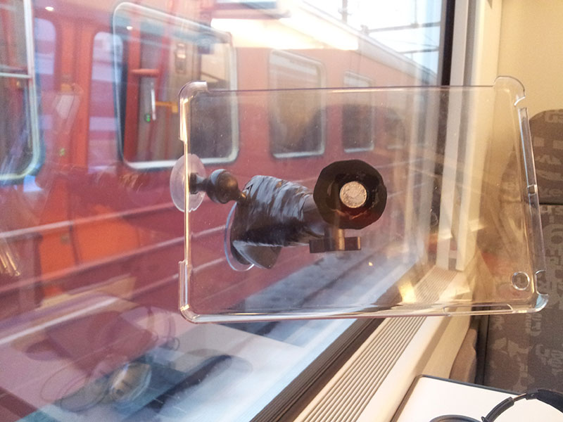

Total parts cost on this is less than $15, not counting the fact that I can take it apart at the tripod nut/screw joints and configure it into other accessories (so the practical cost is much less). The iPad holder at the end in this pic is a semi-temporary one that's designed to fit my mini with the current case combo on it. Making a tripod system holder for a naked mini is much easier. One like that can be seen in this picture from the train a couple of months ago:

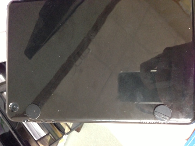

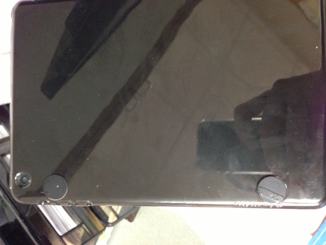

Pics? Sugru (the rubber material mentioned in that original post) is really what made it easy for me to do that mod
Ya I just bought some a little while ago to try out on my $1.99 case. For this one, I took out a couple of round magnets from an old cheap leather case I had, put a little gorilla glue then attached them to the back of my case. Gets the job done, but doesn't look all too great....lol
Yeah it's a bit more subtle if you both have smaller magnets (5x1mm are great) and embed them in the cover. Great thing about $2 covers is that you can experiment 😀
