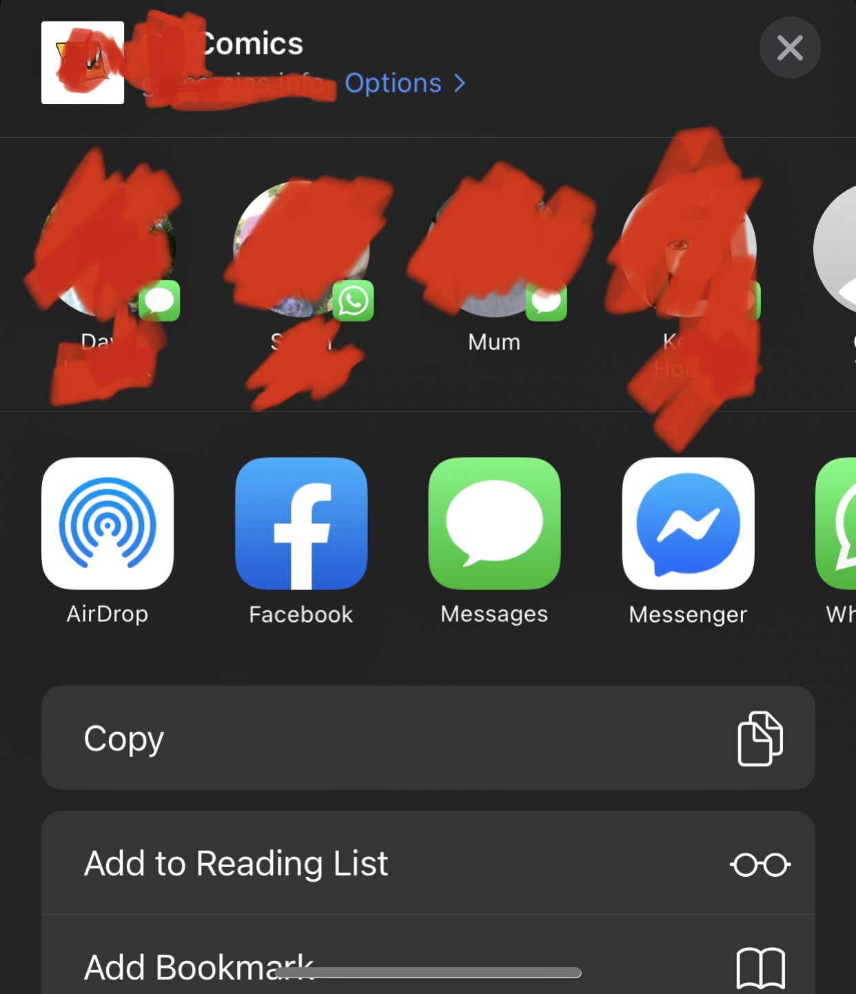

Mine suddenly finished shortly before installing the iOS 14.2 Beta 3 update.
I didn’t make any changes or mess with any settings...they just went away. Siri Suggestions are still turned on.
Weird.

I’m having this problem also. The weird thing is, they didn’t disappear after upgrading to iOS 14 and they were still there after 14.0.1. They disappeared overnight out of nowhere and still haven’t come back after 14.1.
I had this problem too and hoped it would go away after I got my new 12 Pro and setup it up from my old phone. But the problem unfortunately carried over from my 11 Pro.
I tried the usual thing of toggling sharing suggestions on and off but it didn’t help. I even went so far as to disable Siri completely and set it up again.
Then I did some poking around and found something. If you scroll down past all the main settings in “Siri & Search” you’ll come to settings you can fine tune on an app by app level. I went into my messages settings and the setting “learn from this app” was turned off for some reason. JUST on my Messages app, all others had it on. I flipped this back on and almost immediately I started getting sharing sheet suggestions again.
I am posting this discovery in hopes that it helps others too.

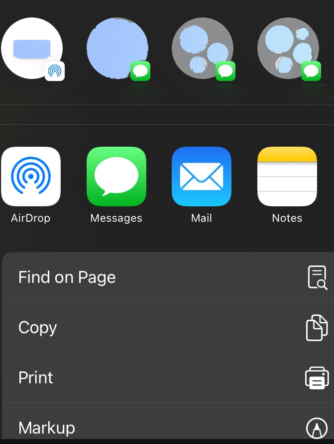

Today it happened again , iPad iOS 18.4.1. No idea what triggered it.
After reading here and there I couldn't solve it, every settings is as it should be.
Then I had the idea to Pin one link at random from my messages contacts, and they are back 🙂IMG_BC4E420E1A17-1.jpeg
