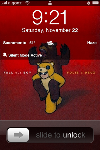

Mine is working like a gem. and I love bitesms. Its landscape and i can use my at&t text messages.
