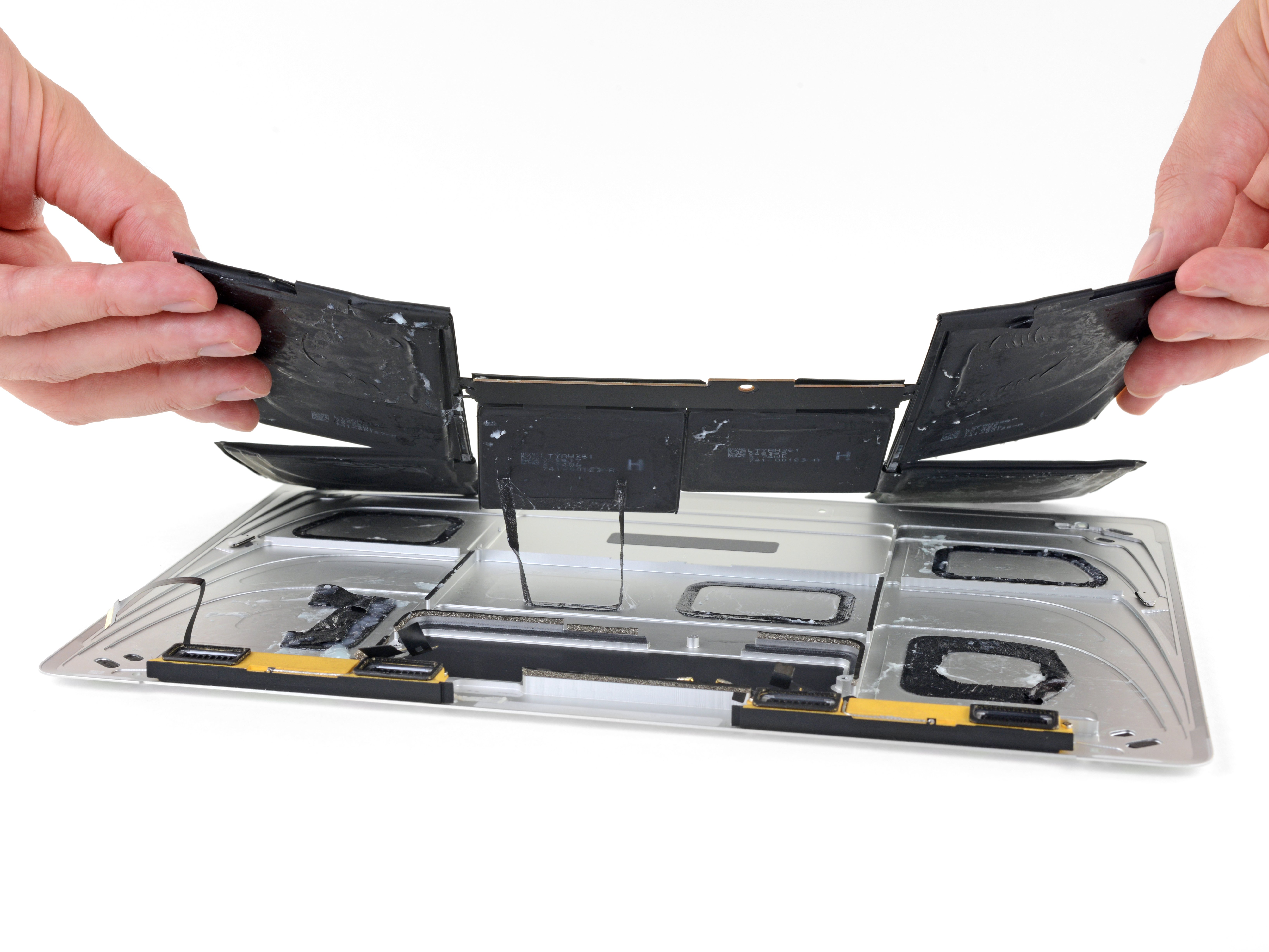

I have managed to find an exact new Battery for this model replacement - I am just wondering if anyone's every attempted with this specific 12" Macbook 2015 to replace their own battery and at was ease/or difficulty was it.
My technical levels are sort of higher than average, so simply wondering could it be self done or even advised to do so.

The battery for that model looks difficult to replace. Not sure if I would try it.
Friend of mine did years ago on a 2015 - it's annoying but doable. Removing the adhesive is the biggest pain, but the rMB is a little easier than the same-era Pros since the keyboard isn't under the battery.
It's relatively straightforward using the ifixit guide, but the repair is a bit of a pain in the ass. The only downside is the amount of adhesive that is used on the battery. It takes forever to undo the glue, and it took quite a bit of isopropyl + scraping away at the adhesive to finally undo the battery. By far, it's the worst repair to do on this little machine and I've done every repair outside of swapping out the keyboard.
No kidding. It's a 102-step layer-cake dissassembly guide (which omits the 51 steps of reassemby) including gems such as "...you'll apply liquid adhesive remover along the edges of the battery cells. Keeping part of the MacBook elevated will help the adhesive remover flow underneath the battery...."

The only downside is the amount of adhesive that is used on the battery....
No, the major downside is the risk of permanently destroying your small-form-factor intel-chip laptop of a type you cannot buy anymore. Even with a totally dead battery, it's still a more ergonomic pseudo MacMini with a built-in screen, and thus worth hanging onto.
Obviously you remove the logic board before squirting isopropyl everywhere. Also, ifixit has the battery for $119 with a full set of tools and everything needed to complete the repair. Not hard, just annoying with the amount of adhesive. And
