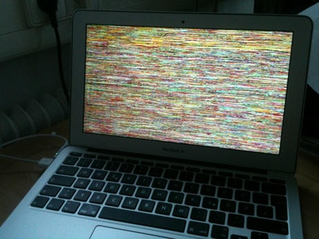

is the external monitor (tv) connected to your MBA when you wake it from sleep? I leave my 2012 MBA connected to a TV pretty much all the time and only put it to sleep. When I wake the MBA up while connected to the TV I see what looks like static on the MBA screen for just a split second.
Kind of like this:
(not my MBA, found the pic thru google.)
I've never noticed anything like that when I happen to not have my MBA connected to an external display.

That's it! And it also happens even when I don't connect MBA to a TV.🙁

well, perhaps I was mistaken earlier - just got on my MBA and didn't see that static screen flash up. Tried reconnecting my tv to MBA a few times, sleeping and waking the MBA with and without tv connected. Must not do it every time. I know I have seen that "static" though.....
