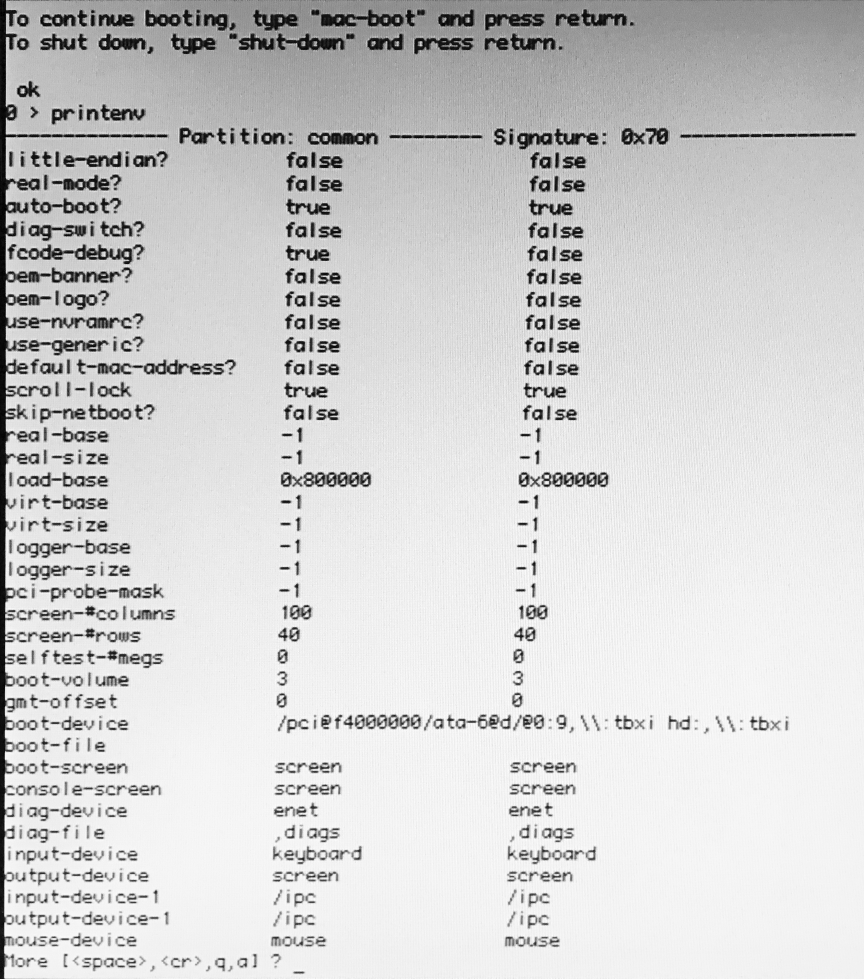

I need someone to test how to recover from a bad Open Firmware NVRAM value on a G4 Mac Mini.
No risk, just testing how to recover from a bad NVRAM value.
All you have to do is enter OF( Command+OPT+O+F at boot) set some non harmful value to something other than the default value like focde-debug? to true than shut-down and power up holding the power button, keep holding, hear the programers tone, keep holding, hear the boot chime, the system should enter OF with the defaults loaded.

setenv fcode-debug? true
shut-down
Power the system holding the power button on the Mini until the system enters OF and:
Code:
printenv

Yes I need to know if holding the power button loads OF with the defaults loaded.
I put a 7448 into a mini but for OSX to run there is a powerlogix nvram script that tries to fix apple's shenanigans. Unfortunately this script bricks the mini and in order to recover I had to hold the power button to boot into OF where I could clear the script. The script is still there until I clear it in OF, so holding the button boots into OF but does not automatically clear the settings.
If you recall I also used this method to clear the DFS stuff that I tried for you.
Ok, that's what I needed to know, it does in fact boot with the defaults loaded. It does not clear nvram settings, that is as it should be, it just loads the defaults so you can clear the nvram via the command line in OF.
