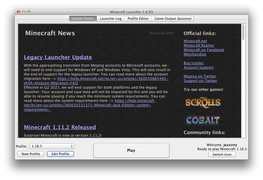

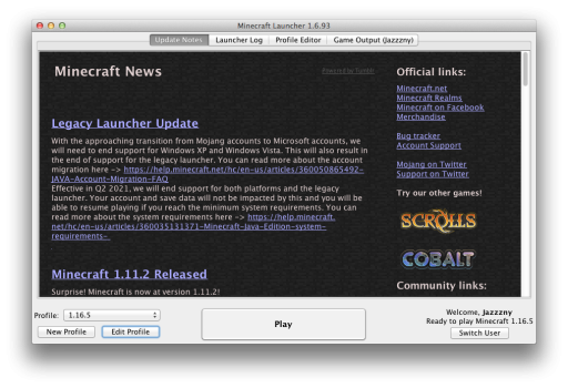

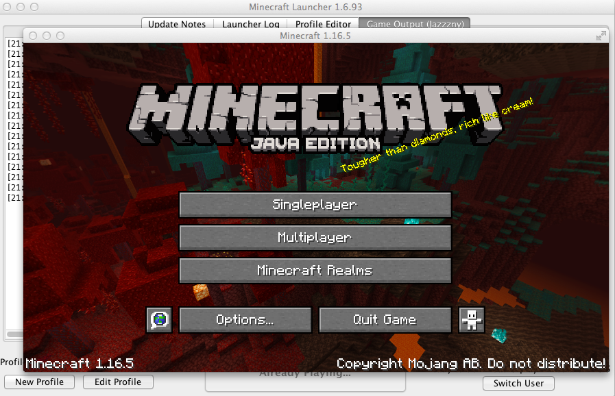

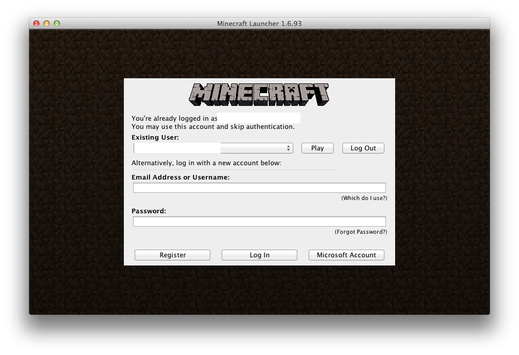

Hello guys, just stumbled across this thread.
The only launcher that works correctly on 10.9 without any real issues is the legacy .jar launcher paired with Java 8, which you may be familiar with if you've played Minecraft before ~2016. However, the first roadblock that you'll come across is the lack of MSA authentication. Fortunately, someone has created scripts to add Microsoft Authentication to the legacy launcher: https://github.com/NepNep21/MSA4Legacy
I've also attached the patched launcher as a file, but feel free to run the scripts manually from GitHub.
Once logged in through MSA Authentication, you can run any version of Minecraft up to and including 1.16.5. 1.17+ won't run as Mojang bumped up the required Java version to 17, which I haven't been able to get running, even with wowfunhappy's excellent dylib stubbing guide.
I've done some brief testing with the MSA Authentication patches, and everything seems to be working correctly. I've even been able to play on some major servers such as Hypixel.
Enjoy!
...huh, that sucks that Java 17 won't run. I feel like unix-y things tend to be possible to build.
MacPorts's openjdk17 port is indeed reported to fail on everything below Sierra: https://ports.macports.org/port/openjdk17/
But at a quick glance, it's not clear that anyone has actually tried to get it working on older OS's. It could potentially be as simple as adding the LegacySupport portgroup, or compiling with macports-libcxx.
Reactions: PowerHarryG4

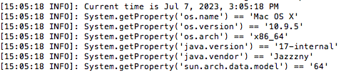

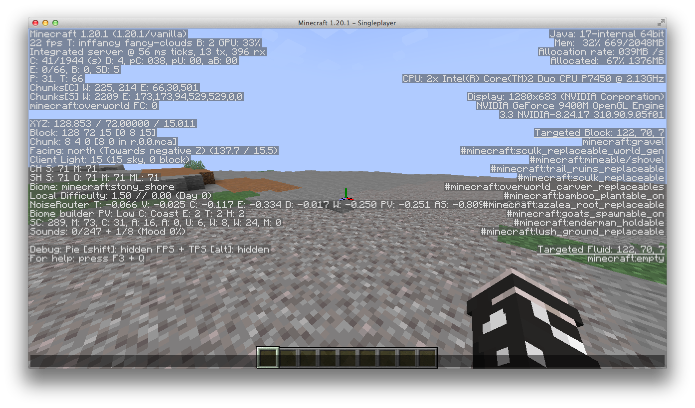

I can't believe I'm saying this, but I by adding a ton of patches to Java 17 and building it on 10.12, I managed to get JAVA 17 FULLY WORKING ON MAVERICKS!! This means that Minecraft is officially back on 10.9-10.11!!
I think this deserves its own post, so I'll make one about my custom Java build.
