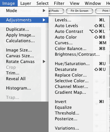

The range of post-modification also depends what kind of images you shoot. Do you use RAW or just simple JPEG?
With RAW you can modify much more than with a simple JPEG, as it gives your more freedom to change the white balance, exposure, black/white levels, ..... . With JPEG you have no such information left in your images and just rely on the filters and image adjustment tools.
via http://www.google.com/search?client=safari&rls=en-us&q=photoshop+image+adjustments&ie=UTF-8&oe=UTF-8
