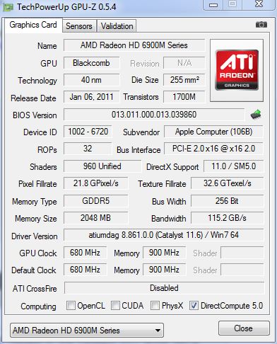

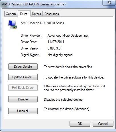

Can you tell me what driver version you are currently running in Bootcamp (the actual driver version, NOT the Catalyst Control Version). I'm not in from of my iMac at the moment, however the driver I originally had installed in Bootcamp was dated sometime in January 2011 but I managed to update them to a more recent version which are dated May 2011 - when I get home this evening I can post what driver version I'm currently running for your reference.
Currently running:
Driver Version 8.861.0.0
Driver Date: 24/05/11
I believe these are the most up-to-date ATI driver for the 6970 GPU, anyone know any different?

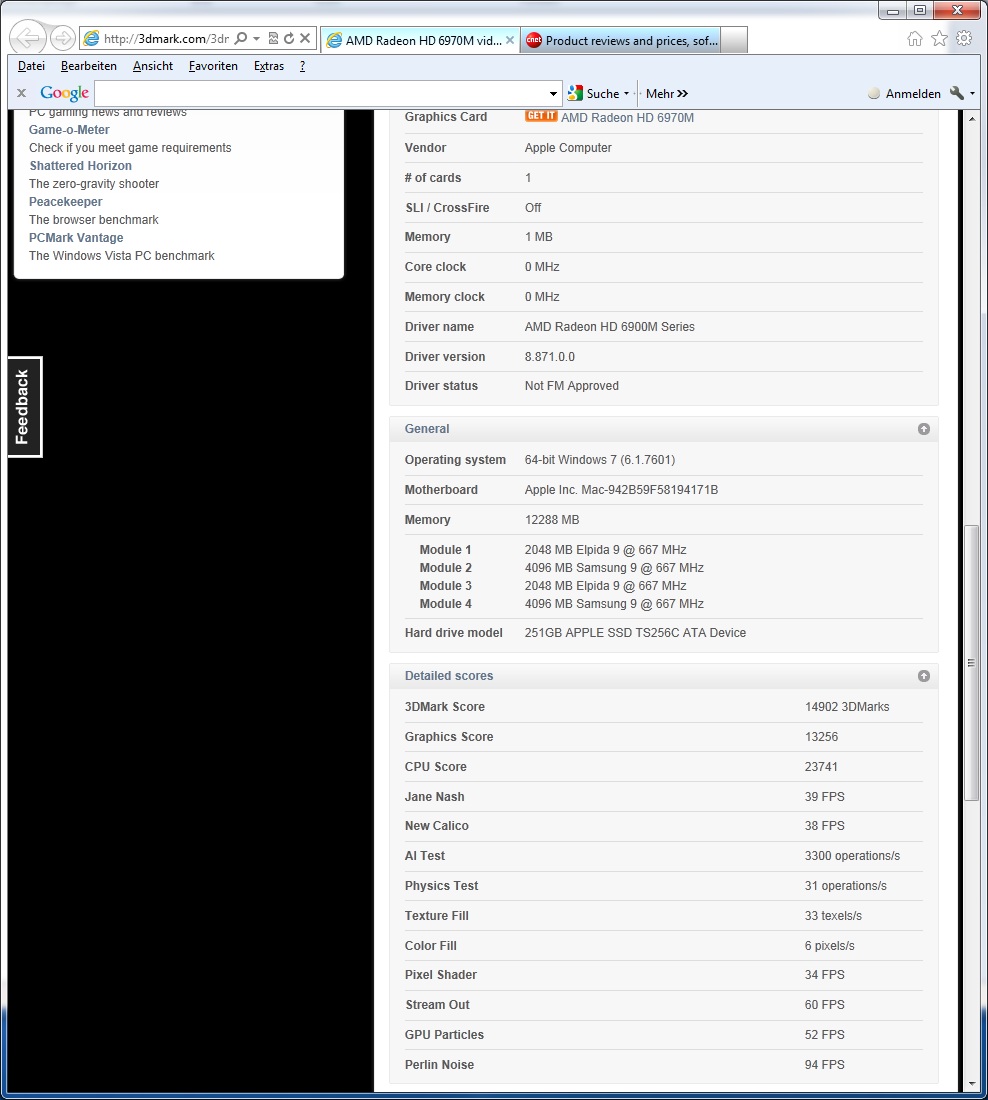

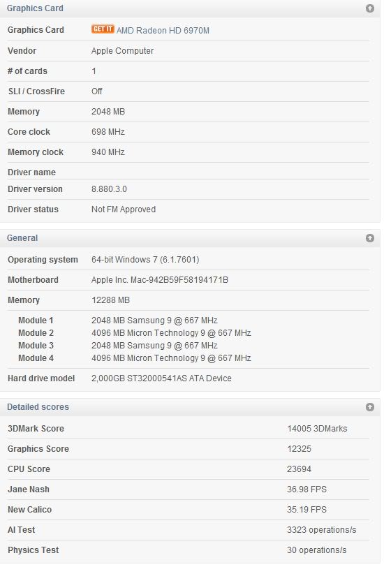

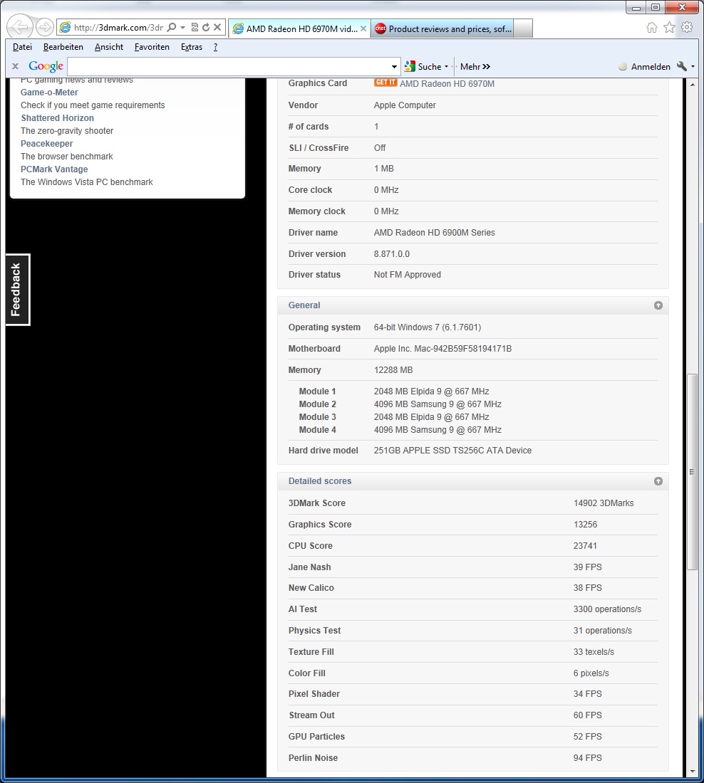

For me this drivers are working fine. I received a 3D Mark Vantage score of 14.900. (I overclocked also the 6970M GPU)

The Benchmark was Futuremark 3DMark Vantage, the newest version from the website. Then i only choose the default Benchmark, without changing anything. What was your Score?

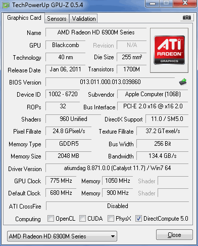

I only would overclock the GPU if you want to play new Games etc.
Here you find all Steps to overclock the 6970:
https://forums.macrumors.com/threads/1156496/
I played yesterday four hours Witcher 2 (res: 1080p, high details, ~40 FPS, looks stunning) and had no freeze or something else. After this 4 hours the GPU had a Temp. of 80C, after 60 seconds it went back to 60C.

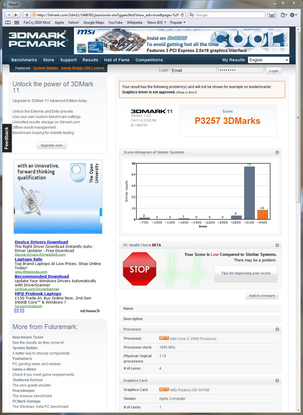

Hi Toddi

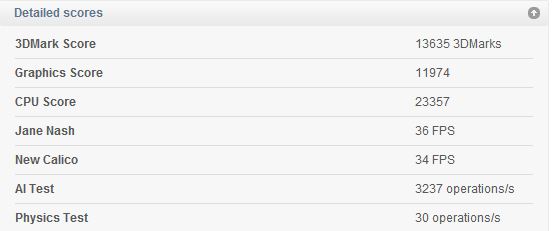

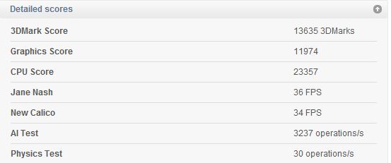

Well I Benchmarked with Futuremark 3DMark Vantage program and get the result P3257 (see screen grab)
I'm a bit confused by this mark, in the respect of what it means and how it relates to your mark of 14.900 - any thoughts?

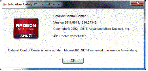

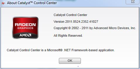

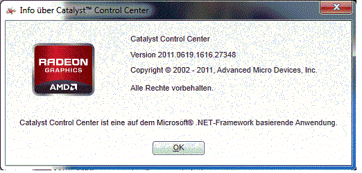

Also I downloaded the modded drivers from the link you provided but again I'm somewhat confused as there seems to be absolutely loads of files to choose from. I already have the Catalyst Control Centre installed but I did re-install it again from the downloaded files - however my driver is still 8.861.0.0. Here's a screen grab of the "About Catalyst Control Centre":
Hmmmmm, seem to be getting myself confused on this one so any guidance you can offer would be great.

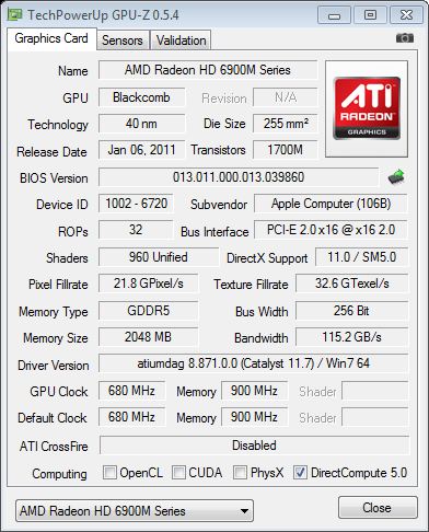

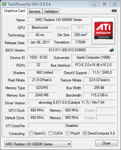

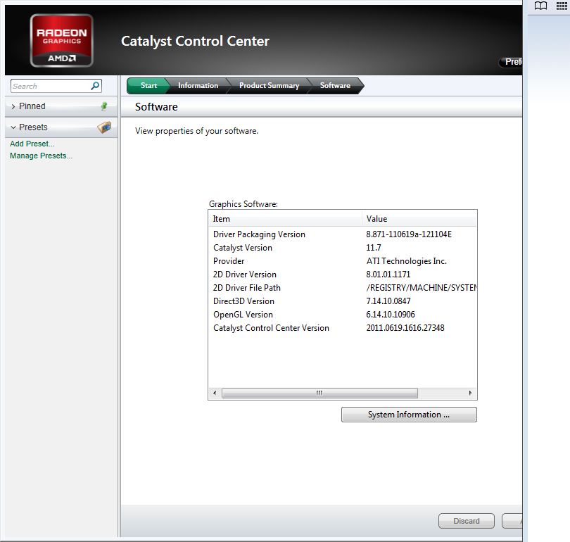

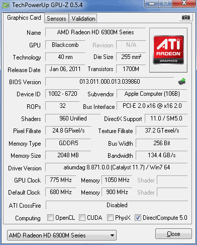

Eureka!! Have now got it sorted - I decided to uninstall everything ATI related and start over again - I am now running the modded driver 8.871.0.0 and Catalyst Controller 11.7.
Also Bench marked the GPU using the correct program this time and scored 13635 which seems comparable to your score considering I haven't overclocked the GPU (think I'll hold off on that for the time being). If you ever get a chance would be interested to see your detailed scores from the 3D Mark Advantage test.
