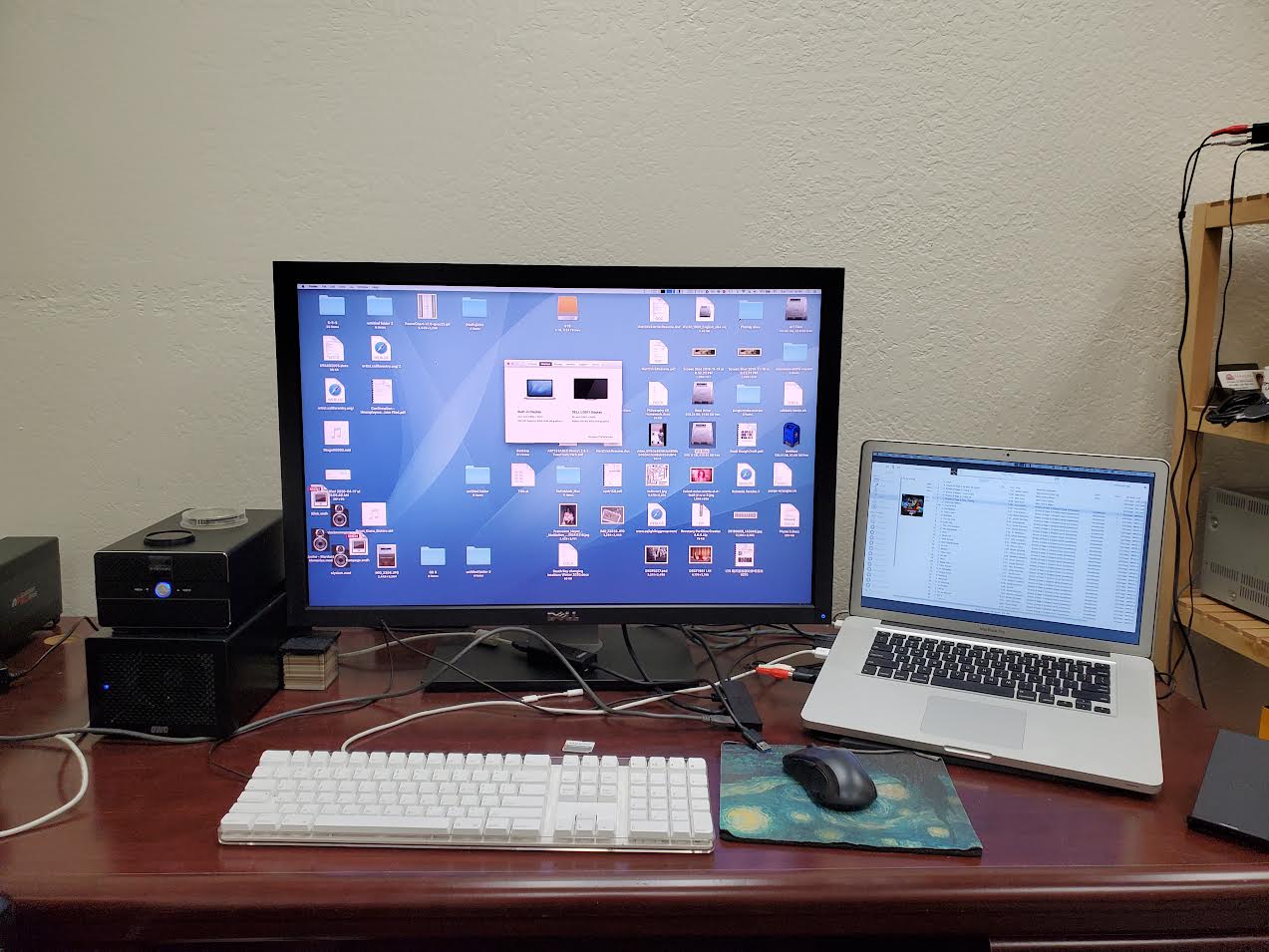

In the past I had made an eGPU from an OWC Helios Thunderbolt 2 PCIe card adapter. This adapter is NOT recommended or rated for graphics cards, but I did it anyways. This was for my studio's 2012 MBP with only 512MB of VRAM and it really struggled under Mojave.
IIRC the power supply was only rated at 90W but it worked perfectly with a cheap AMD WX4100 4GB I found locally.
Now that I know that this enclosure can only take PCIe power + 1x 6 Pin I plan to swap out my RX 580 for a WX7100 since 8GB seems to be my current cushy spot. I don't need the GPU processing power as much the vram according to my current workflow.
Since this expansion allows for 3x slots I plan to occupy the others with my BlackMagic Intensity Pro and SSD cards for fast storage.

I find this solution to be the most streamlined for my needs at the moment. I ultimately need a graphics card, slot for my capture card, and more fast storage. I can easily sell my current enclosures, dock and eGPU setup to offset part of the price.
My current set up is a rat's nest of cables and AC adapters. I would like a completely self-contained setup like my old Mac Pro but with a smaller footprint.
