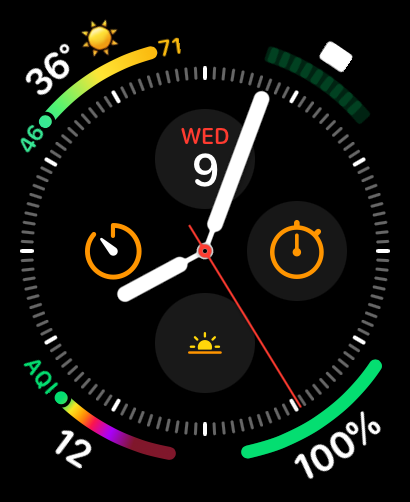

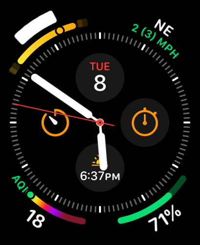

Since my last update I have been having a problem when I try to use Top Left or Top Right for either temp or wind speed. I thought it might just be the Weather app, but the same thing happens when I try to use Carrot. The SubDial versions of wind speed or temp work fine on other screens.
Here are a couple screen shots of what Carrot looks like when there is a problem. Any ideas? Thanks!

Yeah, it never is that simple. I FINALLY got mine working by a workaround. I have to faces I like to have the temp and wind as shown in the original photos. These are Wayfinder and Infograph. While this sounds odd, I think was happening was that it would not let two faces have the wind and temp in the same location. I thought I had it fixed, but then when I changed faces it came back. What finally made it stable for me was to use the temp and wind from the Weather app on one face and use the temp and wind from the Carrot app on the other face. (Never had a problem on any of the modular faces)
