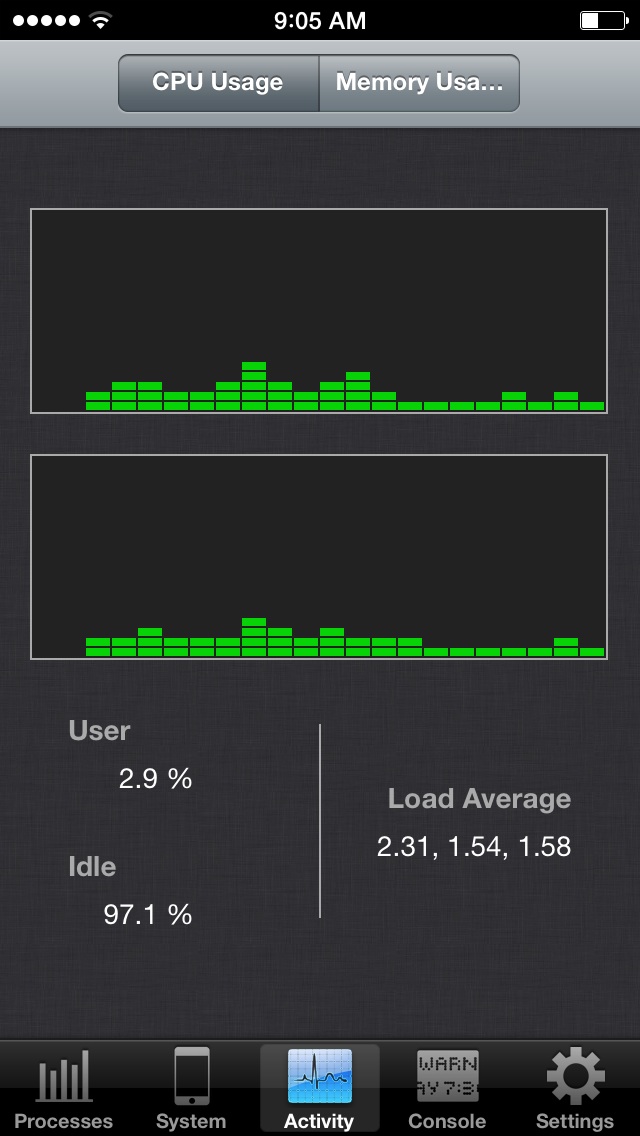

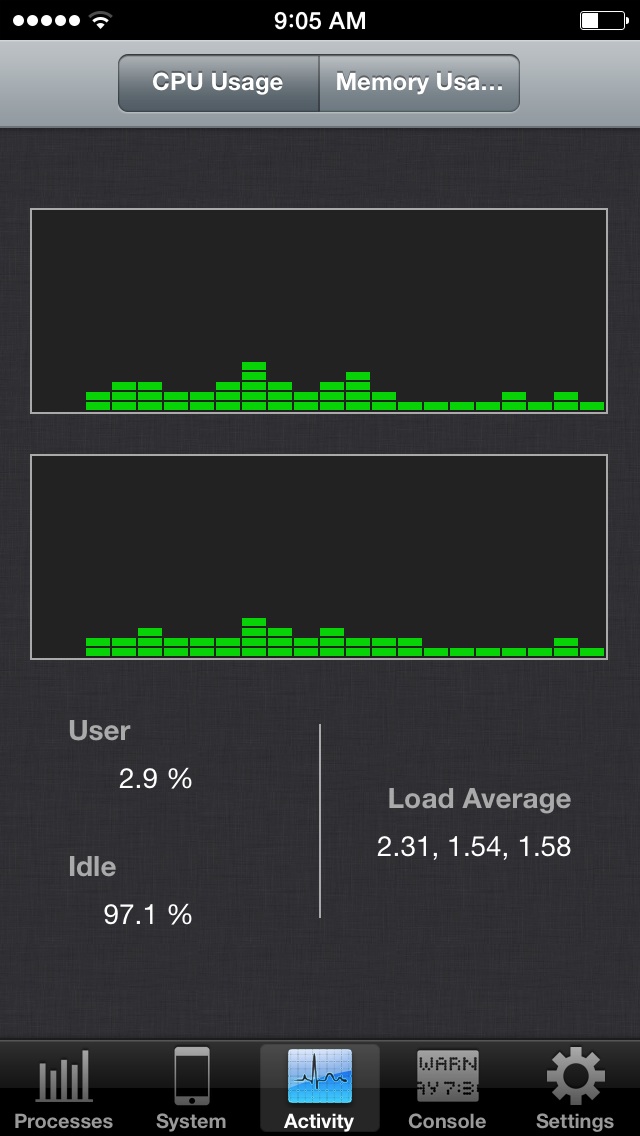

What do you use to check the processor load?
I use something called Appswitch from the App Store. When idle it should bounce between 1-7% every second. If it's higher some tweak is causing a process to run wild.
