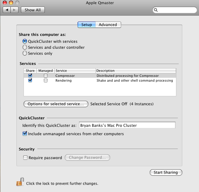

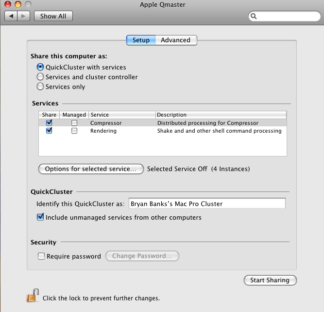

I'm not sure about turning it on after the install as I've tried just about every configuration of the Qmaster Pref Pane and had it not work. I've attached a screenshot of how my Qmaster is set up.
And when exporting, just choose "This Computer" with "use unmanaged resources".
