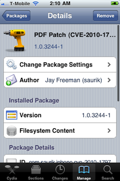

Oh no! Am I being mega stupid??? 🙄😱
This is what it looks like in Cydia. 🙂
Picture came from iClarified.
http://www.iclarified.com/entry/index.php?enid=11147

Great thanks so much for clearing that up for me!
