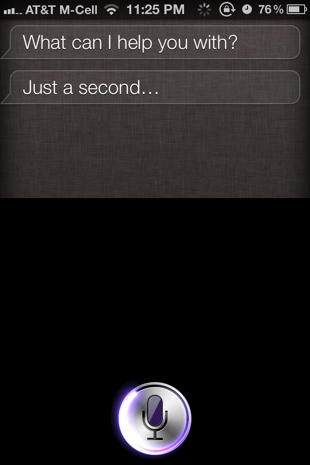

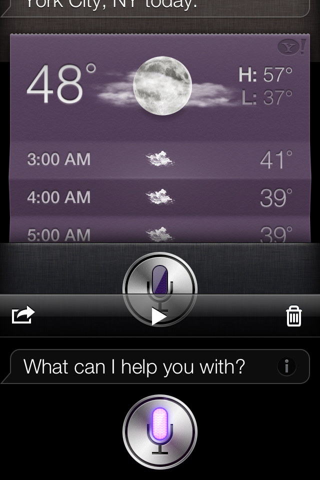

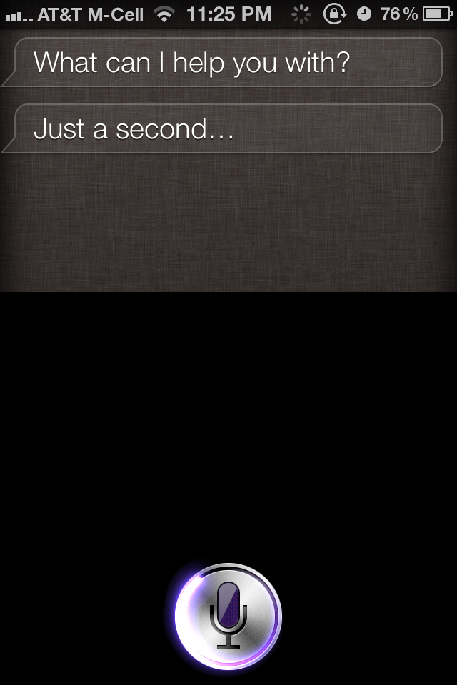

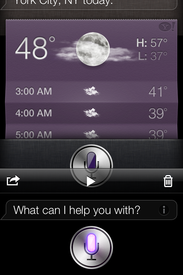

i did this and it worked 🙂 just was hoping you could help me out here... on the siri screen half has the apple default background art for siri but the bottom half is blank, just plain black. can u help me fix this issue? thanks!
Uploaded pics of my issue below 🙂
