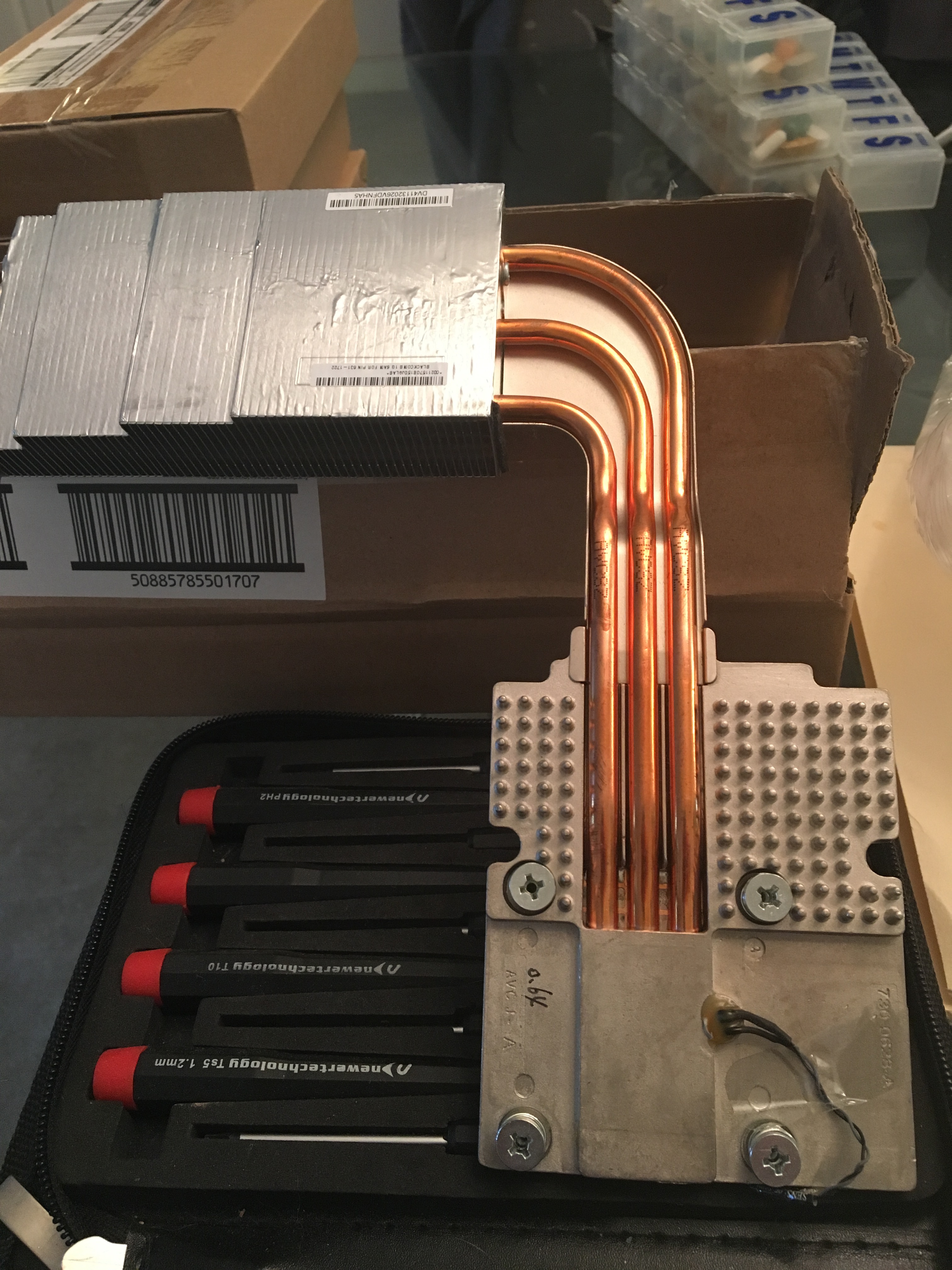

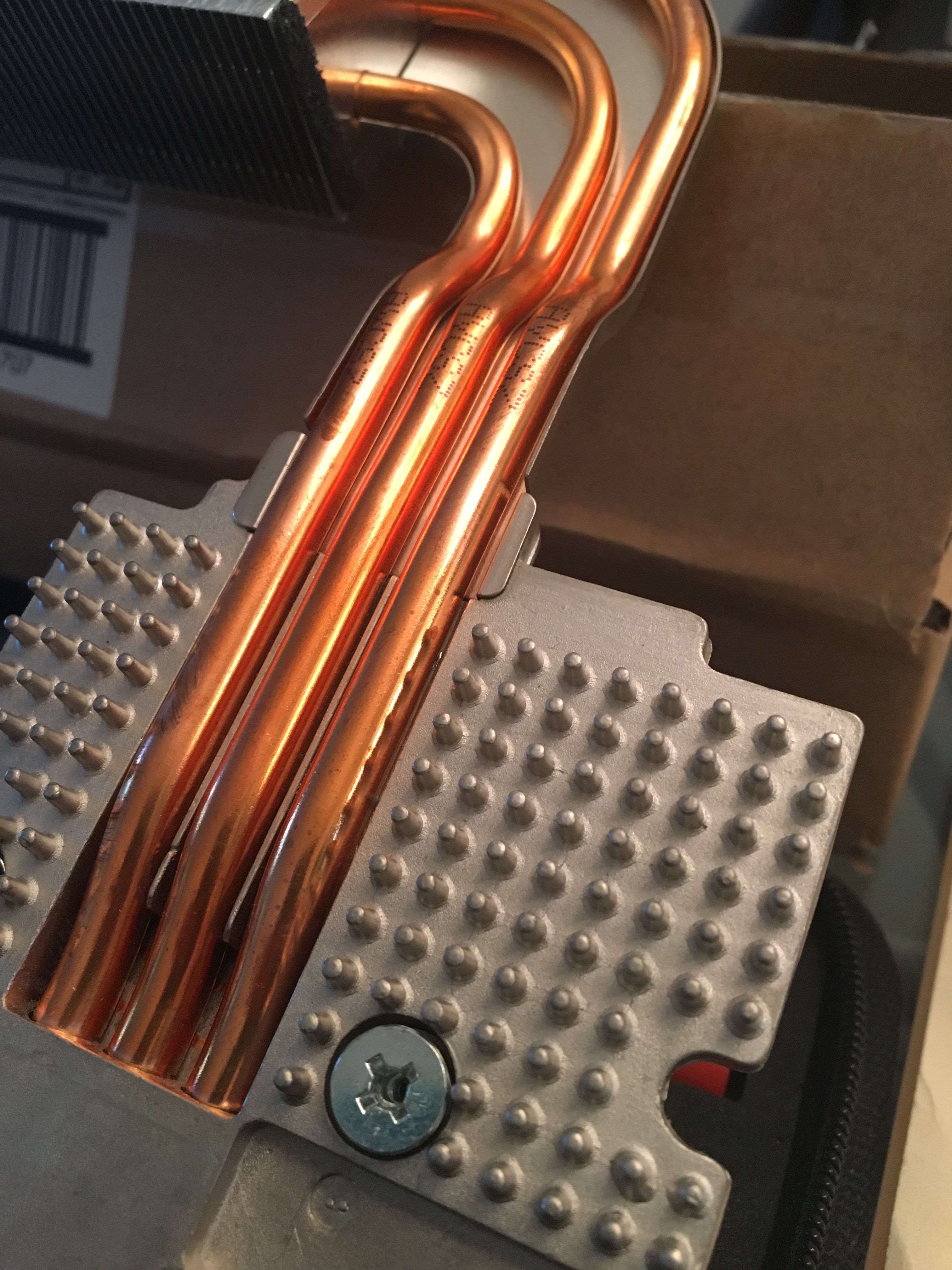

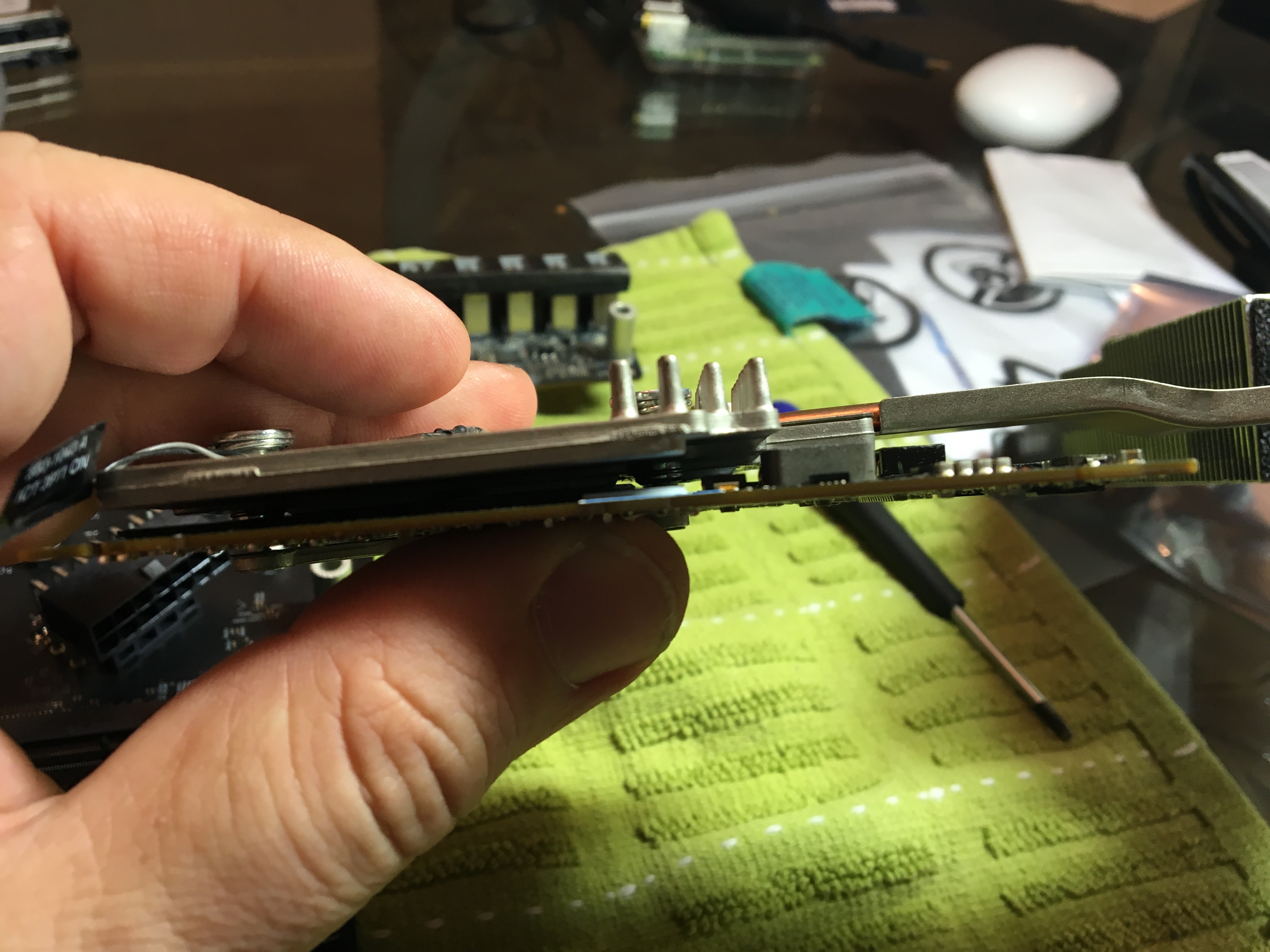

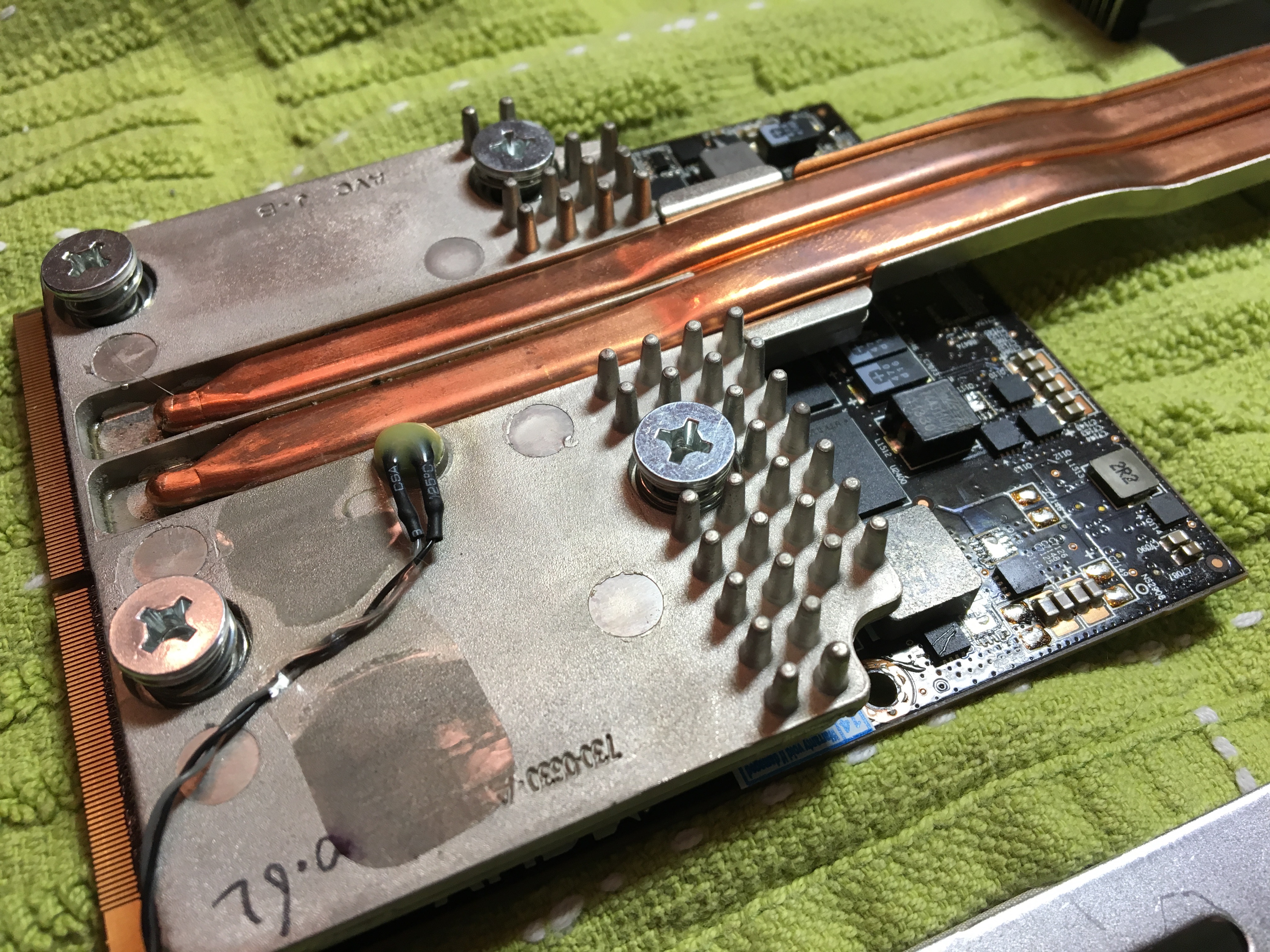

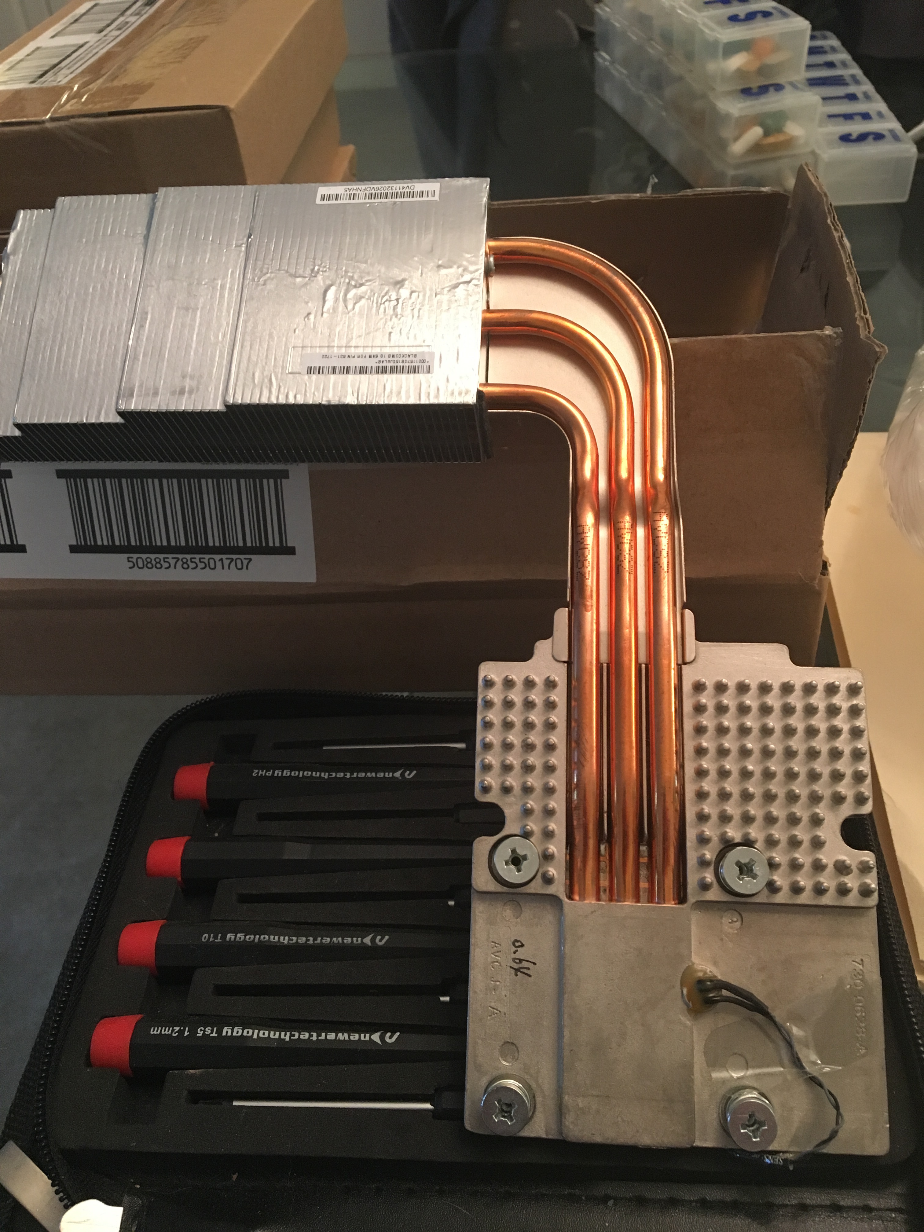

I'm looking all over for this part, since I purchased a 2GB 6970M to replace the 512MB 6770M in my 2011 iMac 27. I see the card selling WITH the 3-pipe heatsink, but not the heatsink itself. Here are pics:

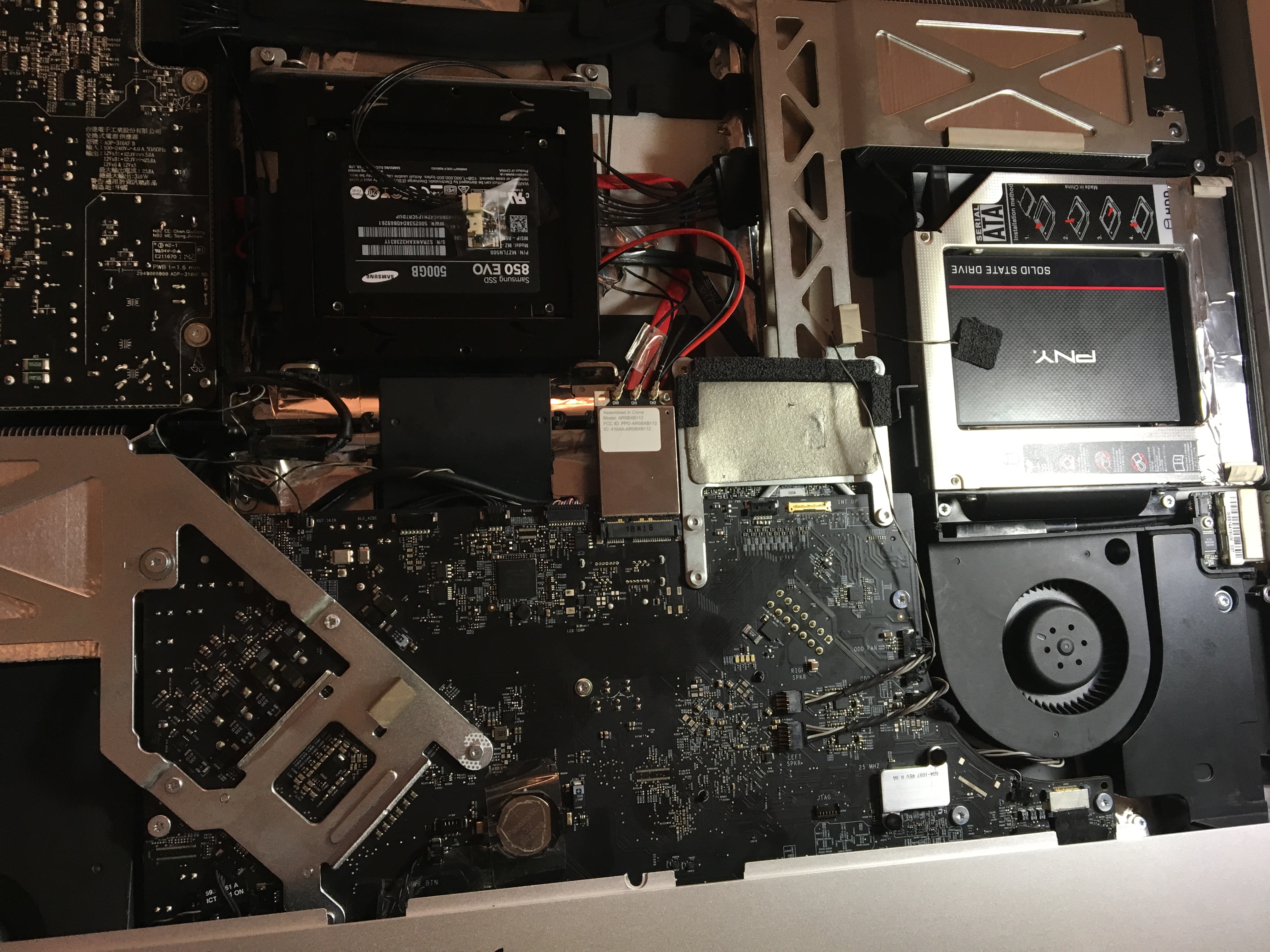

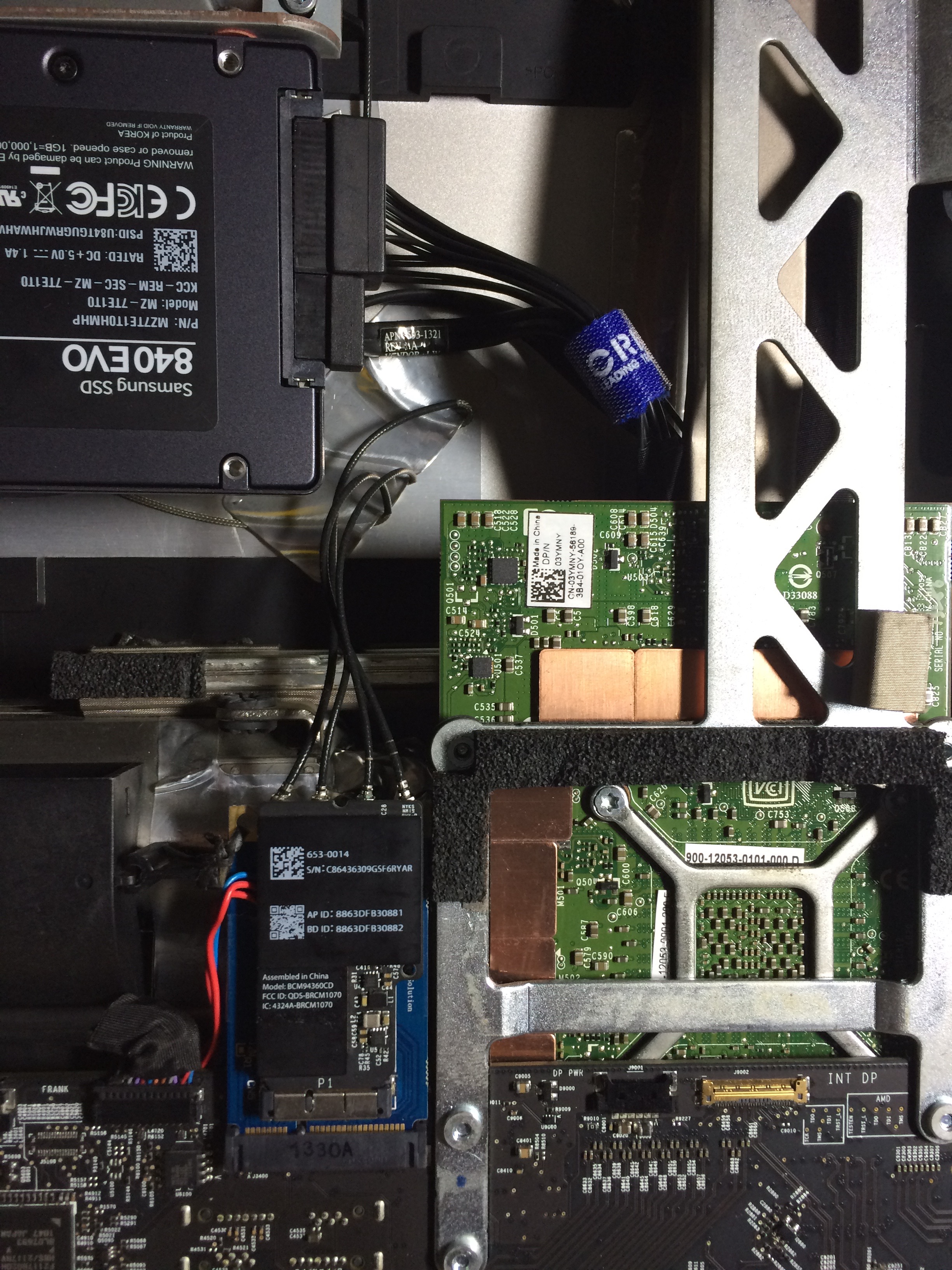

Well, since you asked, I prefer the 2011 models because I can upgrade them easily. I've already put a Core i7-2600S and 2 SATA3 Samsung SSDs in place of the hard disk in RAID0, and still have a 3rd SSD in the DVD bay for VMs and BootCamp. You can't get into the 2012+ iMacs without heat guns and a lot of effort.
As far as the 6970M is concerned, it's the fastest card I can put in the iMac which has boot screen support and multiple monitor support (other MXM cards don't have that compatibility). If you know of a faster card which allows full functionality in a 2011, I'm all ears.

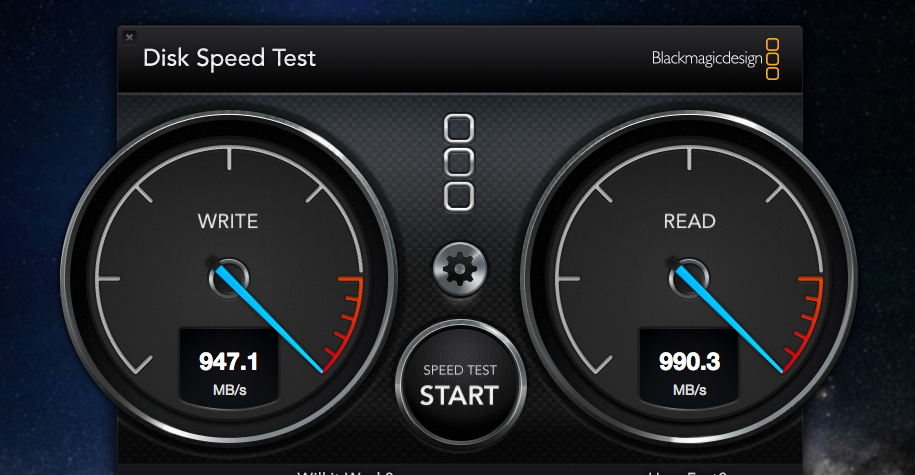

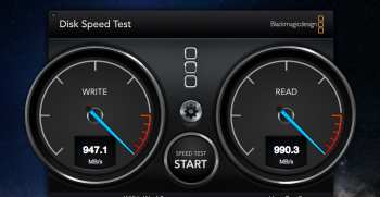

Is it fast enough? Well, it's running 8 cores and the RAID throughput is excellent (see attached).

I appreciate the link! I saw that as well - but I'm looking for the 3-pipe model shown in the original post. Maybe people have heat trouble, I figure, because the 2-pipe heatsink doesn't carry heat away fast enough. If you spot one for sale, please let me know thanks. I've got feelers out to the guys that sell the card + heatsink to see if they have extra 3-pipe models lying around.

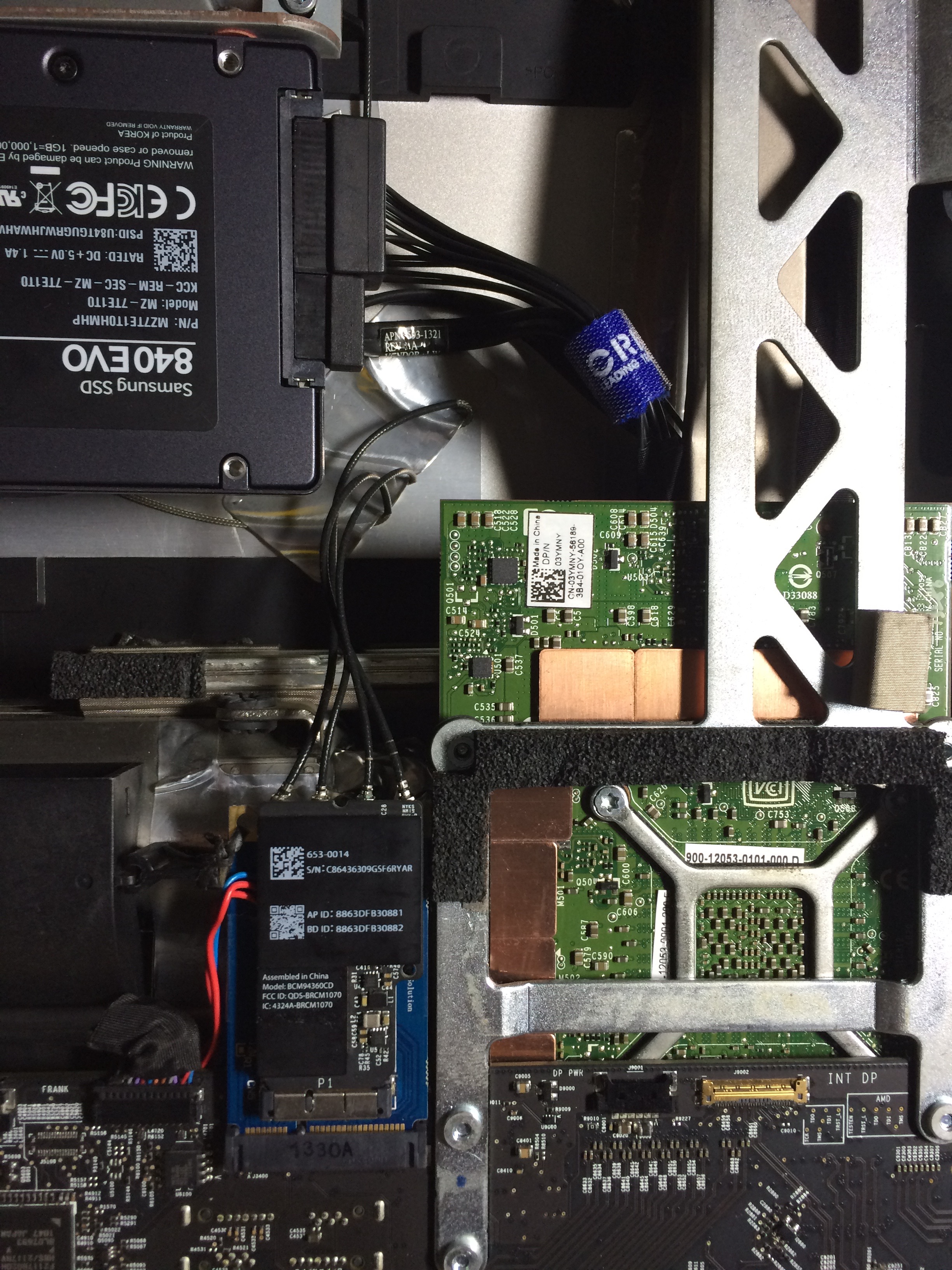

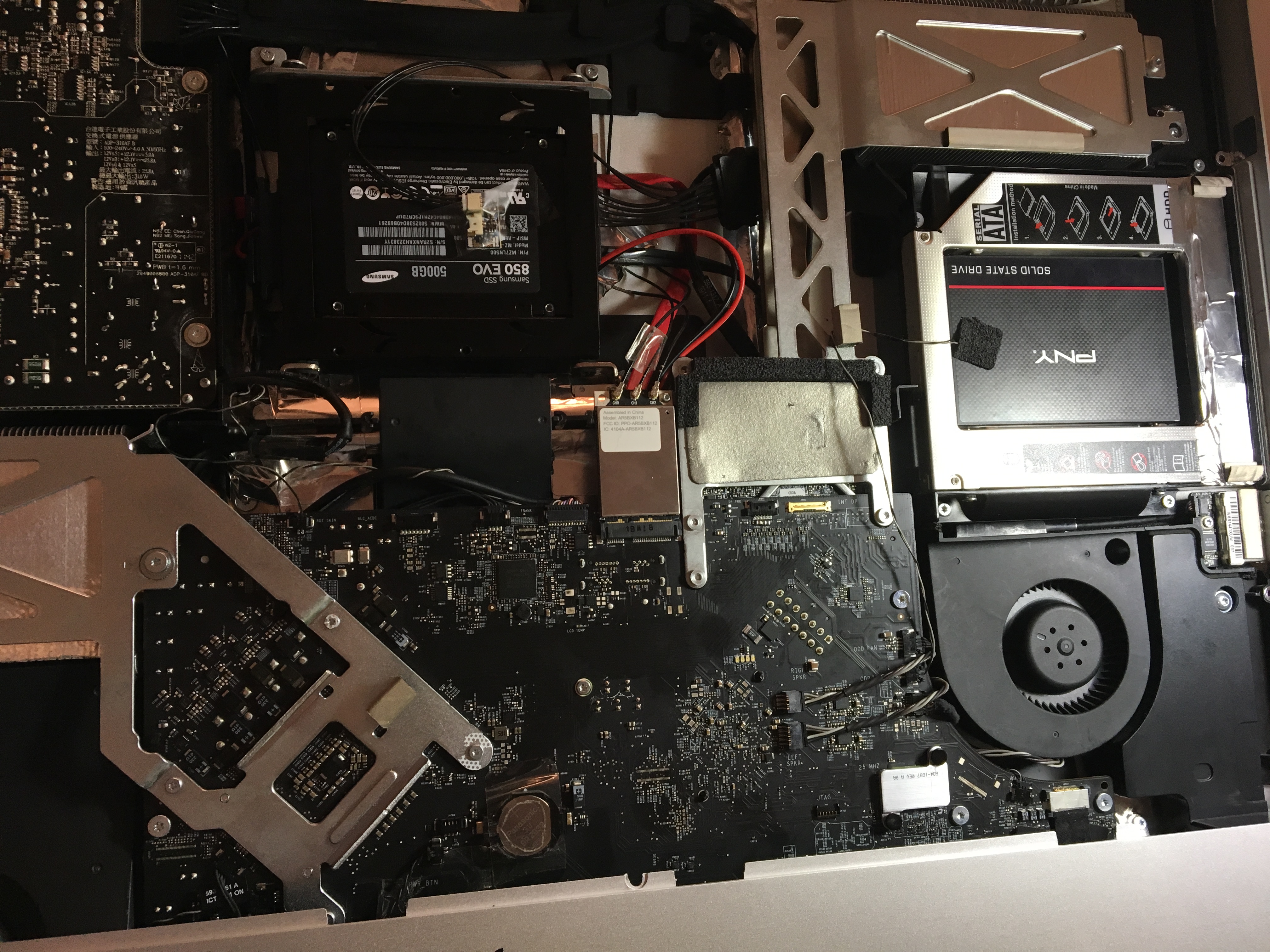

Thanks for your thoughts - I picked the 2011 model because it has Thunderbolt (which allows high speed ports via docks), the ability for 3 internal drives (do the 2012+ models allow this?), and the ease of upgrading the drives, video, etc. with access that doesn't involve glue. Every time you open a 2012+ up, it's another set of adhesive strips - no thanks.
I've already purchased the temp sensor from OWC for the primary SATA3 HD connection, so it's still silent. I understand it's dated tech, but I'm a hardware geek and enjoy getting in there to make it better. The RAID0 numbers already make it current with modern iMacs.

If one HD fails in a RAID0, then yes, the volume is lost - that's why I have an external Time Machine backup. I'd rather have my drives on the internal SATA3 bus - trying to create volumes with a mixture of internal and external devices gets tricky (what if the power goes out on the external?) I'm very happy with my 2011, so if this one died, I'd probably get another one! Or just build another Hackintosh.

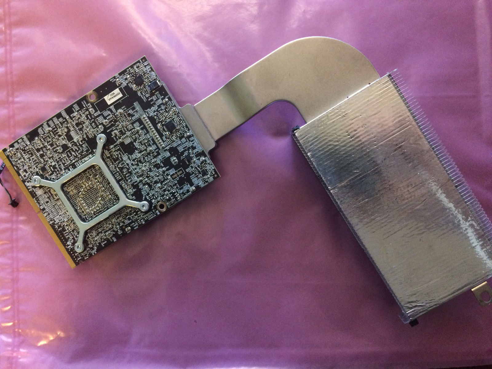

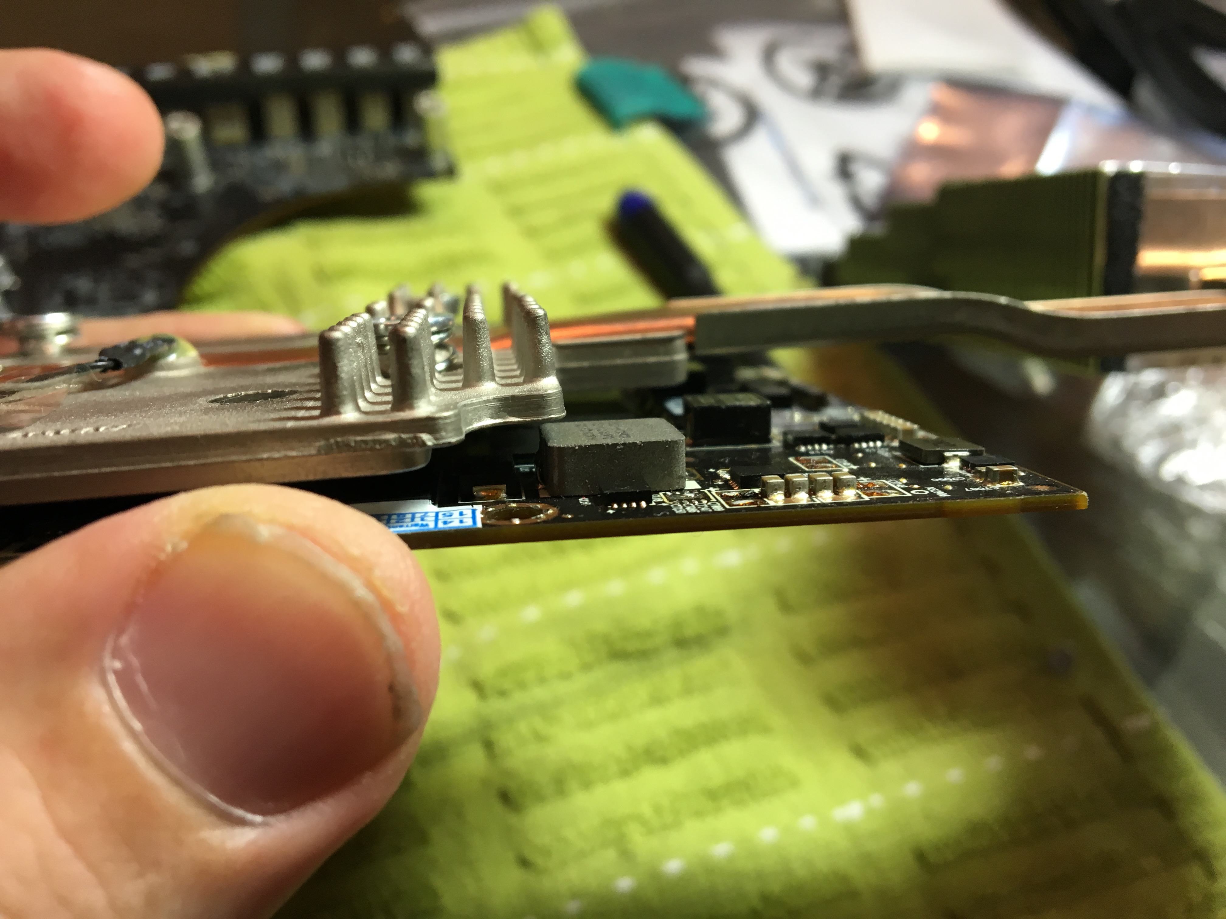

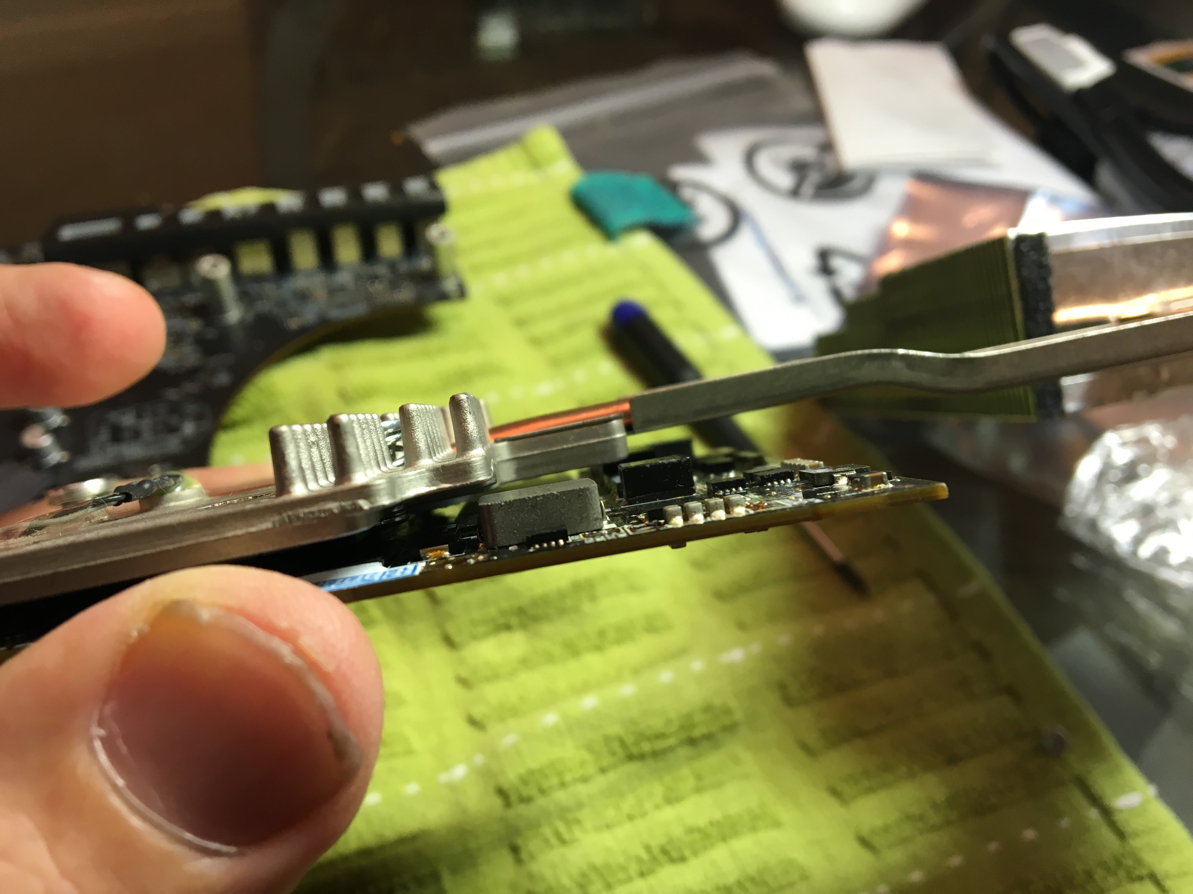

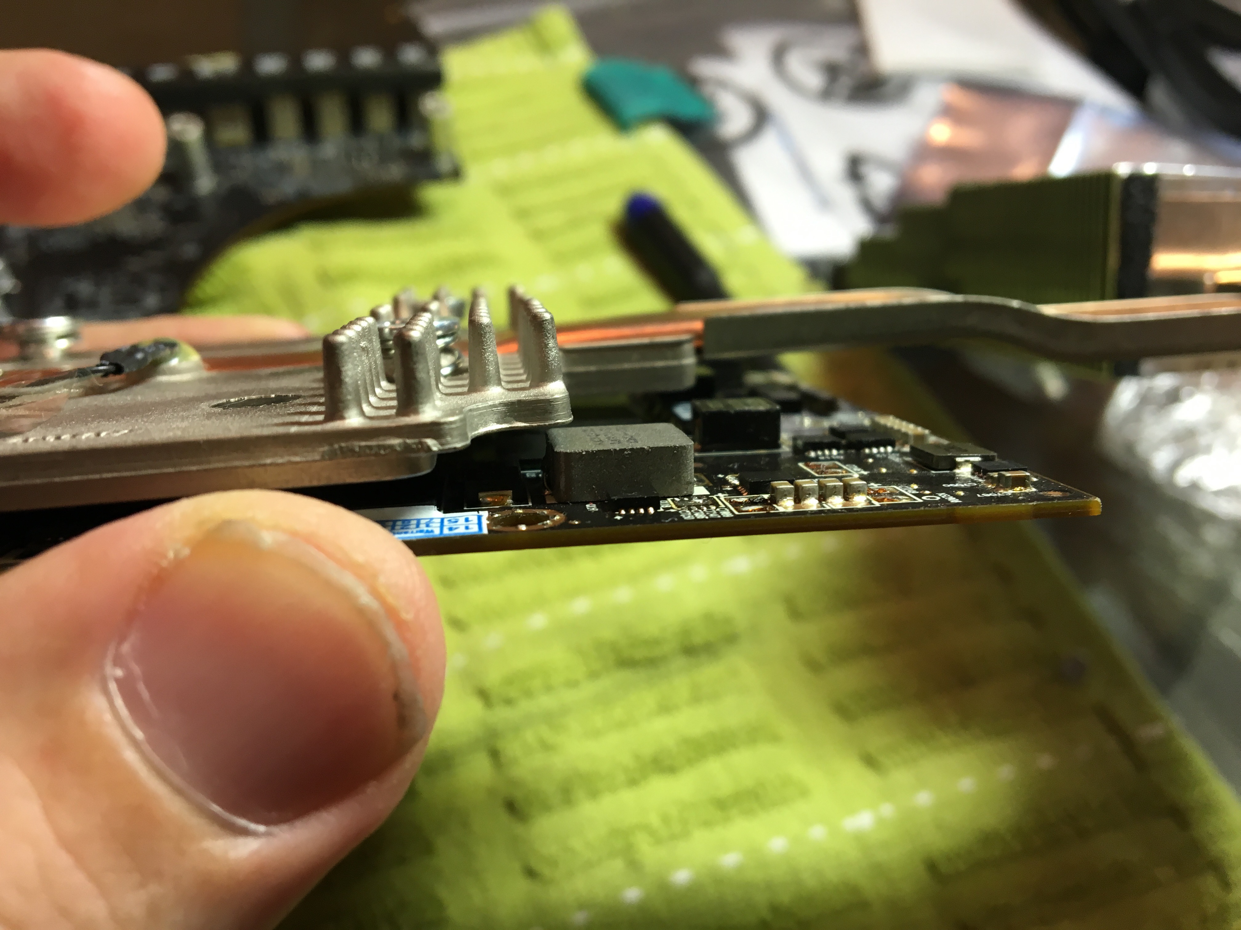

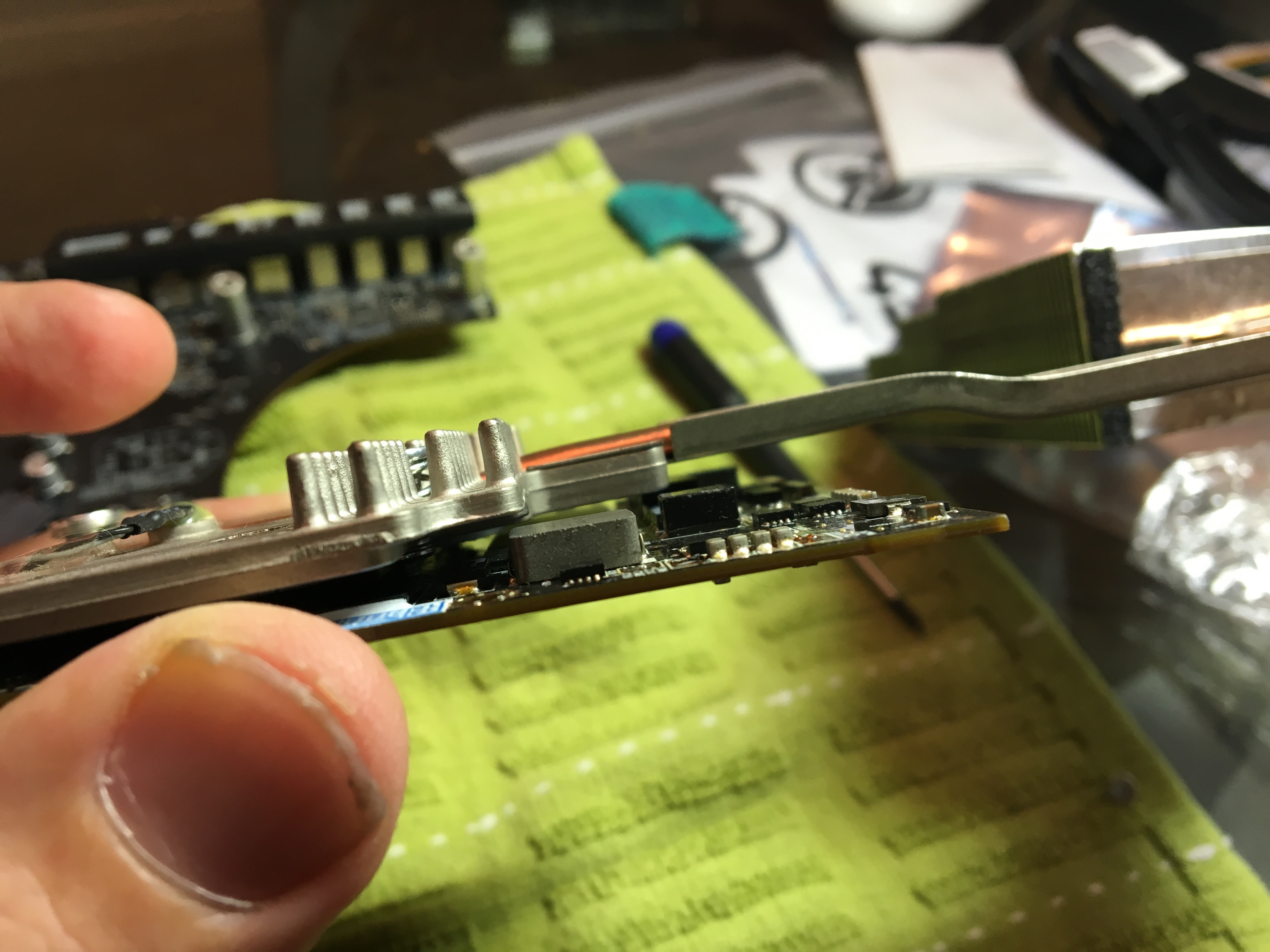

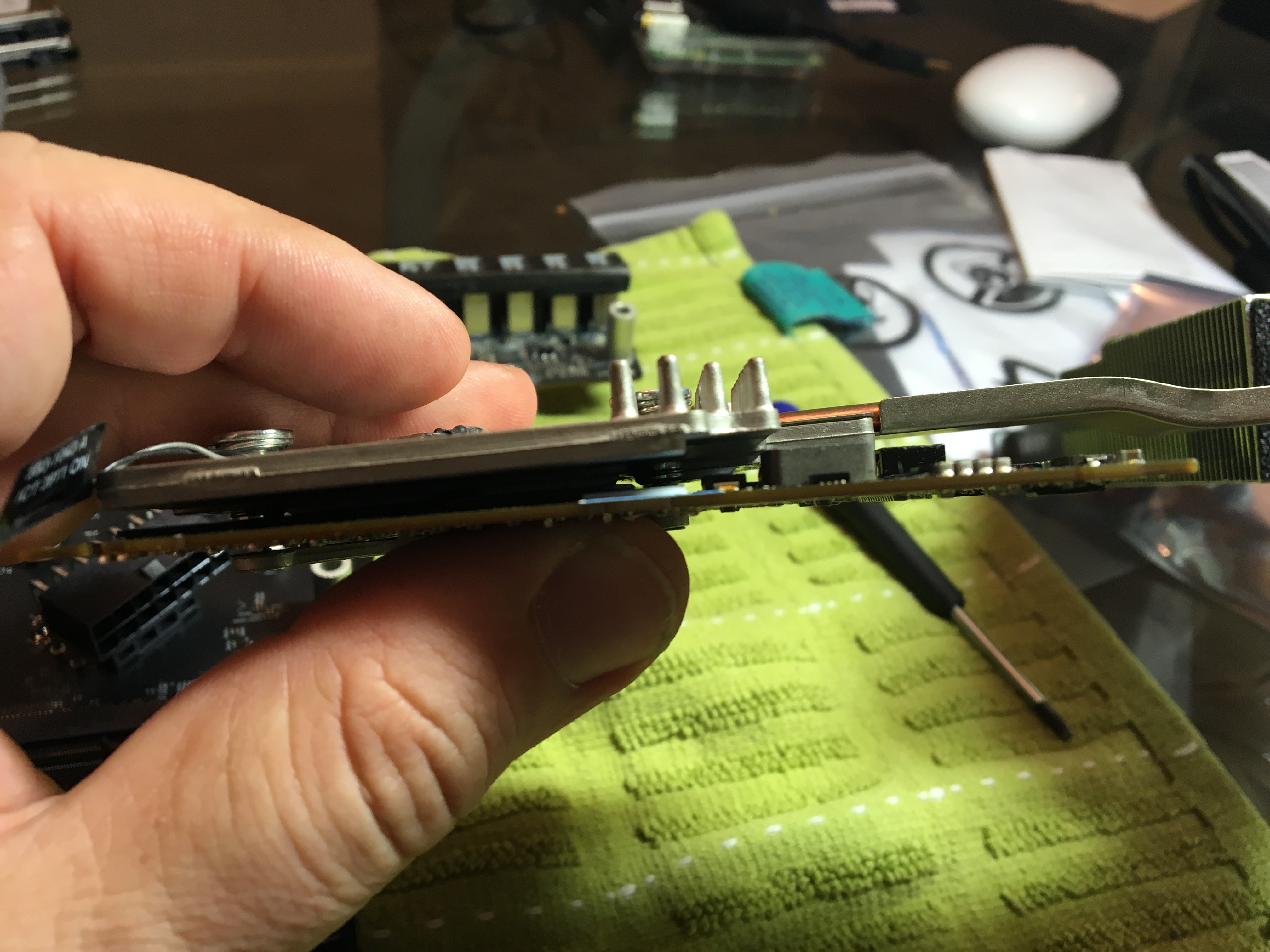

Edit: when I first tried to mount the 6770M heatsink on the 6970M, I ran into problems with how it fit. Specifically, it seemed to hit a capacitor at the top of the board and bend it slightly - plus the RAM wasn't being cooled at all. See pictures.
You not running into that problem, even though your 780M is similarly shaped?
Hi JPamplin
Both TB ports works. External/Dual display can only be use with miniDisplayPort-HDMI cable. I use my other TB port with a TB Docking Station for my other peripherals.
My 780m do operates faster than my previous 6770m and Metal does its job remarkably well. I do feel the performance different especially in Adobe apps, FCPX and gaming also.

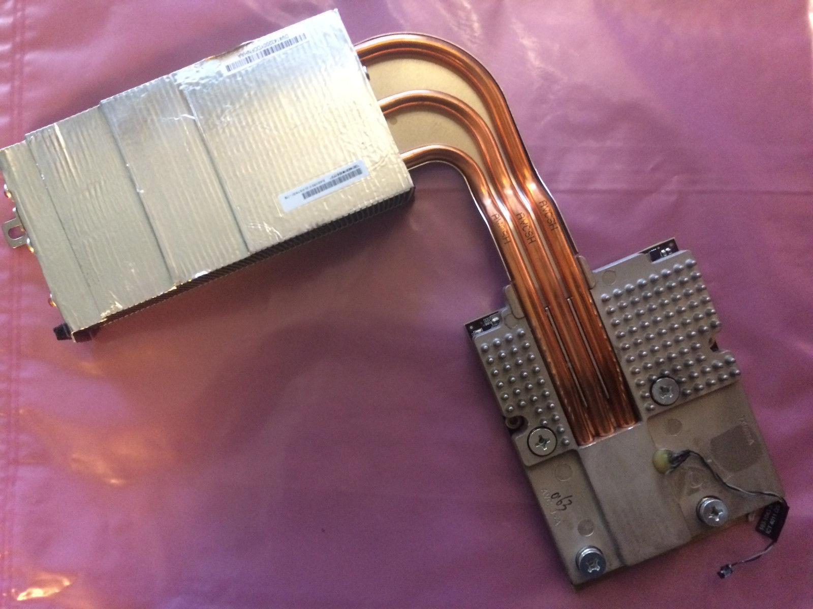

The smaller heatsink fits the MXM card well, no bends needed. You only have to add additional copper shims on the top memory which not covered by the heatsink. I also add some copper shims on the memory behind the MXM.

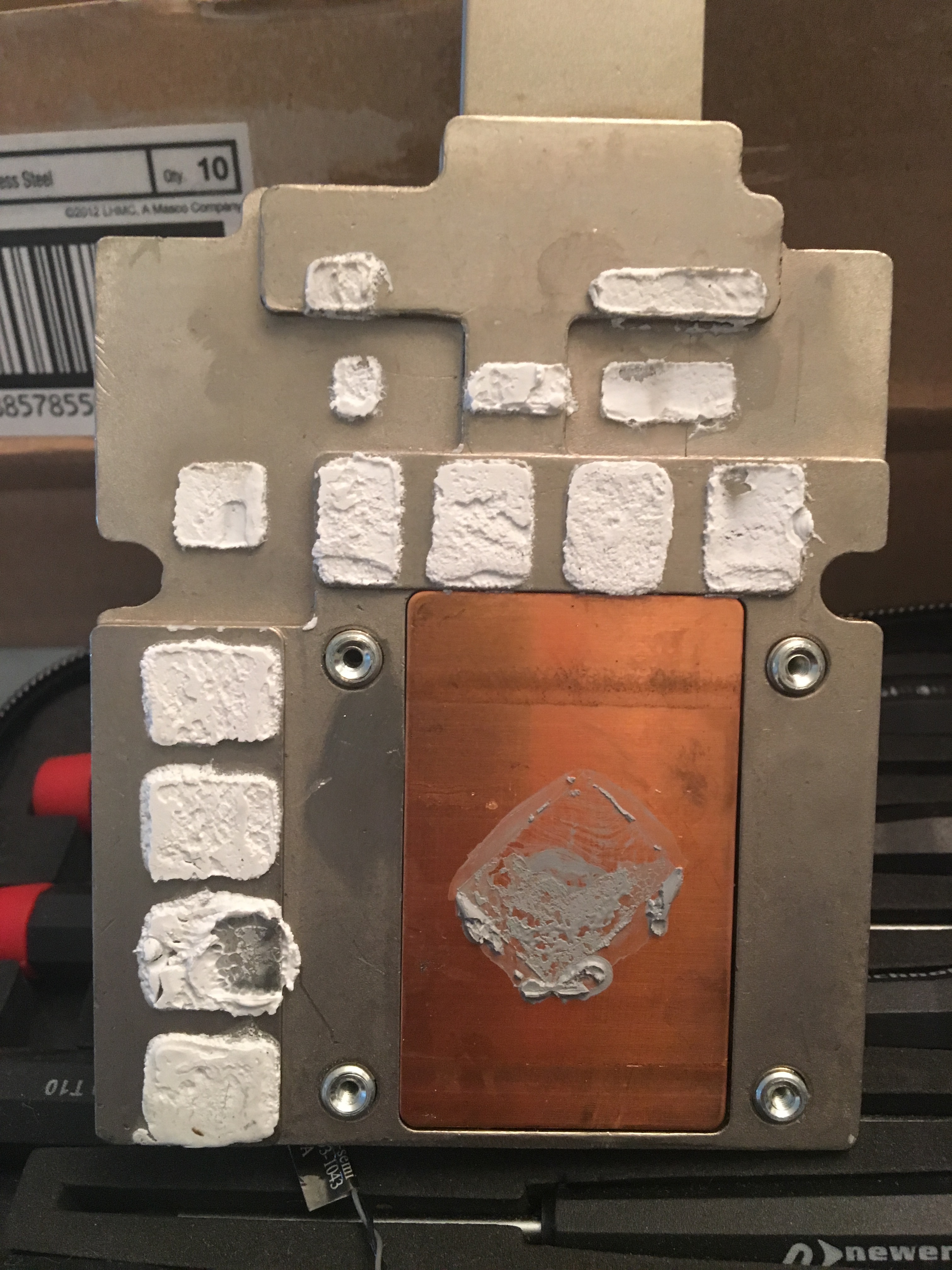

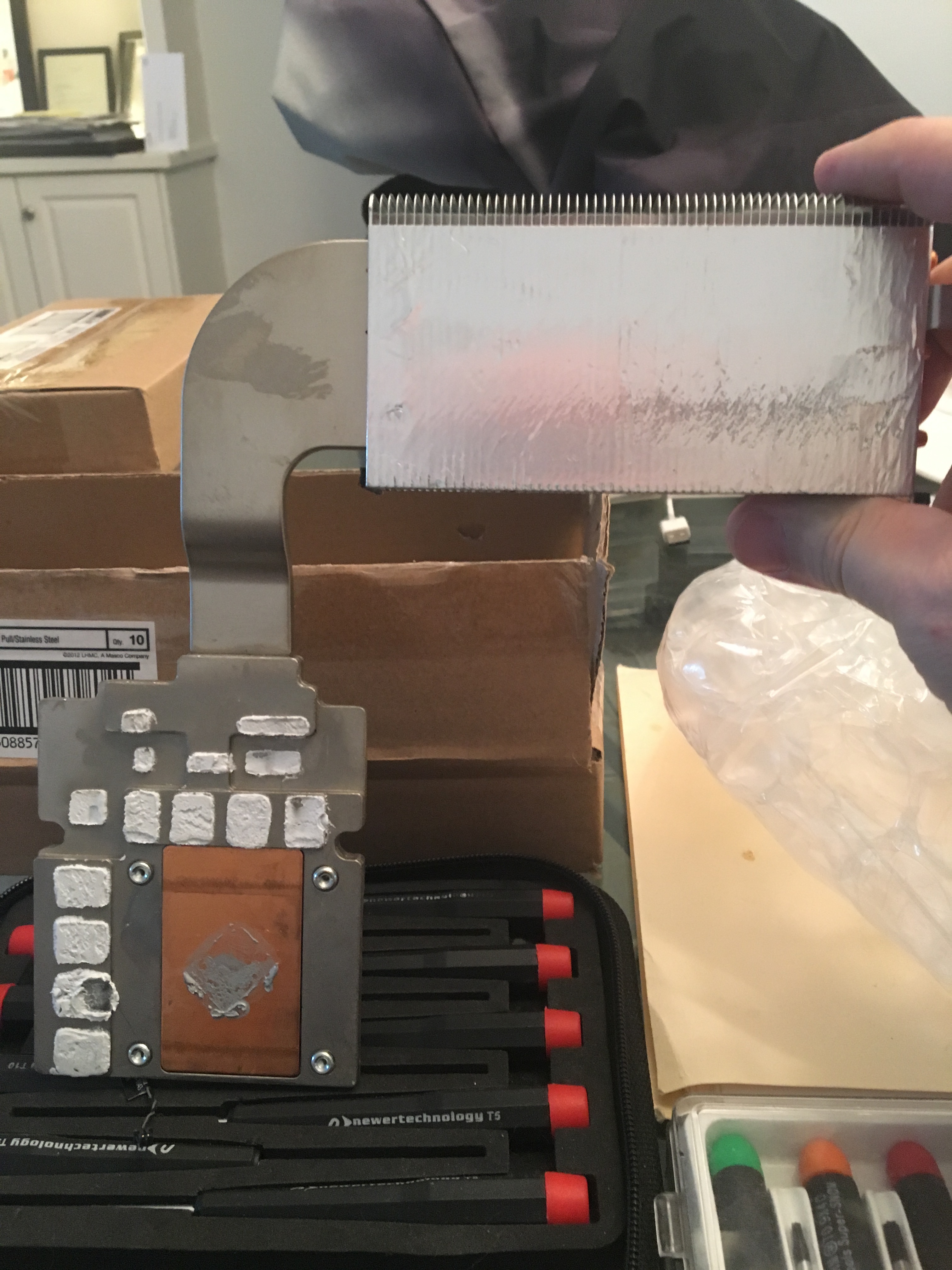

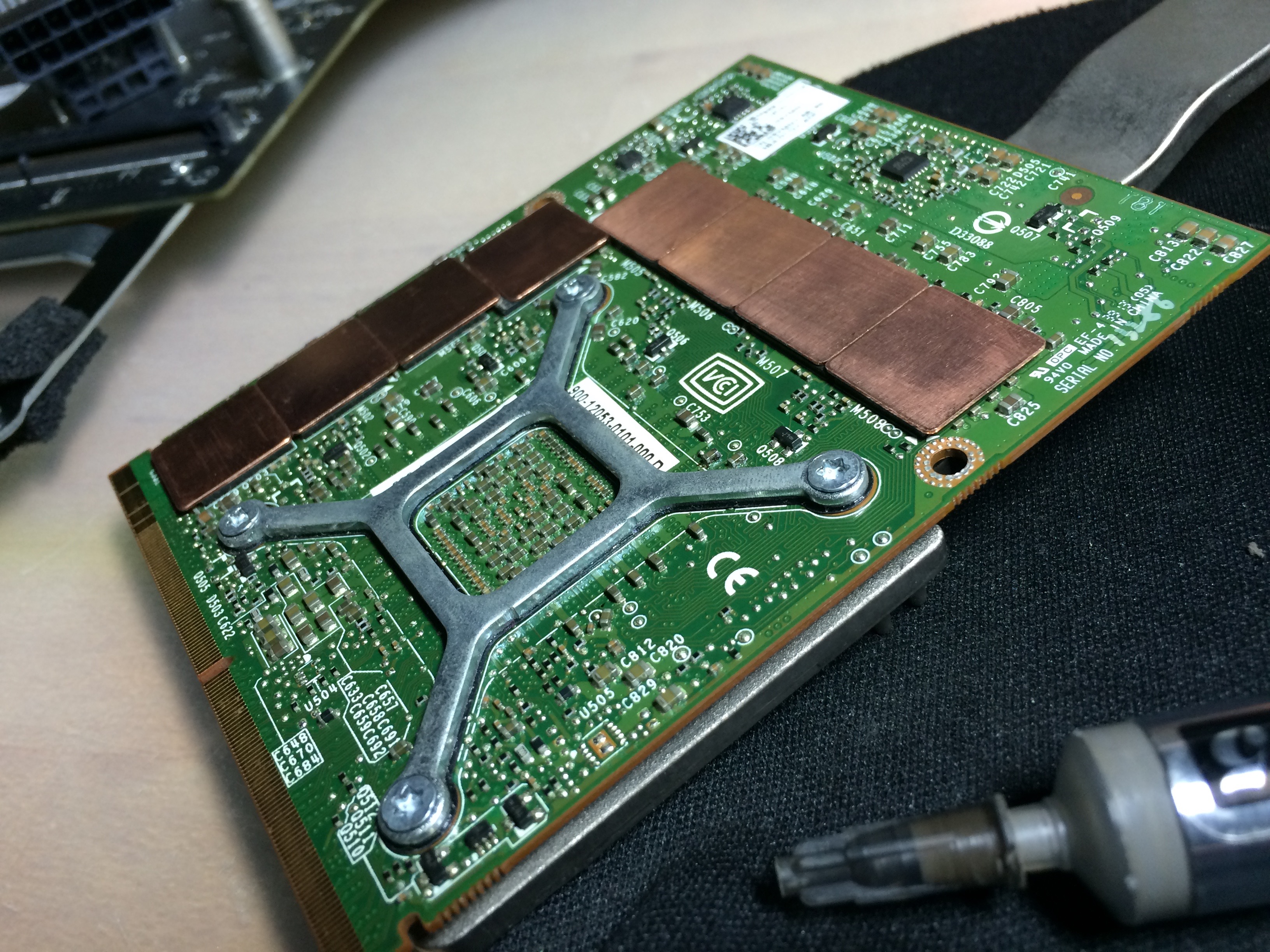

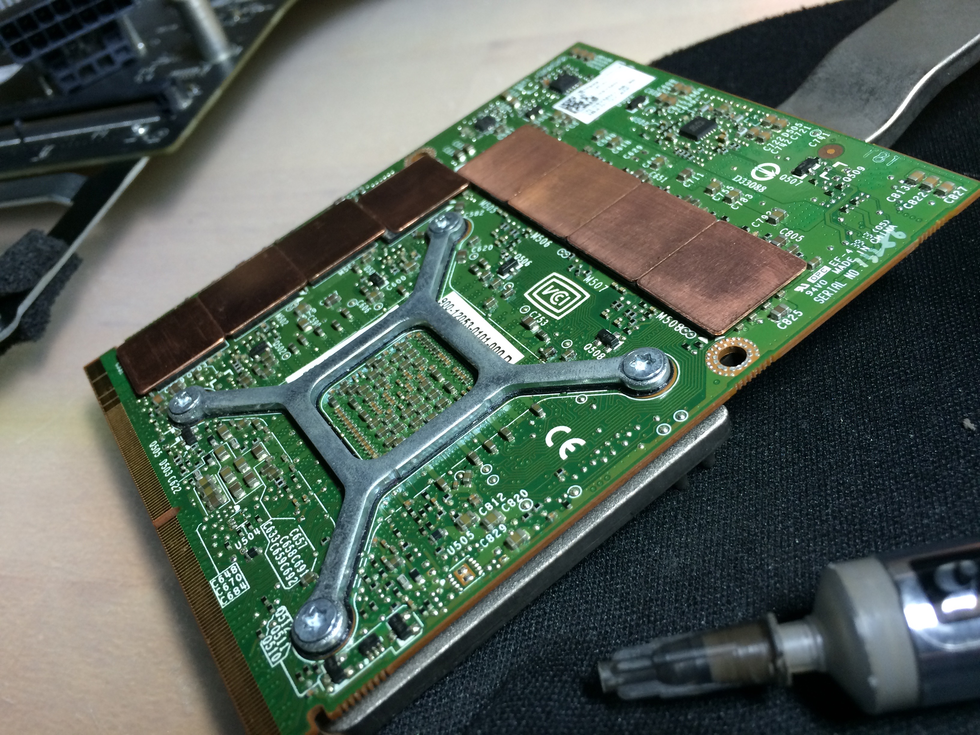

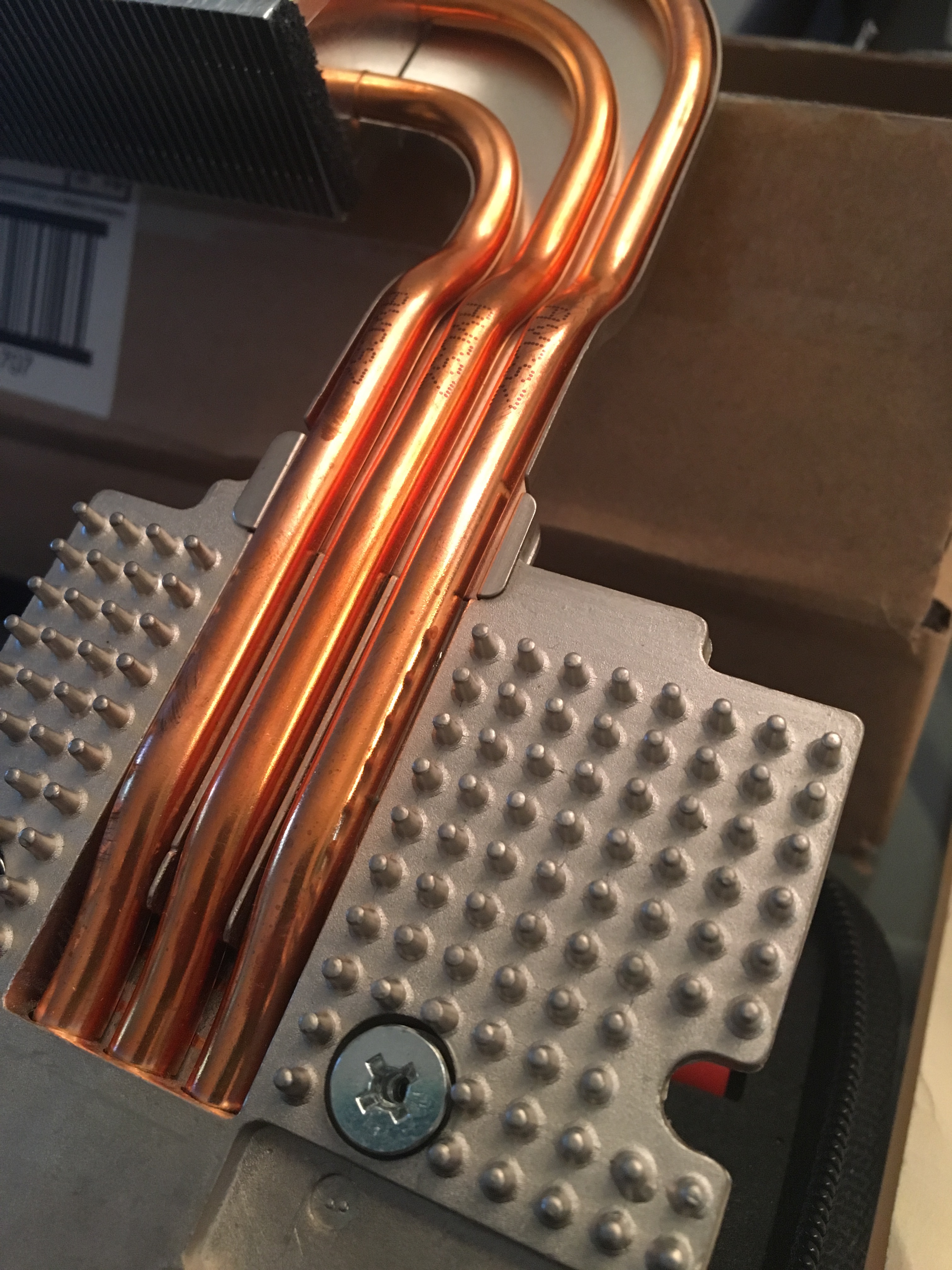

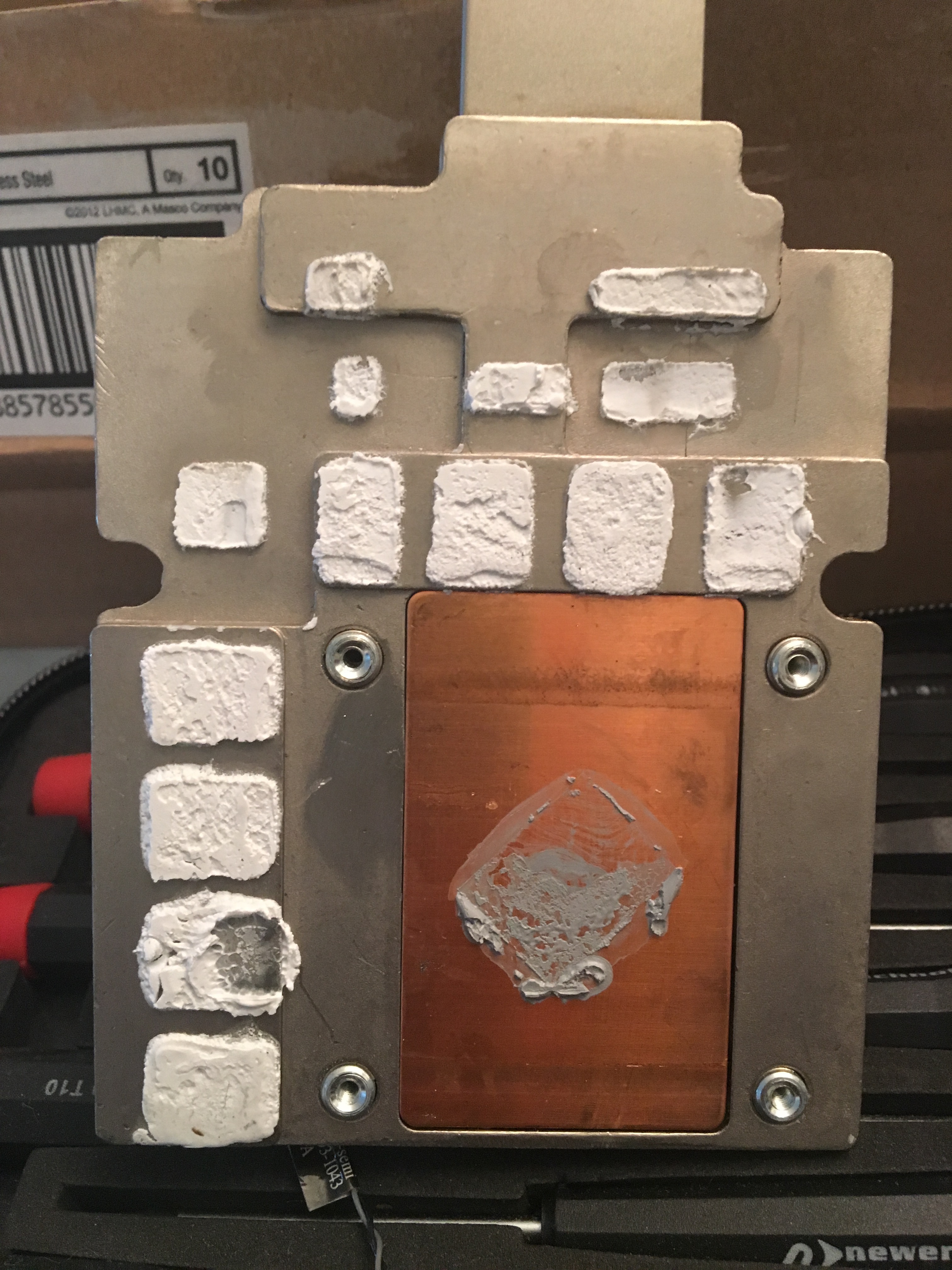

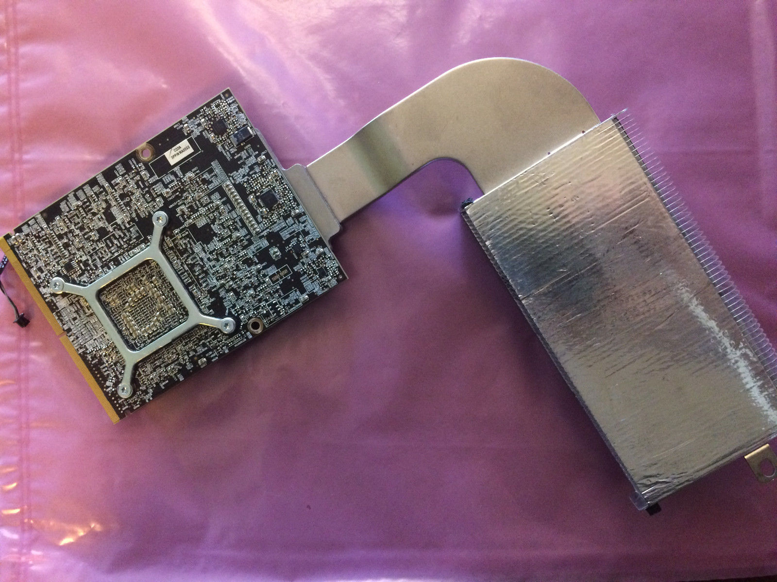

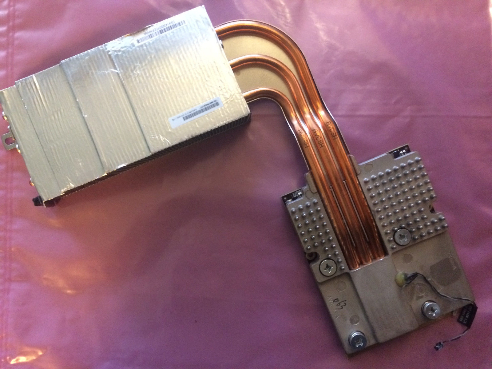

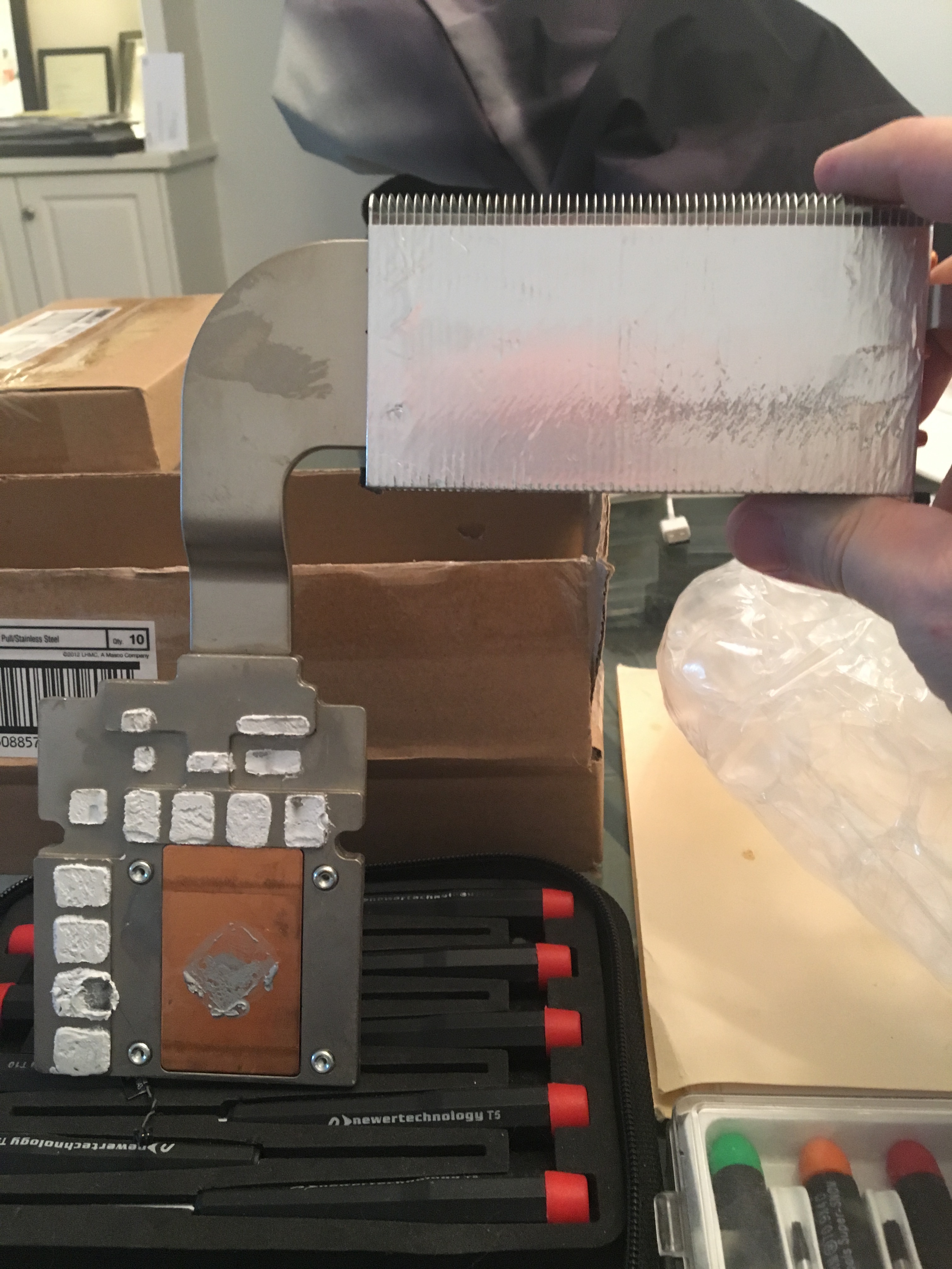

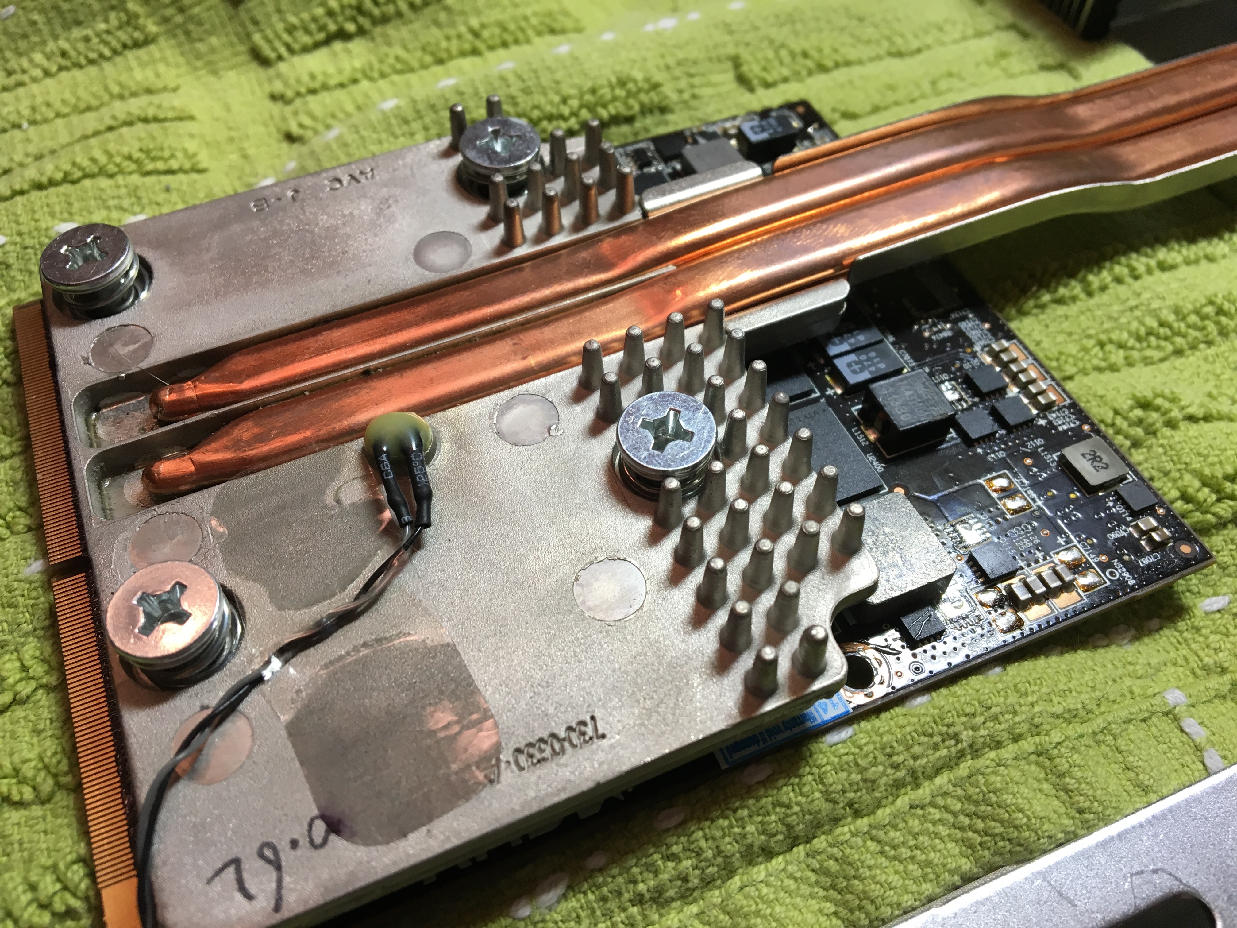

So if anyone wants to install a 6970M or other heavy-duty video card in an iMac, it's important to use the proper heatsink for it. Here are pictures of the 3-pipe heatsink I located on eBay, that is much more substantial than the 2-pipe model that comes with the 6770M.
Note where the thermal pads were located, if you need to reproduce which chips were originally protected with thermal pads on a clean card. I have ordered a sheet of 100 pads for $6 on eBay as well, and will post pictures of the process when I do it.
