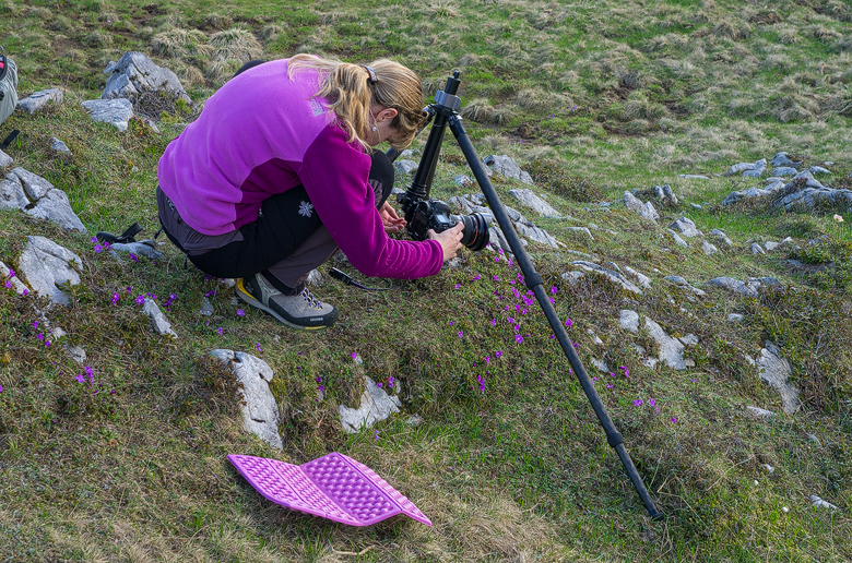

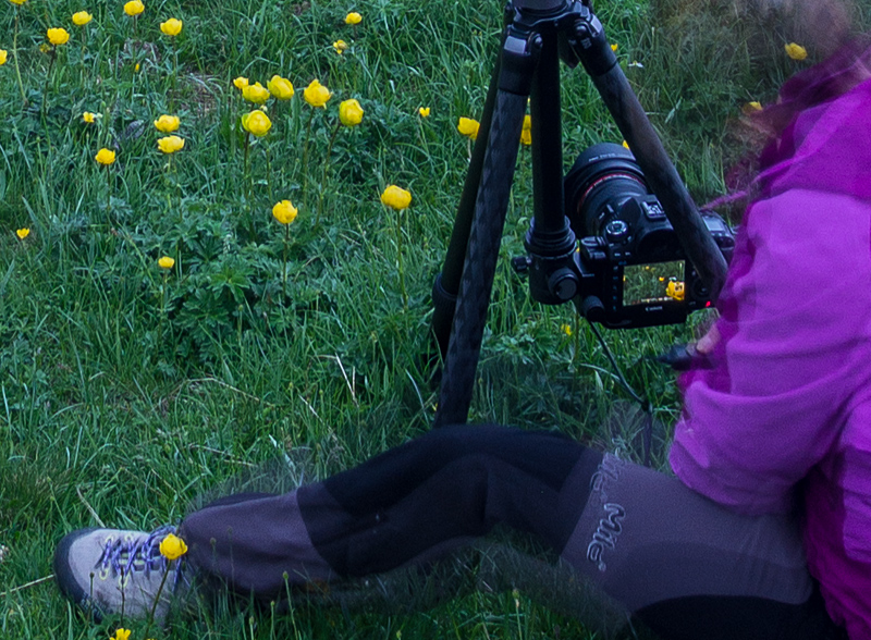

just as a ball head is useless for inverted column shots
Huh? I use a ball head with an inverted column quite often:
^^^ Correction: I use a ball head and an L bracket with an inverted column all the time.
But you can hang the camera upside down.
