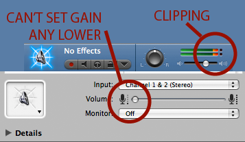

This is something I posted in another forum, but thought it was worth repeating here. I have a CD player plugged directly into my computer with a Y cable. This is purely a line-input for sure. When trying to record in Garageband, you can see from the picture that the levels are too high that they are clipping, but the input volume is all the way down.
Is something wrong with my sound card/driver?

I tried it without the amp. Just a CD player going straight into the computer. No other components, so I know it's a pure line input.
Both the Audio MIDI Setup and System Prefs/Sound/Input volume sliders are linked to Garageband's slider. If you move one, they all move at the same time. And it is not bypassing these sliders. If you move them, you see the level indicators go from just touching the red area, but bouncing back in some green to being fully locked on the red. So the sliders are doing something.

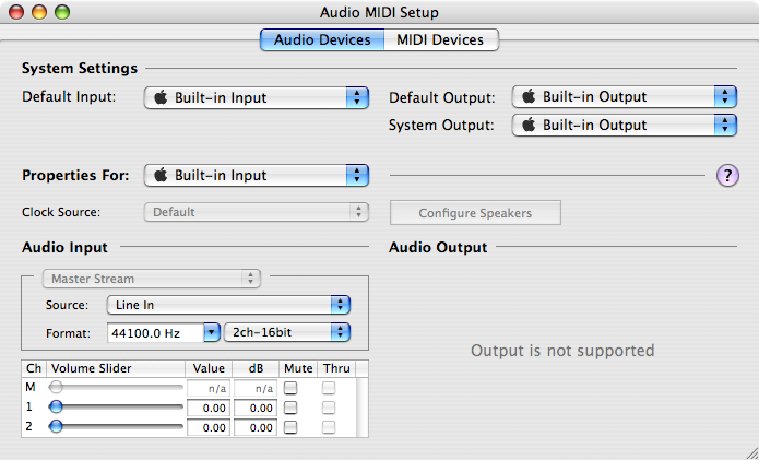

Can you do me a favor? Can you go under Audio MIDI Setup and check your line in settings? See what dB the left-most position reads for you. For me, it says 0dB, but I talked with someone who said the left-most position was -16dB, which would obviously make the input volume a lot less.
