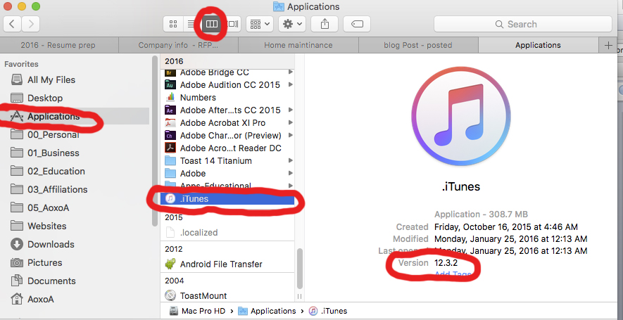

When I installed El Capitan it gave me iTunes 12.3.2. Under the heading “Things You Need” number three is a download link to iTunes 12.3.1 but that was for Yosemite. I don't think it would make a difference but i might have used 12.3.2 when I use pacifist to extract CoreFP.framework for iTunes 12 (Step 5: All About CoreFP.Framework).
I never upgraded iTunes 12.3.2 and still have it hidden, as per instructions, as .iTunes (notice the dot). It is possible you might have gotten iTunes 12.6 with your install of El Capitan. Especially if you ran a bunch of updates before reverting and forgot to omit iTunes updates. If that is the case, maybe you need the CoreFP.framework from iTunes 12.6.
However, I think it shouldn’t matter and it is something else. Still, can you check which iTunes you hid with the dot method? I'd like to know.
To do that, start by setting up Terminal to use show/hide aliases: https://aoxoa.co/show-hidden-files-on-mac-quickly-with-aliases/ It will make life easier for you. After you set your system to show hidden files, highlight the .iTunes and check your version:
(oh, make sure you don’t launch .iTunes when you highlight it. I click the app above it and use the down arrow on the keyboard to highlight .iTunes instead of clicking on it directly).

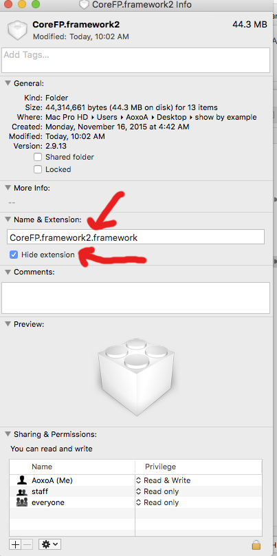

Thing two:
I think your issue has something to do with your problem duplicating the framework files. As you said, "changing the .framework extension to .framework2 broke the file association."
When you duplicate CoreFP.framework it will look like CoreFP copy.framework. When you rename it you need to delete “copy” AND the space in front of it, then add the 2 after framework.
Like this:
CoreFP.framework2
Not like this:
CoreFP .framework2 (notice the space?)
As you can see from the clip above, I have no problem duplicating and renaming the CoreFP.framework file.
If your CoreFP.framework file turns into a folder after renaming it, try this: Right click it and go to “Get Info” > in the “Name & Extension” field you want it to say “CoreFP.framework2.framework” Also, I do have the “Hide Extension” ticked.
Your fix could be as simple as making sure you have the correct CoreFP.frameworks in Privateframeworks folder.

As a test, I switched my coreFP.framework2 with one made from an iTunes 12 that precedes the one I use for the hidden dot. Rebooted and everything still works fine.
Said another way: My .iTunes that is hidden is version 12.3.2---and i used its coreFP.framework (version 2.9.13) to make coreFP.framework2. Then I extracted the coreFP.framework (version 2.9.7) from iTunes 12.3 and used it for coreFP.framework2. Everything still worked and no errors. This leads me to believe that your error is not because you used an earlier iTunes 12 coreFP.
Still, do tell what version your .iTunes is.
And by the way, it is sometimes difficult to find previous iTunes downloads. I have 10.7, 11.4, 12.0.1, 12.1.2, 12.2.1, 12.3, 12.3.1, 12.3.2, 12.4.1 and 12.6.

The .iTunes version that came with my default El Cap install is 12.3.3. Following your instructions, I used 12.3.1 that I was linked to not giving any thought that it was older than what was part of the system. 🙂
So I can just extract the 12.3.3 CoreFP.framework and place it in the appropriate folder?
[doublepost=1493685344][/doublepost]Good news- I was able to duplicate the CoreFP.framework to CoreFP.framework2 without losing the file association this time. I dropped it into the PrivateFrameworks folder, restarted the machine and launched iTunes 10. Still got the error.
I'm a little hazy on step 5. Shouldn't there only one CoreFP.framework in this folder? How can a file with a .framework2 extension be recognized as a valid file? As it stands now, I have a CoreFP.framework from iTunes 10.7 and a CoreFP.framework2 from iTunes 12.3.3 in the PrivateFrameworks folder.
Success! I wiped the system I had and started fresh. No problem with the file rename and no error message when iTunes 10 is first launched! Yaaaayyyy!
