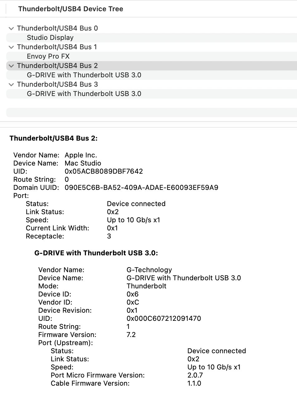

I have two older thunderbolt drives hooked up with Apple adaptors. Never had a problem with either of them:
