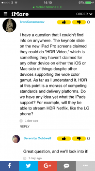

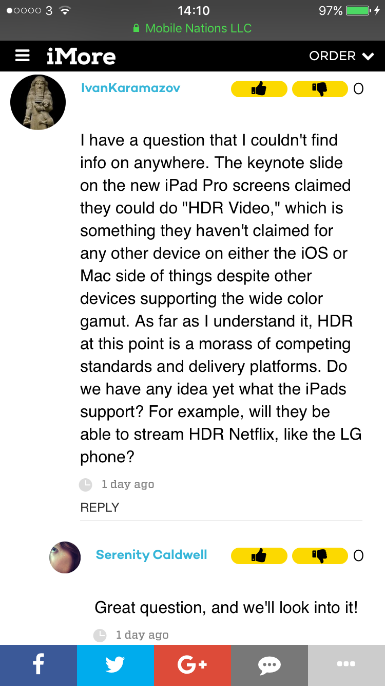

Apple spoke about for a moment at WWDC, but anyone think they actually added true HDR like UHD TVs? I know it's not yet released, but I'm really curious.
I would be incredibly happy if they had true HDR 10 that worked with movies and TV shows, (Netflix originals, Google Movies and TV, and Vudu UHD movies.)
I know many people don't consider HDR a big deal, but being a film student and photographer I am curious if this iPad truly supports HDR. What about anyone else, do you think it's true HDR or just a firmware artificial HDR?

I noticed this too when watching the Keynote. I don't know the answer but I'd assume if they showed HDR on screen that means it'll be the HDR10 format and should hopefully result in being able to watch Netflix and other movies/TV shows in HDR.
