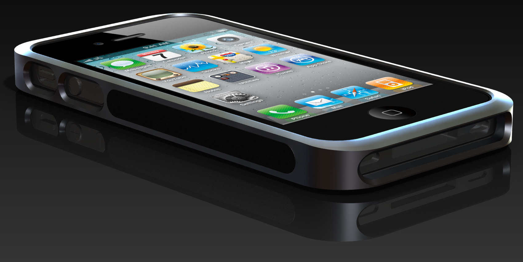

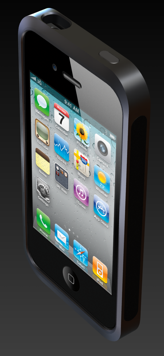

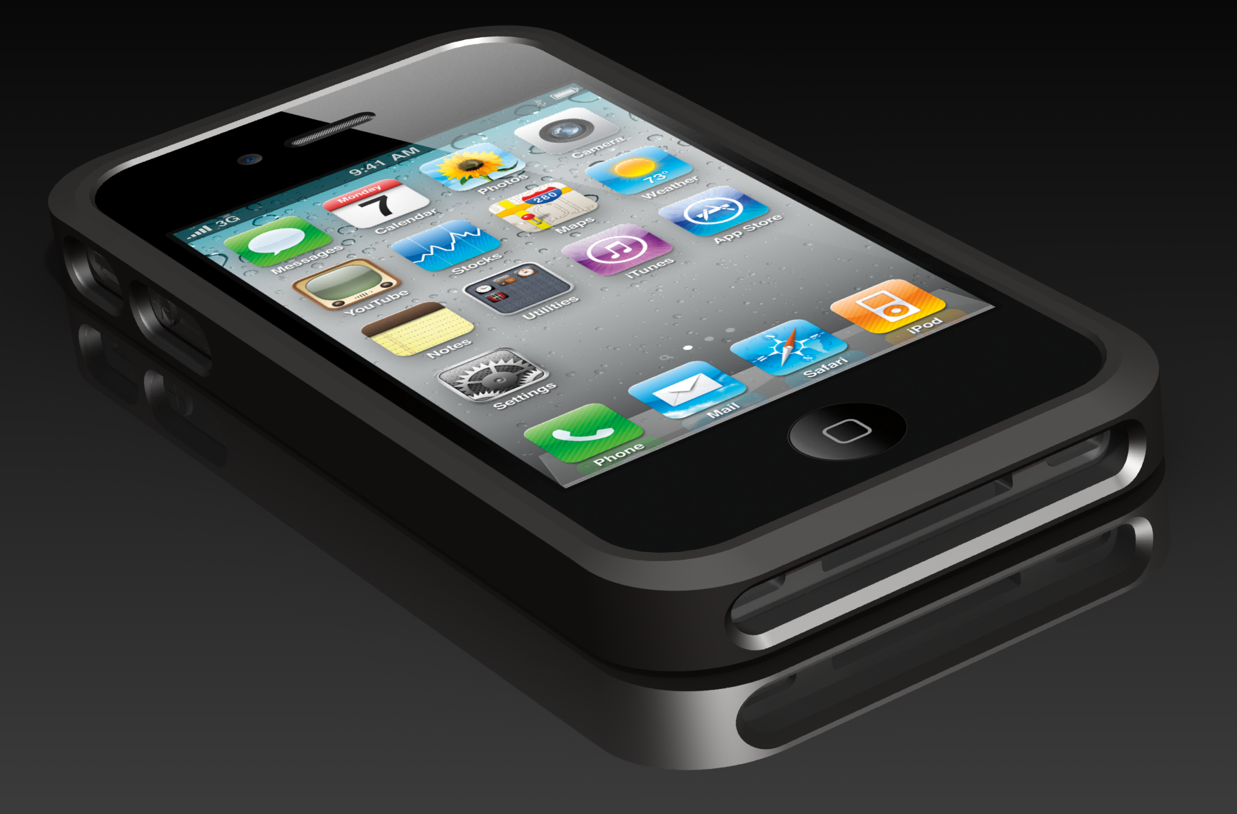

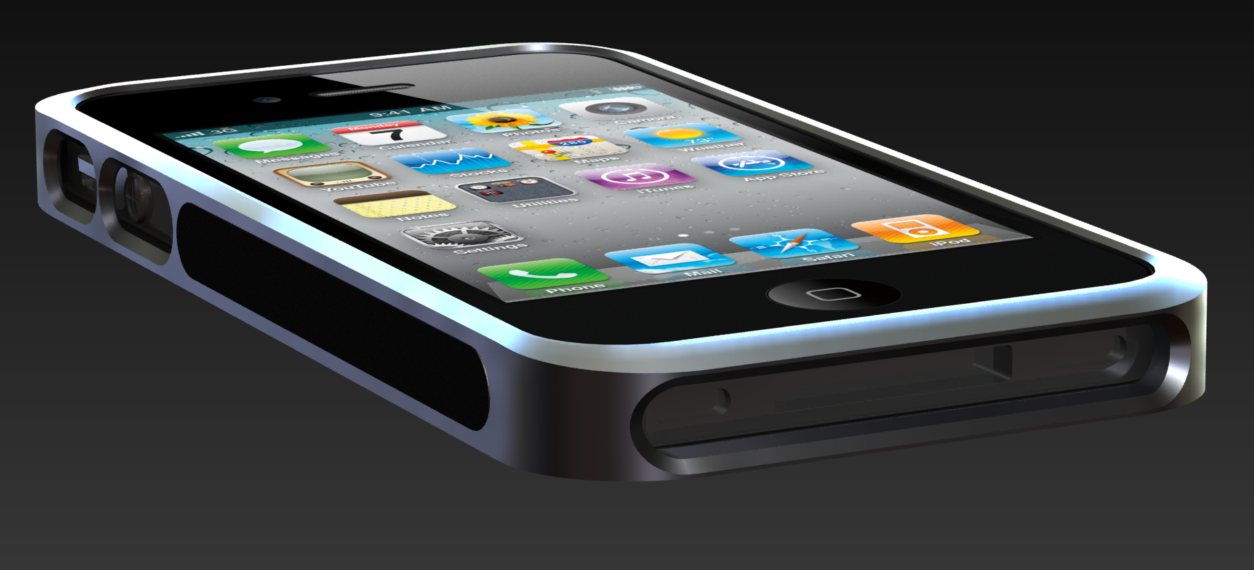

Concept
Just my own rendition of improvements over the Vapor...

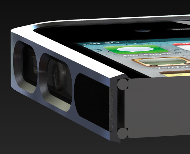

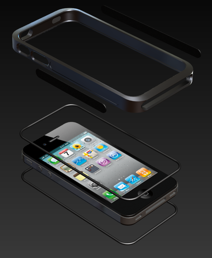

One idea is to have the aluminium case insulated from the phone via silicone o-rings. I've only chosen these due to cost/ease of manufacture/standard part, otherwise I would custom mould a silicone insulator.
The sides of the case would have a slot machined 1mm deep, and 1mm thick silicone rubber would be glued into them for grip, rather than the asymmetrical shape of the Vapor.
To get the thing together:
  1. Place the case on a table face down.
  2. Fit 1st o-ring so that it sits in the very bottom corner of the case, evenly around the whole perimeter.
  3. Place the phone face down into case.
  4. Start pushing 2nd o-ring into the gap between the phone and the case. This gap will be slightly smaller than the o-ring, and will require quite firm pressure on the phone and o-ring to fit.
It would be quite difficult to remove the case using this design, and would likely require damage to the o-ring to remove. However, the advantage is that there are no joins or screws. The tolerances of the case in this area would be rather critical, depending on the hardness of the o-rings. Softer o-ring material may provide easier installation and better shock absorption.
