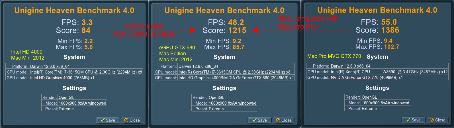

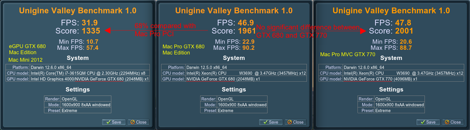

Not so much experimental as less practical, though I have seen reports of using even a 2011 Mini (also with TB1) with an eGPU getting 40-50 FPS -- sometimes even 60 -- on decent settings with a midrange card like a GTX 970, RX480, or GTX 1050 Ti. At those rates, even the 10Gbps limit on TB1 doesn't come into play. It's not likely cost effective for someone wanting, say, 60 fps @ 1080p on high settings (and something like a GTX 1080 would likely be wasted on a machine with only a TB1 connection), but it could make unplayable games playable on medium to medium-high settings with 30+ FPS at 1080p, especially on a Mini like mine, a 2.6 GHz quad i7. (I consider 30 FPS to be the bare minimum of "playable".)

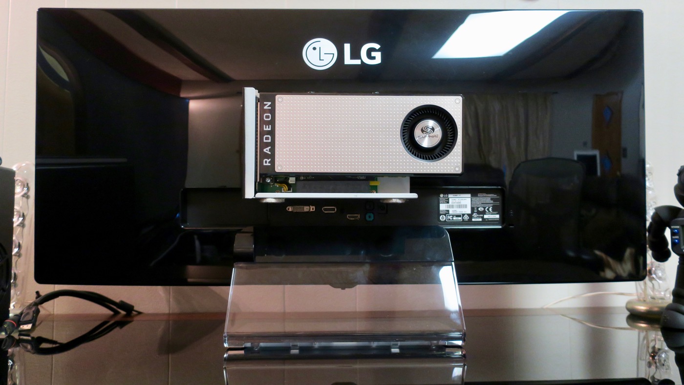

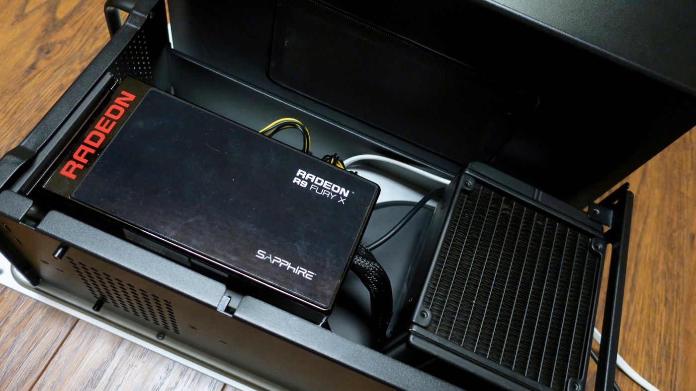

eGPU is totally worth it. The best feature is upgradability. If you have a Thunderbolt 3 enclosure, you can use it with a TB3 Mac mini when it comes out.

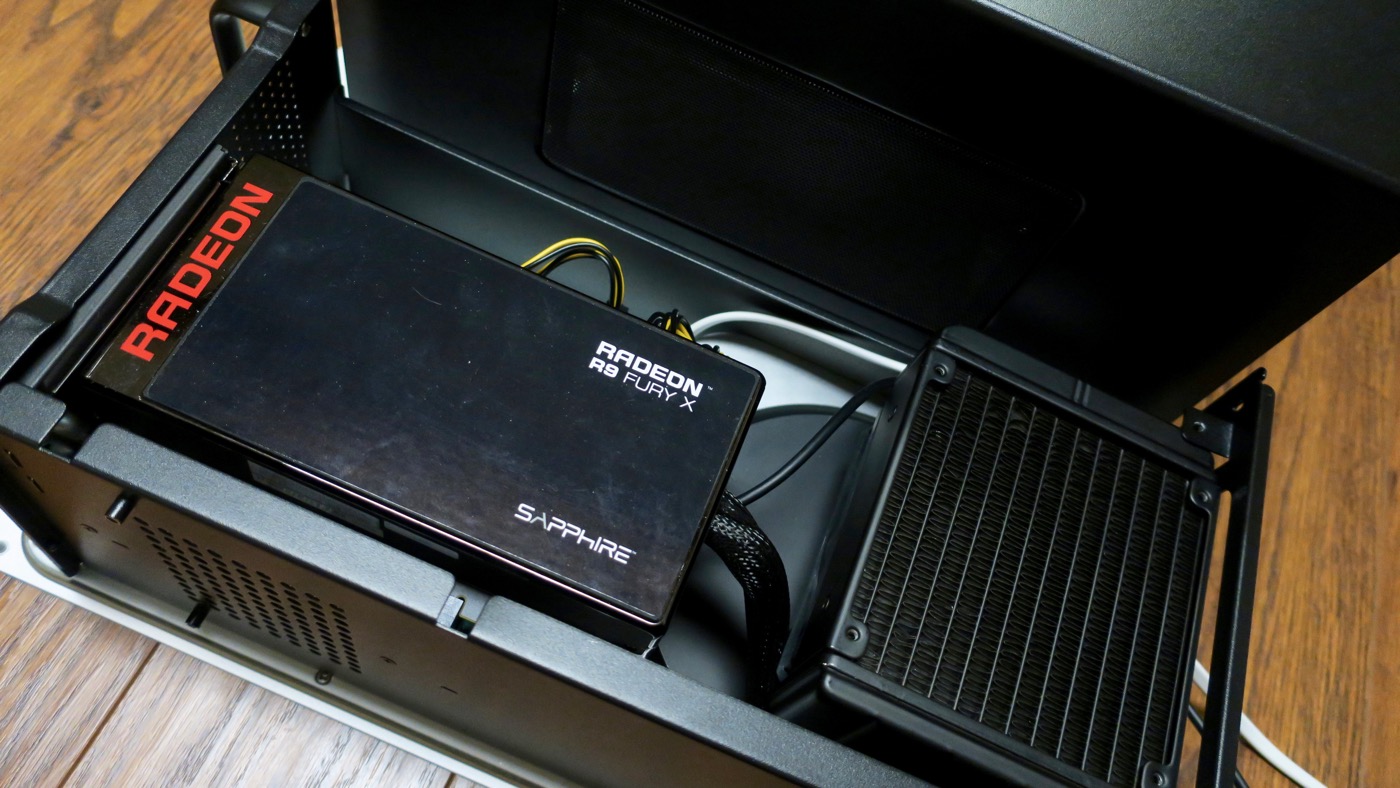

As @Synchro3 mentioned, the performance loss via 1st generation Thunderbolt is not as significant as you might think. You can get creative with placement of the Mac mini and eGPU enclosure. I've shoved the Mac mini inside the AKiTiO Node in one build. Smaller eGPU enclosures can be mounted behind a display.
With High Sierra, 10.13 it's much easier to make use of eGPU. It's almost plug-and-play.
mac-mini-akitio-node-r9-fury-x-mounted.jpg akitio-thunder2-rx-470-monitor-built-in-egpu.jpg

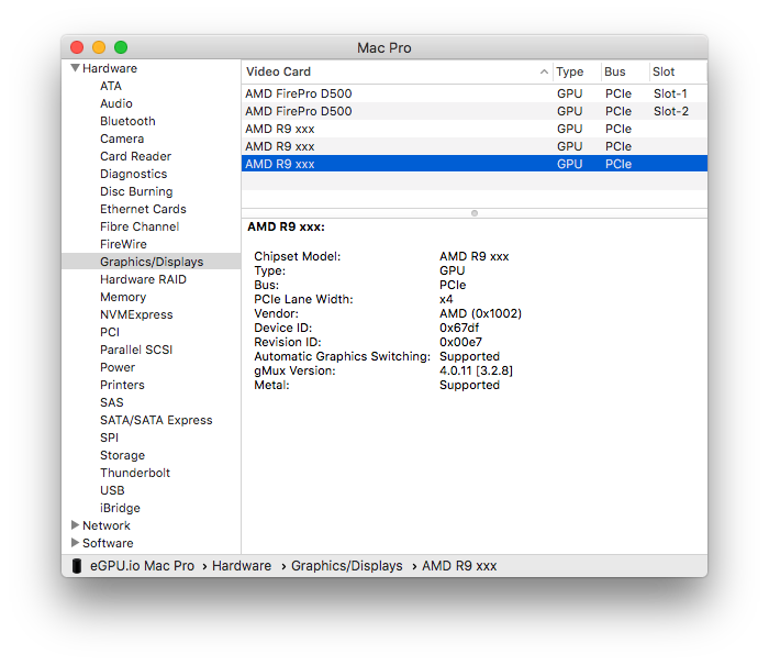

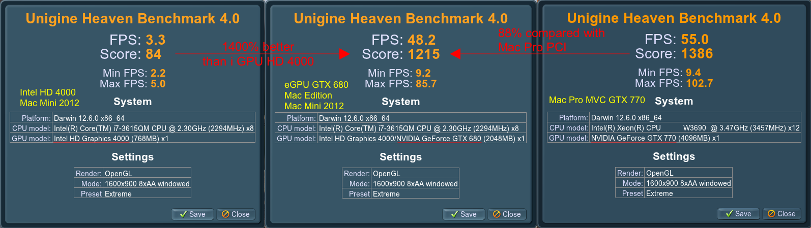

It is very exciting to be able to use an eGPU with the Mac mini. Even the nMP sees performance boost with the addition of an eGPU. Here's my experience with the RX 580 and Sonnet Breakaway Box a couple months ago (before Apple's announcement at WWDC using the same components for its Dev Kit).
Perhaps impractical but the 2014 Mac mini would possibly be able to use a pair of Thunderbolt eGPUs with its 2 Thunderbolt 2 ports. I've tried 3x eGPUs successfully with the nMP.
